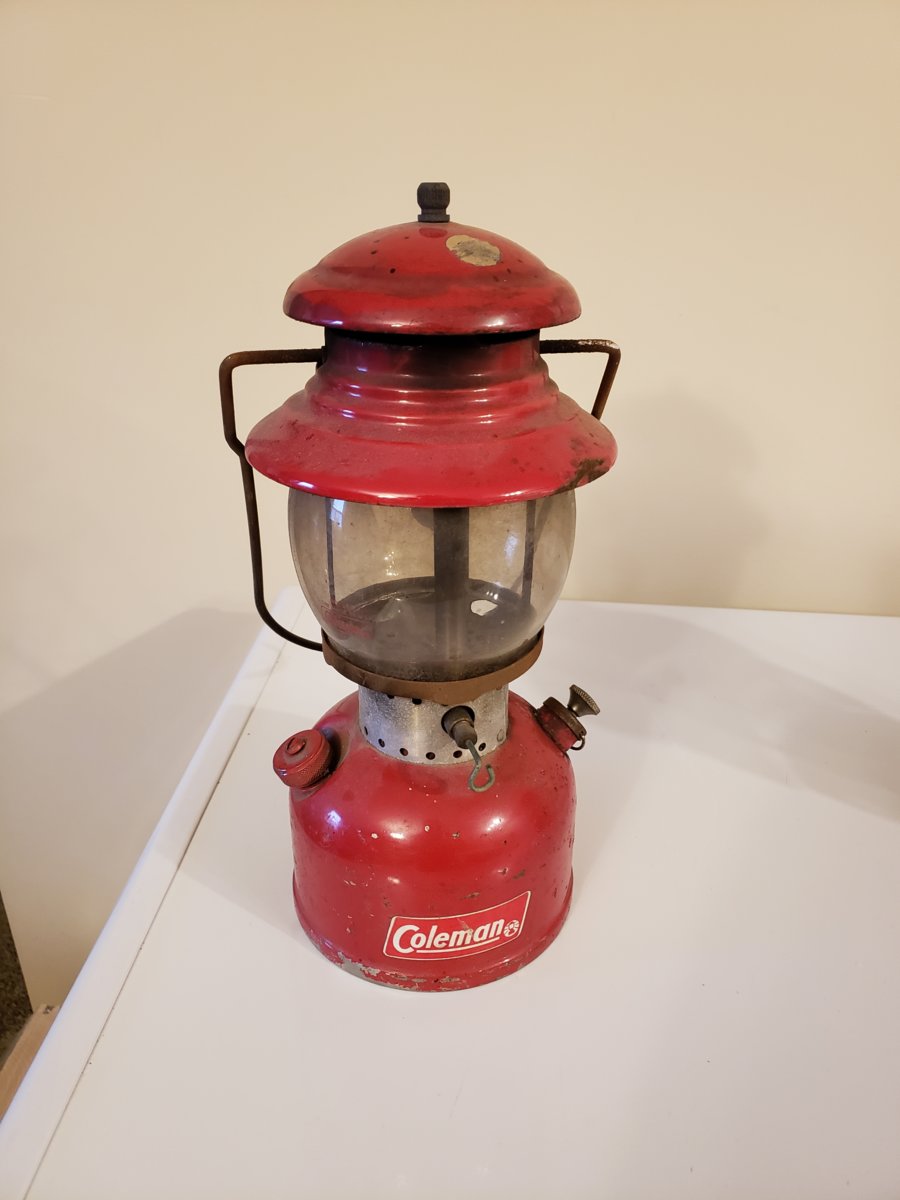

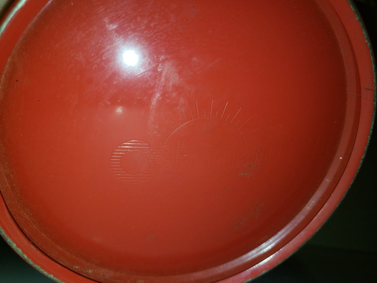

    Hi everyone, new to the forum. Bought a 200 series 1/65 at a yard sale for C$10. It is pretty dirty, but had a complete mantle and some old fuel left in the tank. I don't know when it was last run or how old the fuel is, but the leather cup was pretty dry. I put some 3-in-1 oil on it and down the tube, pumped it up and took it outside. It was quite windy so it was lots of fun to light it with a match. But it is the first time lighting a liquid fuel lantern and I'm so happy it worked! Here are the action shots I took!
    What is the best way to clean a lantern body and the glass globe without it breaking?
    7,000
    Welcome, @Johnathan.
    You lantern is looking good!
    You can clean the glass in the dishwasher, or with warm water and detergent by hand.
    The rest of the lantern can be cleaned with a cloth and detergent, or with a car cleaner product.
    Don't use anything harsh on the label, or soak it.

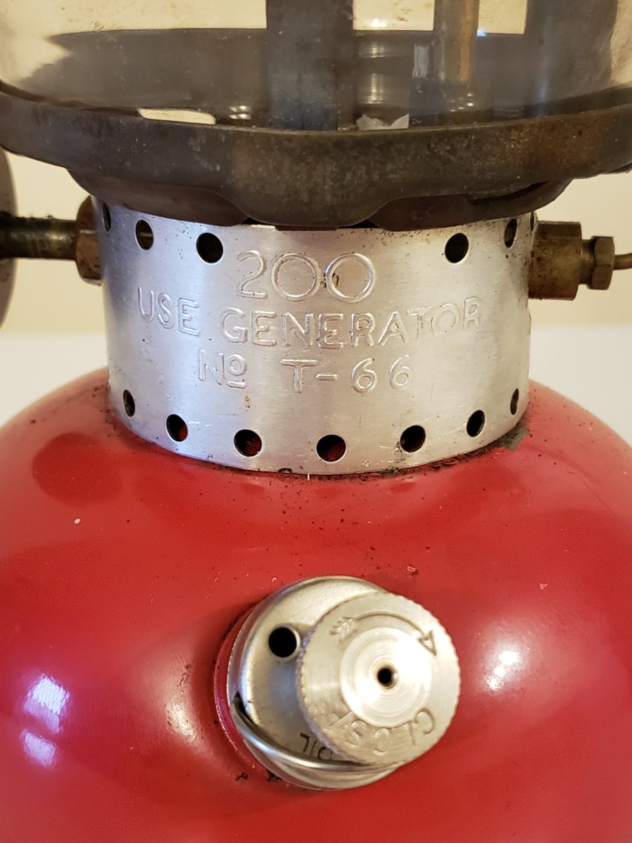

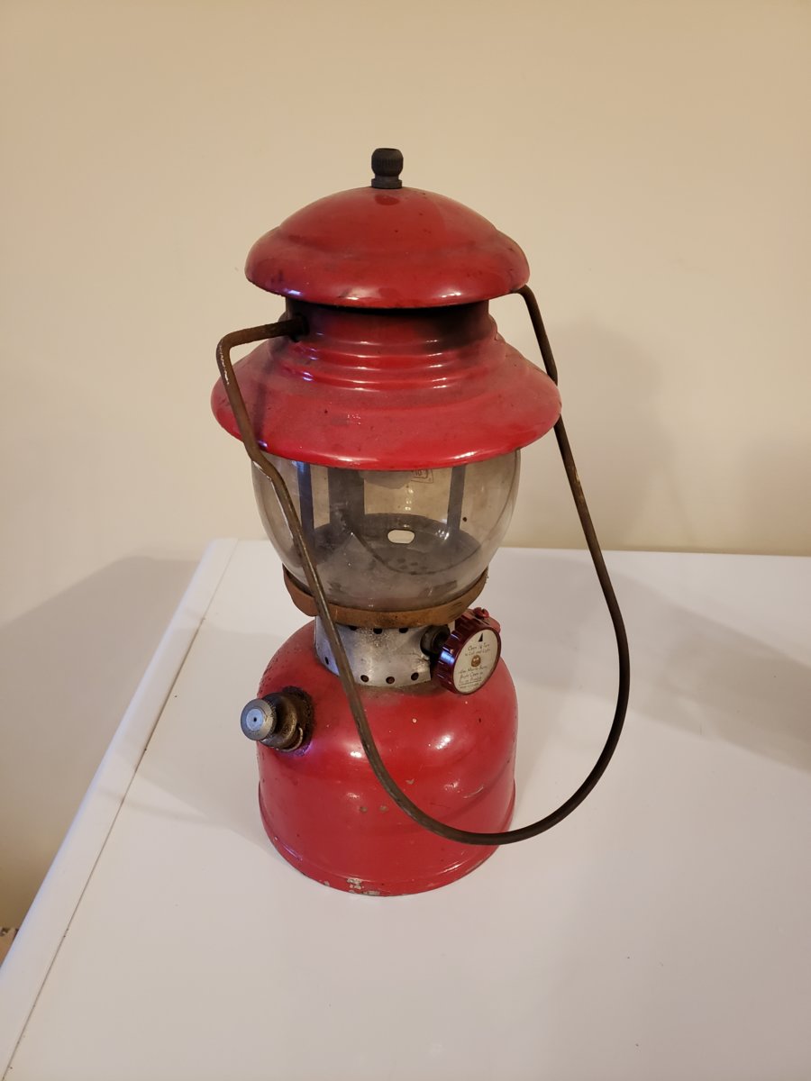

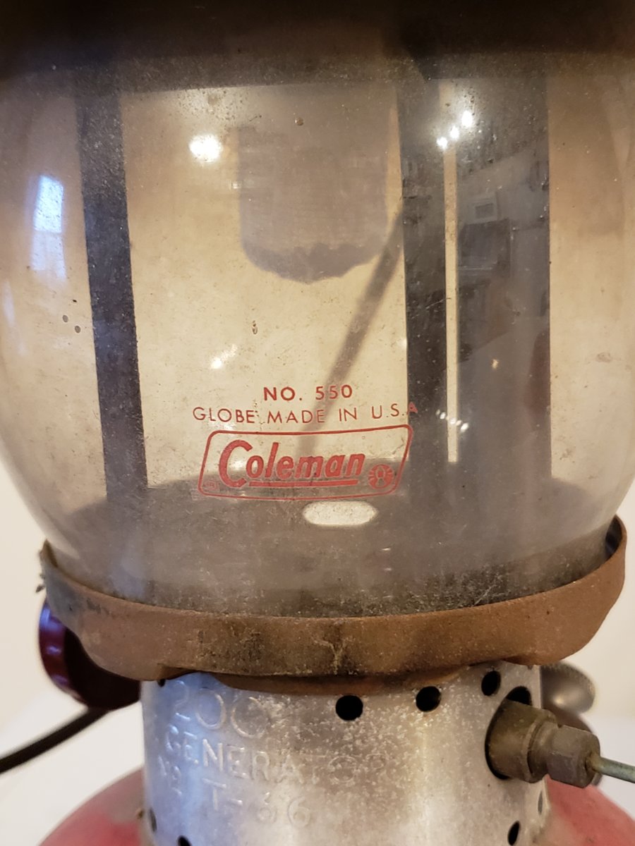

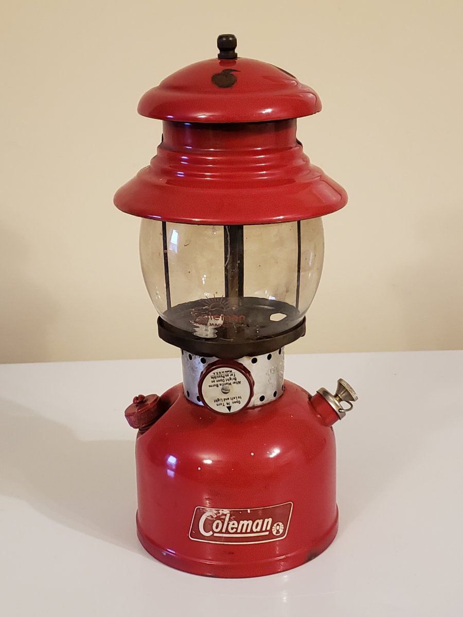

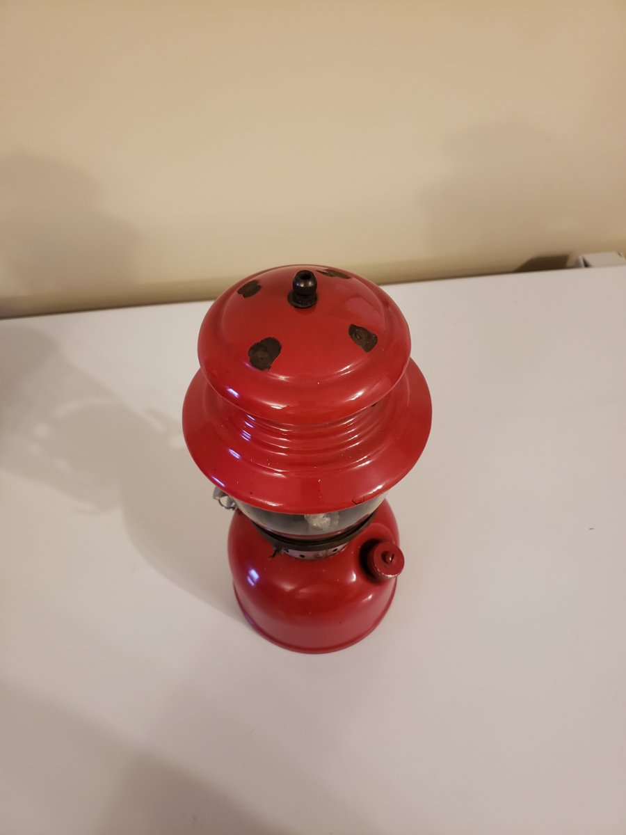

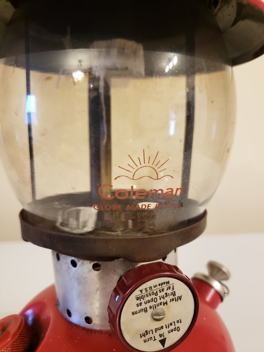

    Here are some more pictures I took and some of my other 200 series from 12/67. Need to get a new mantle for it. What number mantle do these 200 series use? Is there a way to fix the bare paint on the top of the second lantern, what would cause this? Oh, I also do have a handle coming for it!
    20190724_202154.jpg 20190724_202207.jpg 20190724_202216.jpg 20190724_202235.jpg 20190724_202247.jpg 20190724_202259.jpg 20190724_202318.jpg 20190724_202327.jpg 20190724_202342.jpg
    7,000
    The bare patch on the vent (hood) is where the enamel has chipped off due to heat, water, and use. I have tried, and failed to find a paint that will withstand the heat that these vents get to when burning. You will just have to get to love its 'patina', find or find a new vent.

    Can anyone tell me what the best way is to get the part the globe sits on shinny again? I was thinking of maybe taking a small wire wheel to the entire assembly and they spray it with a high temp aluminum colour header paint....
  11. ROBBO55
    2,273
  12. Johnathan Canada
    Jul 13, 2019
    30
    Stony Plain, Alberta
    Those look really good and I think ya, that will end up working for what I want to do. Remove the rust, paint with a rust primer and then paint with a nice high temp paint. Want to make these last at least the rest of my lifetime!
