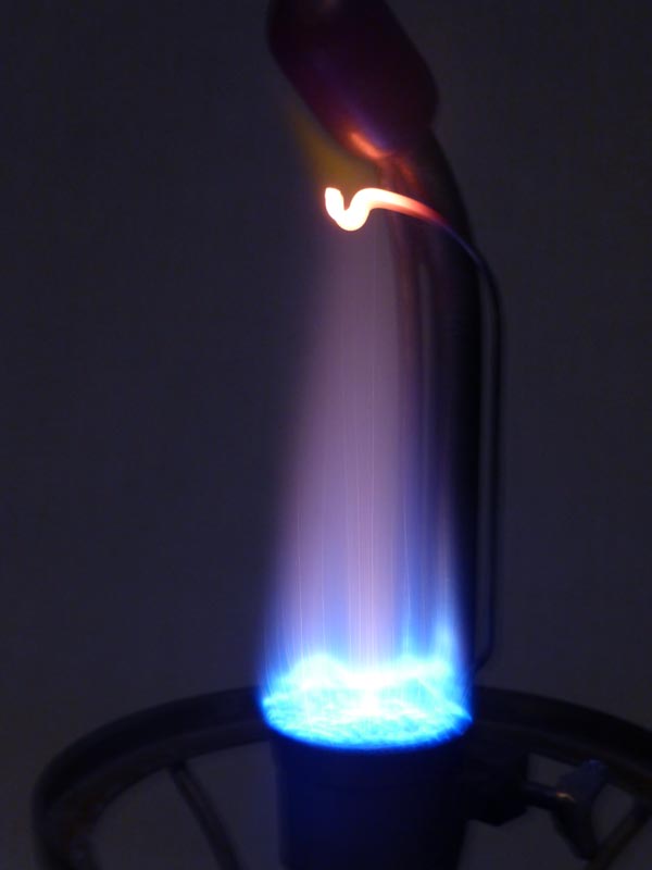

    I used a 0,25 mm needle for the jet orifice and it just made it, so I think it might be the same as on the Lux burner. In the image with the unlit mantle I used a E&G wick burner mantle.
    Too short and a bit too wide. In the lighting try I used a 500 CP soft mantle and put that on a upper ceramic holder from an Aladdin upright gas mantle.
    It shrank too much and was too slim to pass over the flame spreader but I used only low pressure and it worked okay for a "money shot" anyway.
    Probably one can use 800 CP soft mantles to fit?

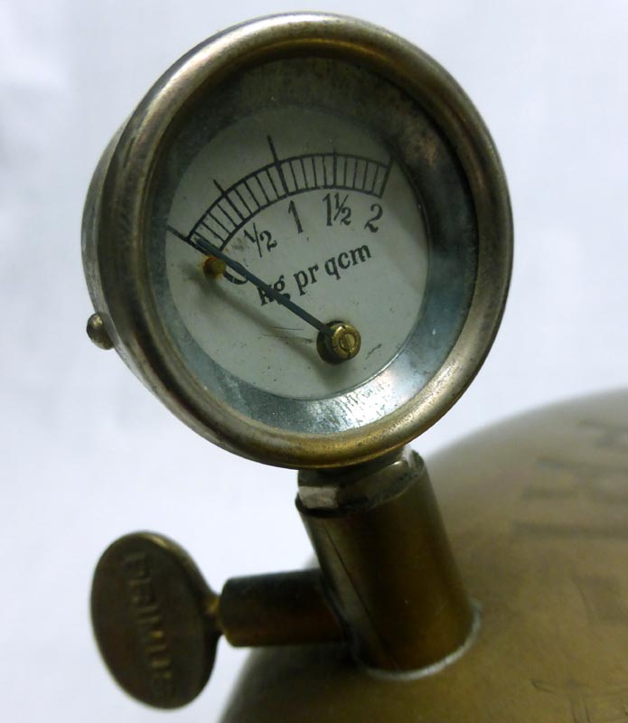

    The pressure used in the Bunsen image was just above 0,5 kg/cm2, and below that when using the mantle. My experience with the Lux DH burner is also that you only need pretty low pressure to get it going.

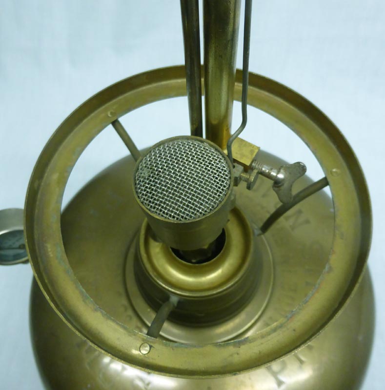

    ....Do you have to use an external pump to add pressure?.... Also the small elliptical object hovering above the mantle/burner area, I am assuming that is the generator?.. If so then what might it look like in there and how does it mix and work??.. :-k ..Your photos are presented with a lot of care and detail but also the right order for curious Lamp hungry eyes, that is the only reason I am able to ask these questions!.. :) ...All this is very new to me and will be for some time to come, so all I can do is wonder...and Ask!!!.. :)

    Regarding the vapouriser/generator, you are correct.
    Primus copied the Lux burner, and you can see how it is constructed in a sectional drawing a bit further down in
    The liguid fuel transform into vapour in the thicker feeding tube and in the ball (which is oval in the Primus lamps), and then travel along in the thinner tube which end in the jet just below the burner which is a very brilliant and simple device. That's where the mixing take part.

    ...Ah, :idea: ingeniously simple when you see it laid out, and the sealed air tube is the masterstroke, ..Hmmm.. :-k

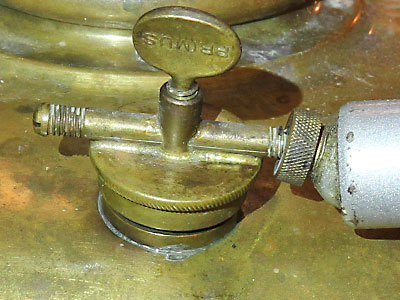

    Regarding your question about an external pump, the answer is yes. They use an external pump.
    It attach to the un-plugged tube at the filling lid.
    It's similar to an old Coleman lamp, i.e. the lid has a simple NRV in the form of a loose check ball, and it is sealed "for real" with the air screw once pumped up.
    A regular bicycle pump works fine:
