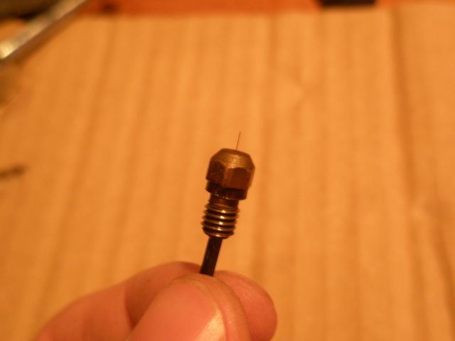

    unfortunely niddle was broken.
    so i have to make new niddle . all is good working .
    thanks .

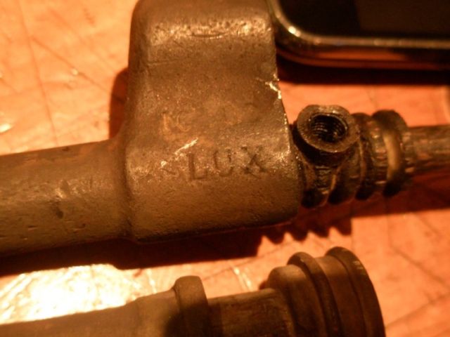

    optimus mark on the fuel cap
    lux words with vaporiser.

    sirius lantern niddle part. i use with vice.
    use 0.5mm small hand drill with make new hole.
    use acupuncture needle
    make another needle.

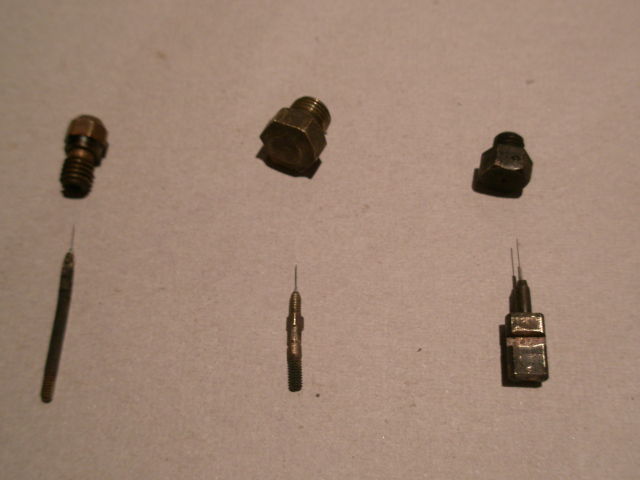

    nozzle and repair needle
    left: radius 143 lantern repair needle
    middle: petromax little baby 900 repair needle
    right: sirius lantern rpair needle
    you can see new needle

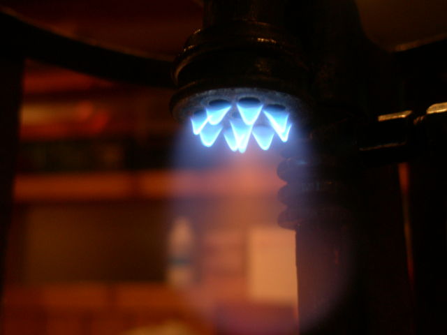

    fire flame .

    "use acupuncture needle" That is a Great Idea! Those needles have to be strong, well made and have precise dimensions. I think a trip to China Town is in my near future. And a super nice lantern as well. thanks!
