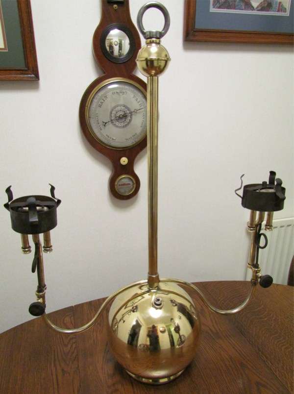

    Here's one I polished up at the weekend, whilst the sun was shining. :D Unfortunately the original nickel plated finish was beyond repair so the only option was the strip back to brass and polish. It needs some final polishing and then I will change the seals and gaskets, check for leaks and then fuel her up and see how she runs. Until then these pics will have to do. :D :D :D/

    10,537
    It's looking good Matt! :thumbup:
  3. Claus C
    Dec 18, 2012
    1,788
    It is looking so good Matt. :D/
    But I think this is past lamp - I think it is a chandelier. A pressure-chandelier - sounds good to me hehe.
    Claus C
  4. Jean J
    1,827
    That is one shiny chandelier Matthew! Do you have the ceiling height in your stately pile to allow you to hang it? Do you have shades for it?

    That must have take some polishing to get all that nickel off.

    Matt, you've done a splendid job on that PQ chandelier. Please share your nickel stripping and polishing techniques. I'd love to know.
