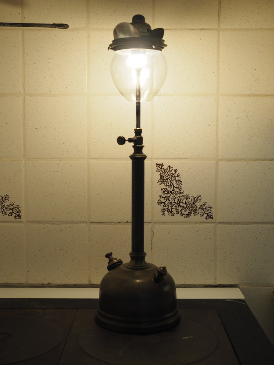

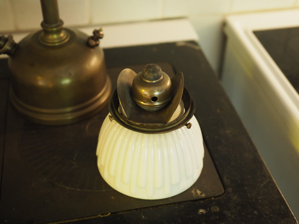

    Tilley TL 10 tank around 1922-1924 Similar tank than Latest Tilley TL 5, Burner and Shade from Tilley TL10 about 1926.Some parts missing one gallery Pin and Hexagon Control cock.

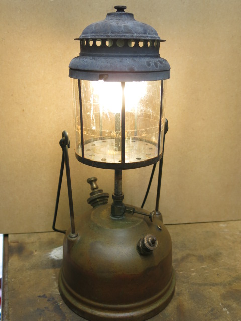

  11. pete sav
    pete sav Founder Member
    Sep 7, 2010
    809
    kab said
    here you are kab this is the PL 52 for 55/-
    cheers pete
