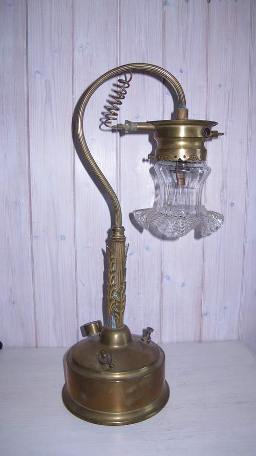

    Hi all
    Here is my last restauration project : A model 112 swan neck lamp from Guenet et Abbat (or Louis Compain ?). Production year ? After 1921 because this burner was patented in 1921. This burner is in a 1926 G&A catalogue, after, I don't know ??
    I am not sure who is the owner of the "Succès" brand . I guess this was G&A because all patents are from Guenet et Abbat from 1909 to around 1947.
    second hint : I have never found a patent claimed by Compain (who was also a seller of bicycles and motorcycles in Paris in the 30's)
    Third hint : The "Comptoir Culmen" was the "syndicat des commissionnaires négociants en gros du cycle, de l'aviation, de l'automobile, des sports, 10 rue de Lancry, Paris)
    this can be translated by " commissioners wholesalers trade union "
    My guess is that louis Compain was only a retailer, until the proof of contrary ;-)

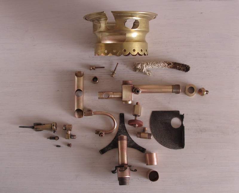

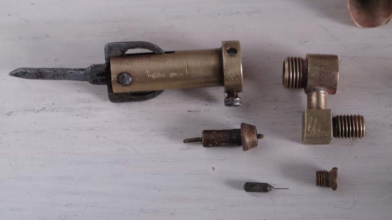

    For this hour, I am fighting with the 101 burner. All spares seems to be present although the needle is a little poor in quality and the needle system completely jammed.
    here is the dismantled burner ; funny puzzle, don't you think ?

    reassembling the burner in 8 pictures
    1413130158-1.JPG 1413130180-2.JPG 1413130191-3.JPG 1413130204-4.JPG 1413130218-5.JPG 1413130236-6.JPG 1413130257-7.JPG 1413130297-8.JPG
    Yesssss, it's still raining tomorrow. I'll take care of the needle's system ;-)

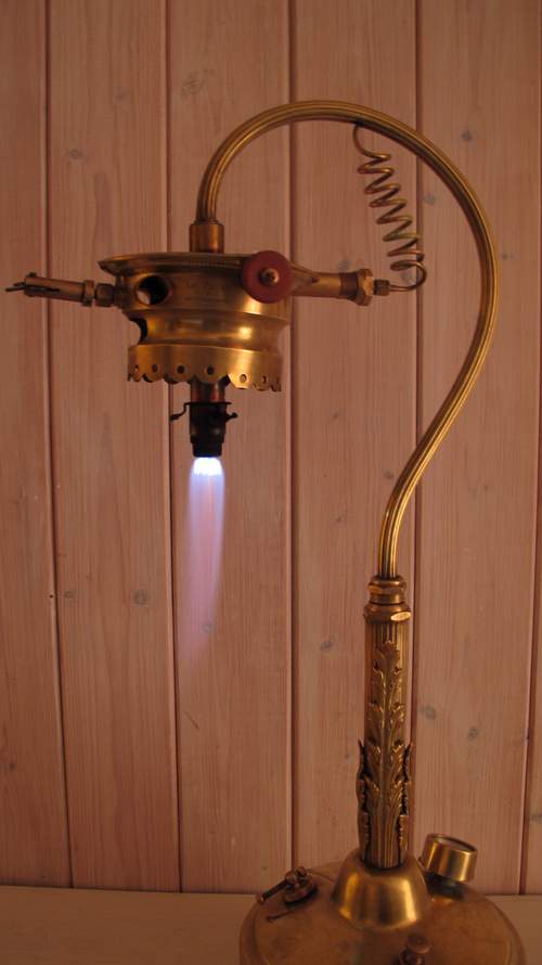

    A little update
    the resin has done its job, the fount no longer swells
    I did a test without glass or sleeve
    the lamp is running for 1 hour without any problem with 4/500 gr pressure
    I don't want to risk a globe or a tulip right now because the brass screw does not hold correctly in the glass holder. the threads are enlarged. And more, I have only 2 screws.
    The thread is 3/70 in metric. Untraceable !! I will be obliged to redo the screws

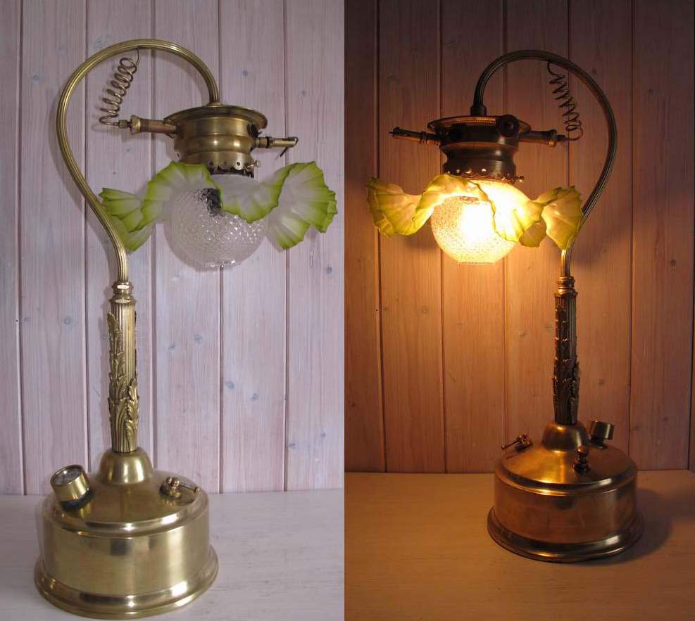

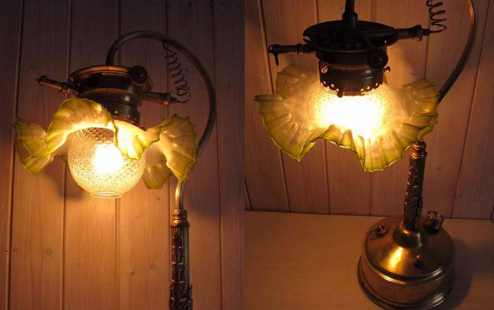

    little update
    the globe holder is repared and the lamp runs fine with its new green shade and a 500 gr pressure. This green shade is sold as an option in the 1920's.
