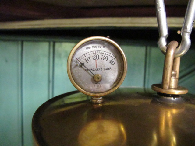

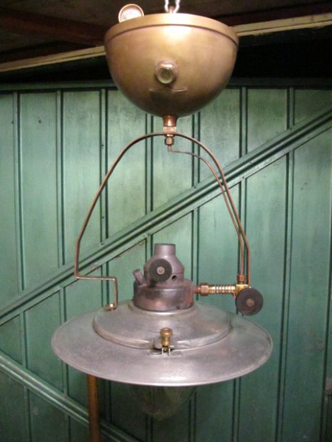

    Here is a Blanchard hanging lamp burner is dated as may 1922 what is unusual about the lamp is the flat bar arms instead of the usual tubes we see on their other lamps, it also has alloy reflectors again not the normal green\white enamel ones. The top reflector is a die cast alloy one while the bottom one is spun as they usually are. It is missing the top two cowls but i bet they was also alloy. This lamp has a serial number 35 in the usual place just under the tank and i do know of another example of this lamp but that one has the green reflectors.
    The pipe work and fittings are of the same size and type as what we see on the Blanchard handlamps so maybe these were for a special contract possibly army this is just a guess no proof or paperwork has been found on this model as yet.
    Burner was excellent so its had little use but loads of leaks in the pipework all sorted now and runs fine. The steel flatbar arms have traces of a bronze enamel on so maybe this was the original colour

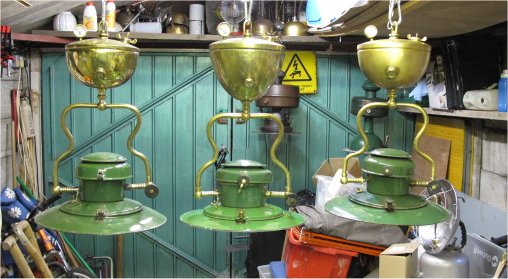

    Now matt there are still a few i dont have and would love to have so if anyone has any they dont want please get in touch can pay cash or trade tilleys !!
    Now just for you matt another picture of my garage door :lol:
    Still room for a few more in there :content:
    Thanks for the comments lads i did polish this lamp but these tanks over the burner type of lamps soon build a covering of soot one i did a couple of years back is nearly black now
