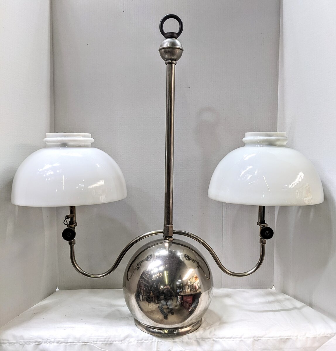

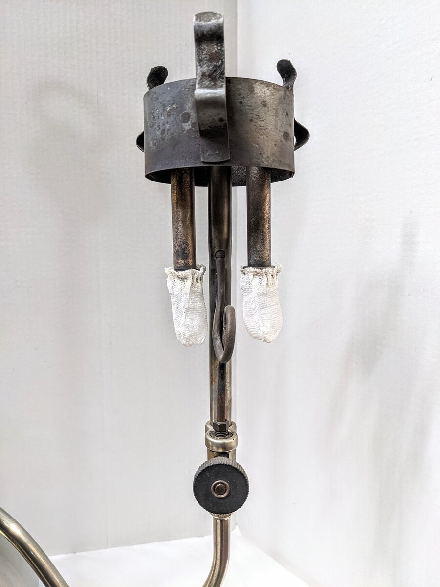

    B stamped valve wheels with appropriate 2nd generation Quicklite mixing chambers, and single patent stamp air tubes.

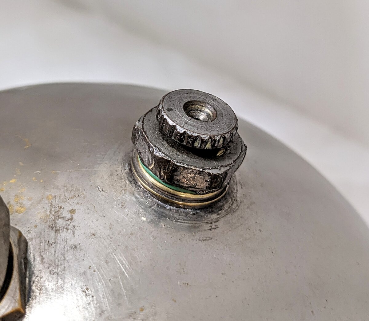

    The lamp is in quite good condition. What type of filler cap washer; looks like the seal washer used on some stove or is it a special O-ring? The ball at the top of the hanging rod is in great shape too. You have done a great job on this uncommon lamp.

    @Sedgman that is an HVAC compatible o-ring. We do a lot of automotive AC work so I keep a good stash of them here... I like to be able to tighten my filler caps by hand :)

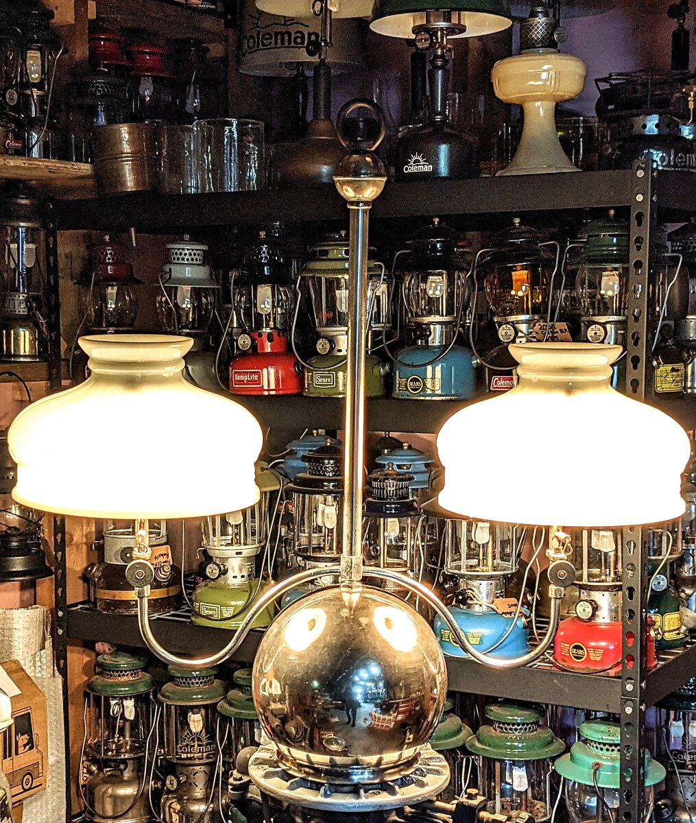

    Must be a bright lamp with two double burners.

    @Walkop Quicklites are not know for their brightness, but in it's day I'm sure it was a nice addition to a large room.

    Are those original shades...or repos. If repos...where?

    @Blueflame the shades in the light-up picture are reproduction 329's which last I knew were still available from Leacock -Coleman.
    The shades pictured un-lit are earlier 306's which are commonly found in antique stores here in the states. Many GPA and wickie lamps used those from the late 1800's on.
