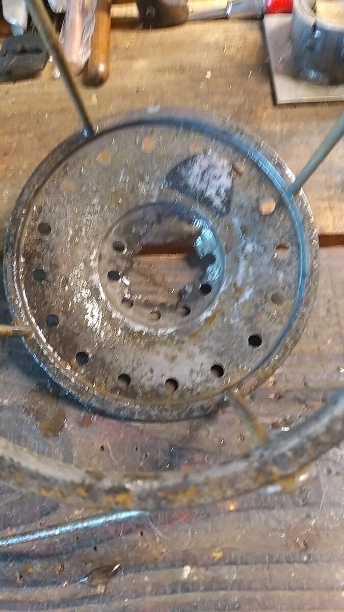

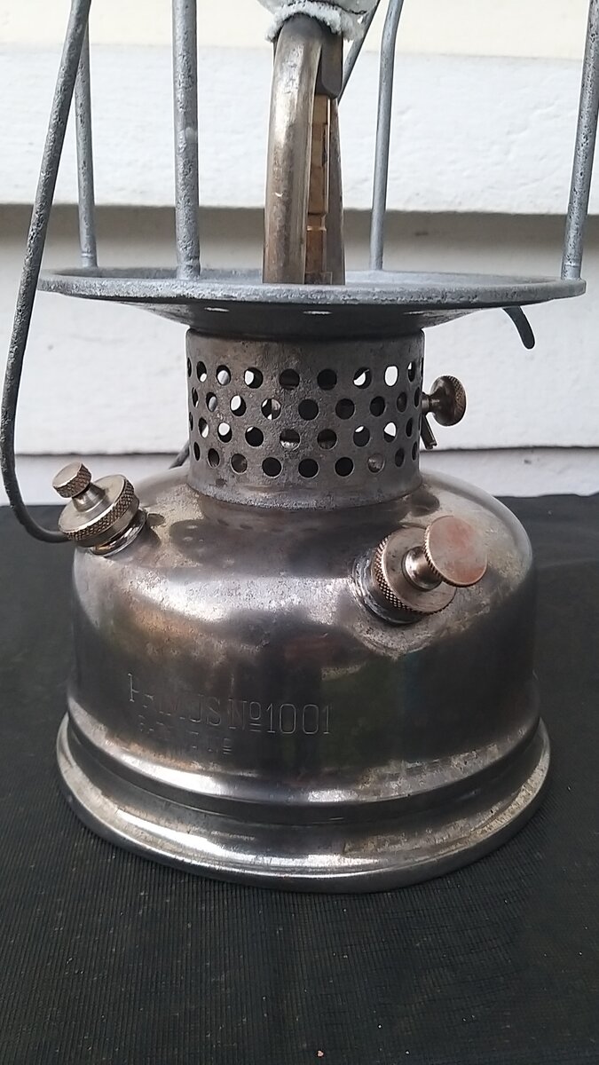

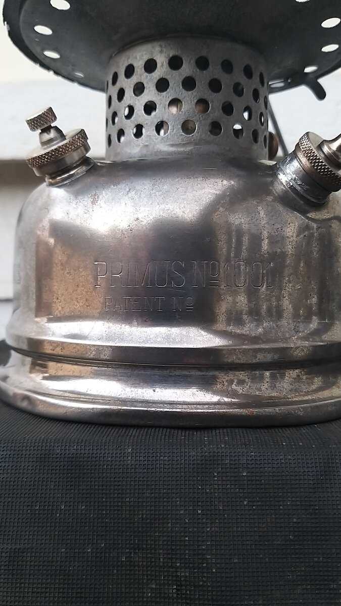

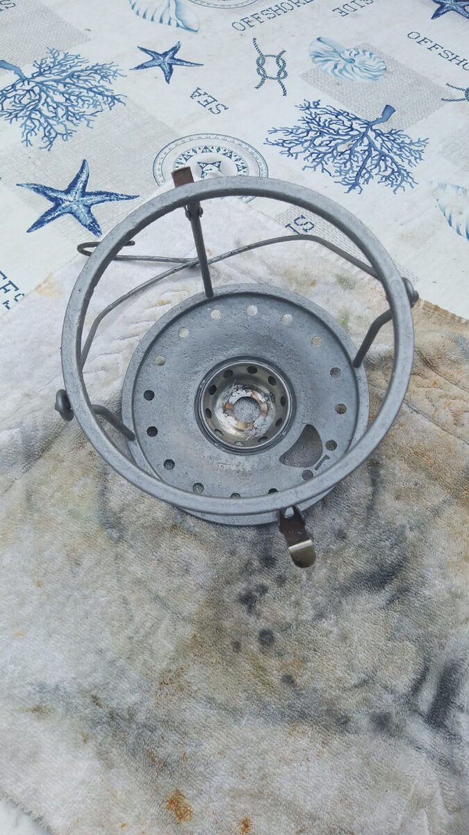

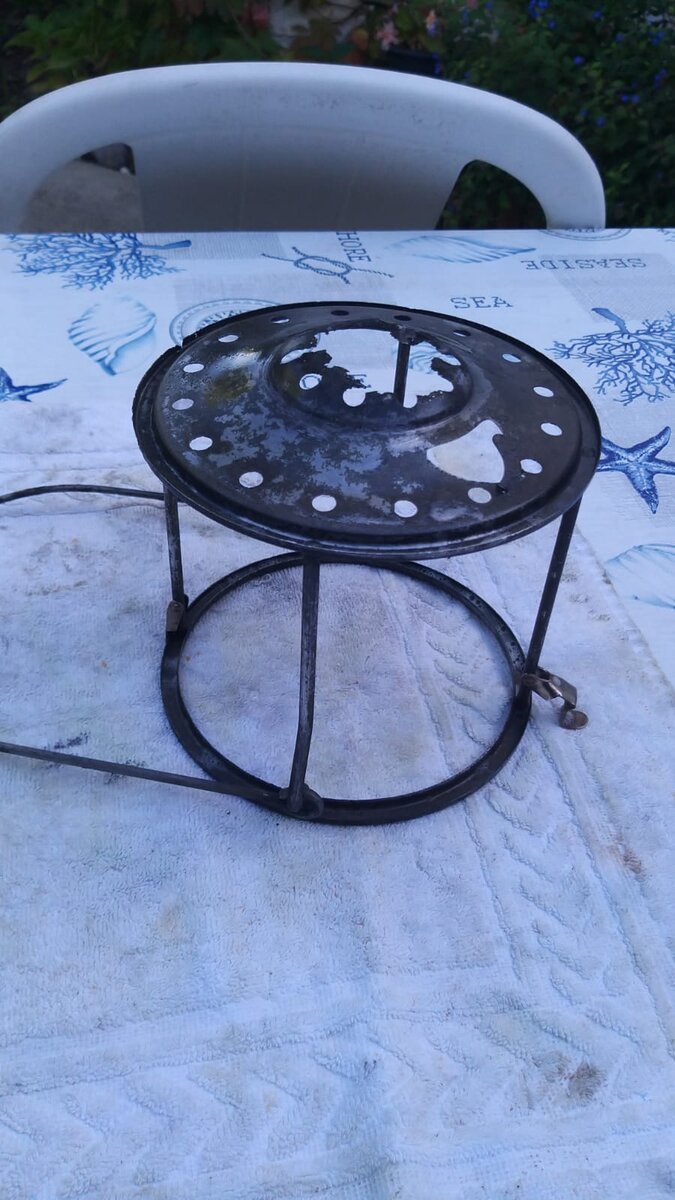

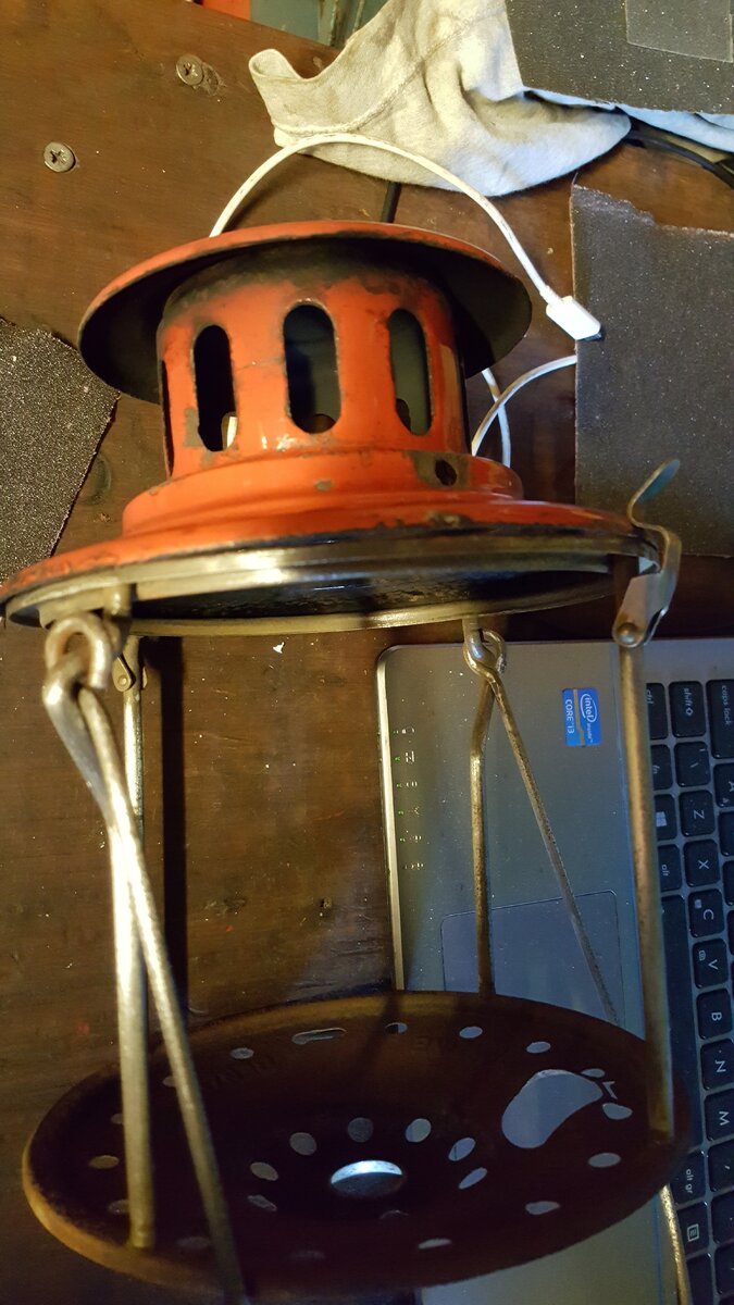

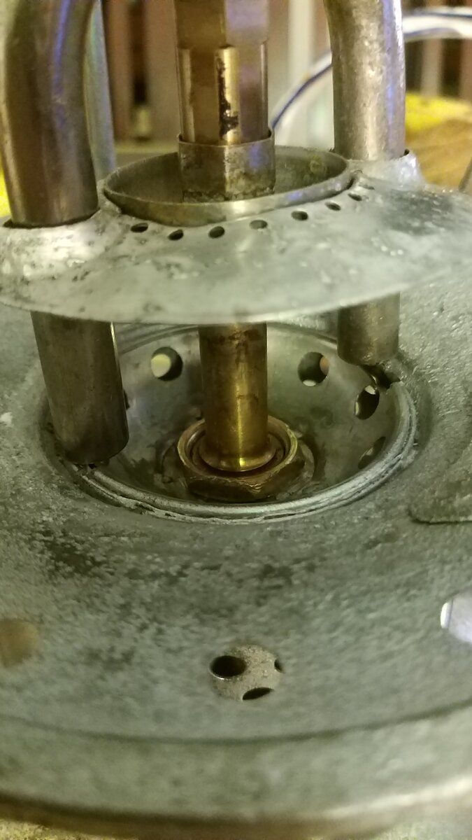

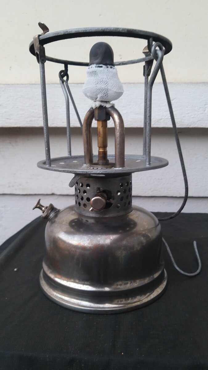

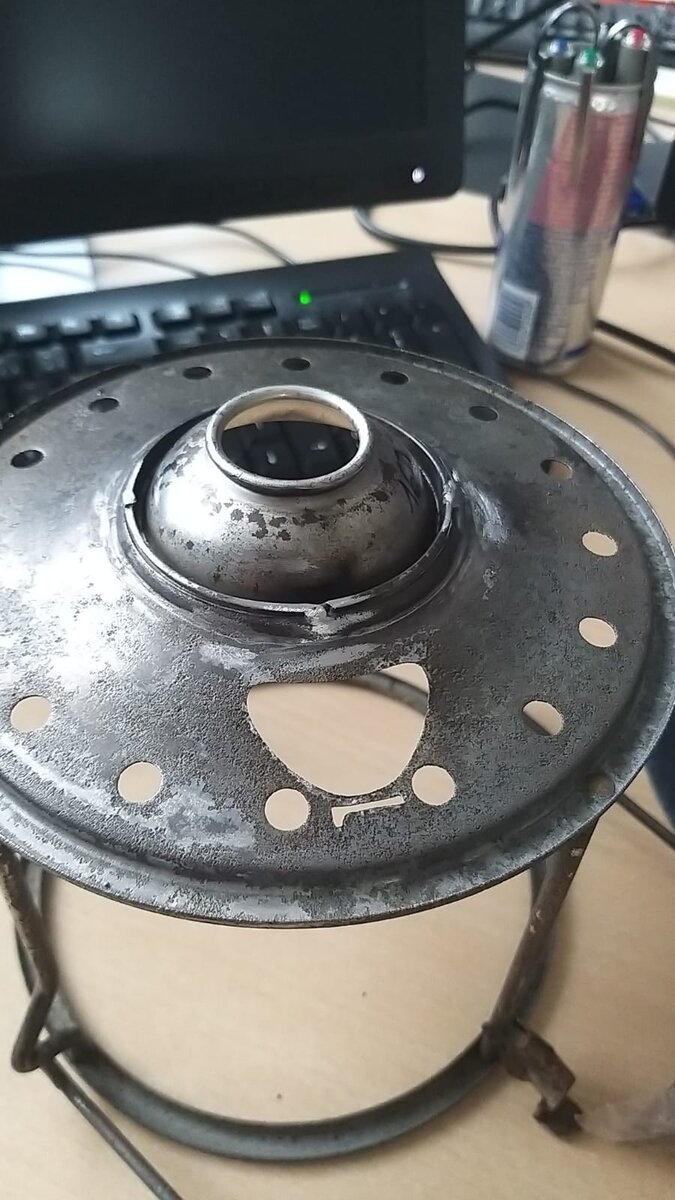

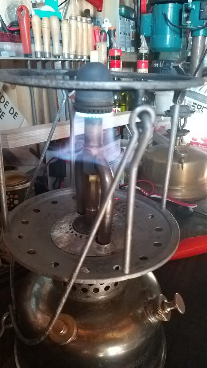

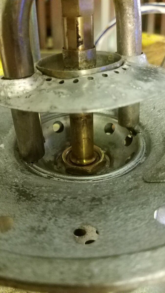

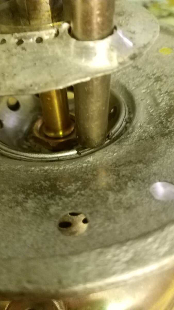

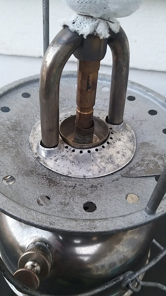

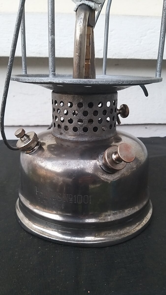

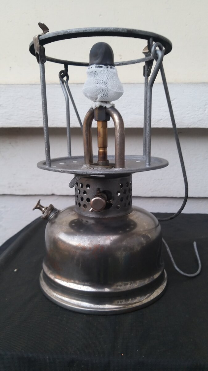

    Stamped S 29. A friend of mine give me this lamp. She was in a pitty state. See the pictures.
    IMG-20220929-WA0003.jpg IMG-20220930-WA0003.jpg IMG-20221005-WA0003.jpg IMG-20221011-WA0004.jpg IMG-20221014-WA0006.jpg IMG-20221014-WA0008.jpg IMG-20230121-WA0001.jpg IMG-20230121-WA0003.jpg 20230122_174412.jpg 20230122_174447.jpg 20230122_174426.jpg 20230122_174439.jpg
    I've to find/create a ventilator, and also make a mica or a stainlessmesh globe.

  5. Nils Stephenson
    3,178

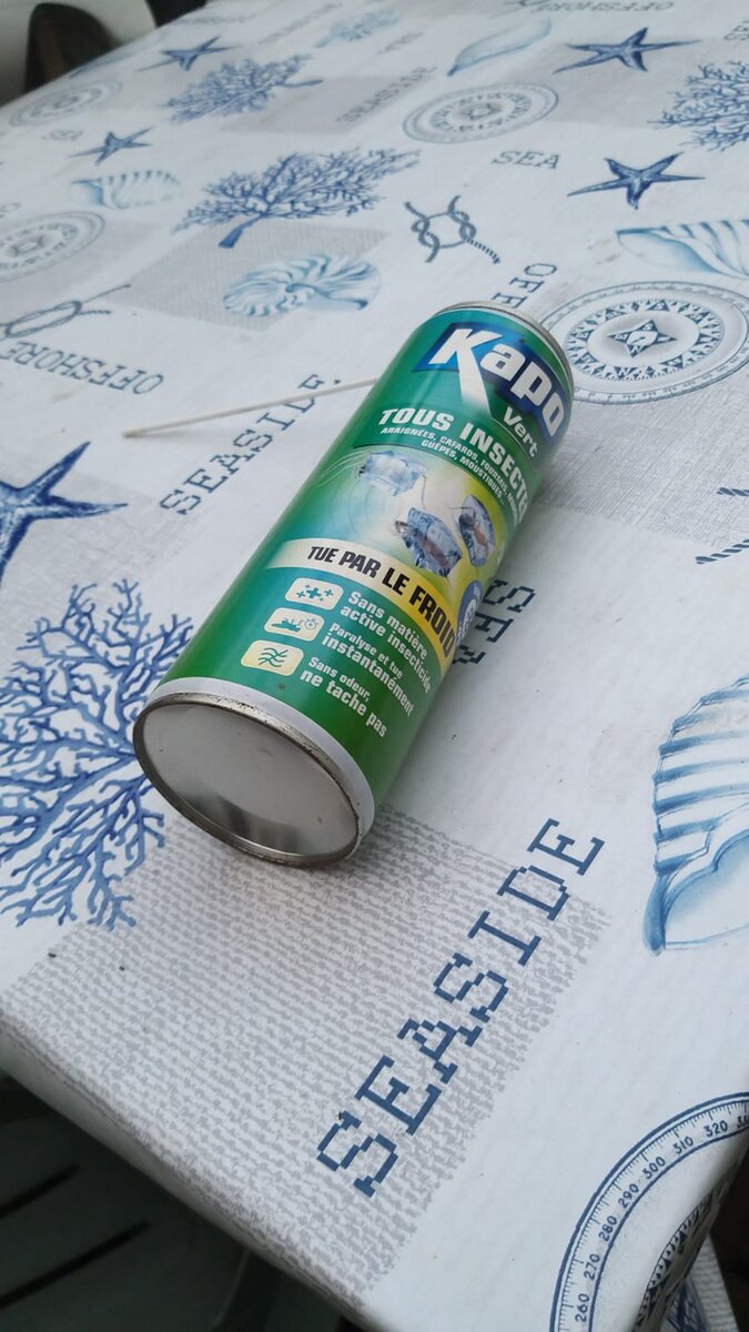

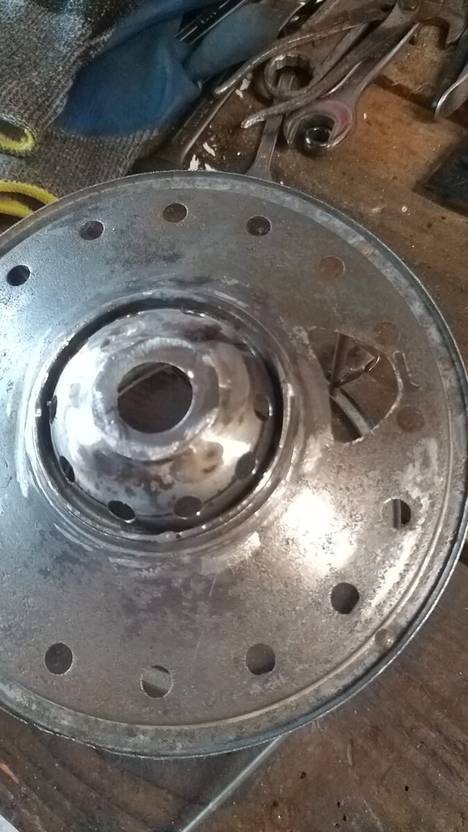

    That was an ingenious solution for the frame. What did you use? I have a 1001 that is almost as bad and have wondered how to fix it.
    A Coleman R55 generator will fit and work on these lanterns. A glass is more a of a problem. I don't know of a suitable replacement and I have been looking for a while. The only option is a mica reproduction.
  6. podbros
    2,982
    I agree, a great idea to use the top of the can in that way! :thumbup:
    But everything is so super thin ?!?
    Have you got a tig welder?
    top fettle marks there :clap:
    I thought I saw a thread where someone had used a Veritas cap ventilator but I don’t know the size of your resurrected lantern, I’m afraid
    great work !

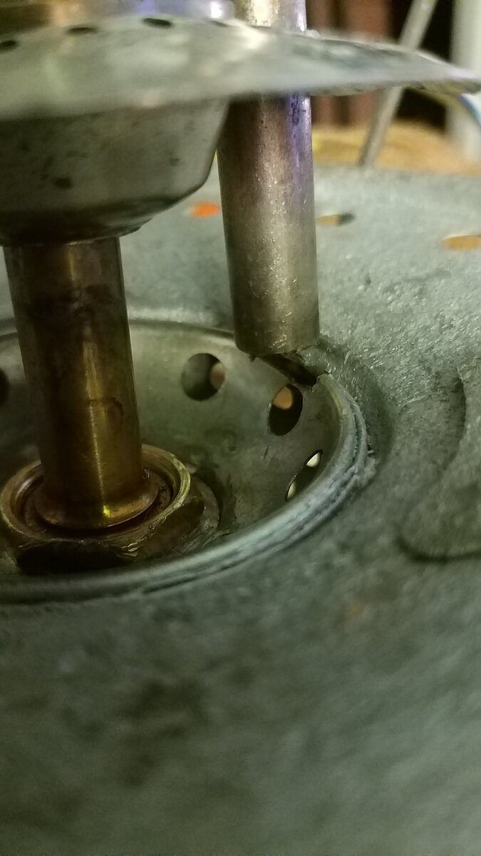

    Thanks for the informations, James !

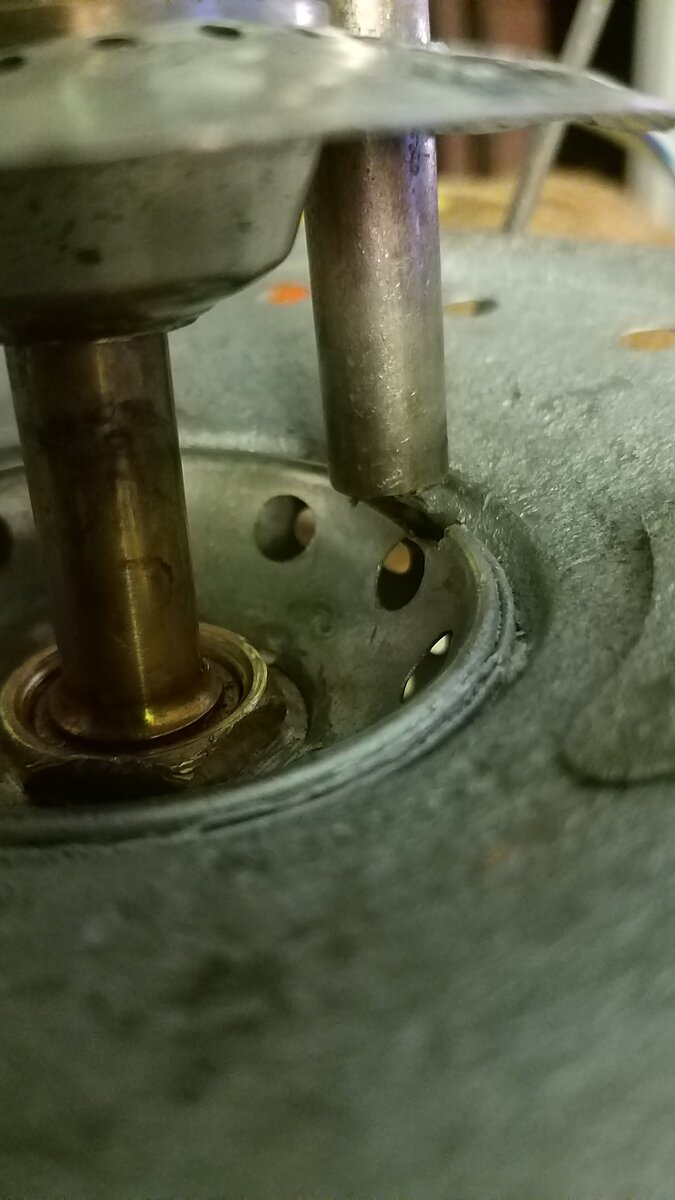

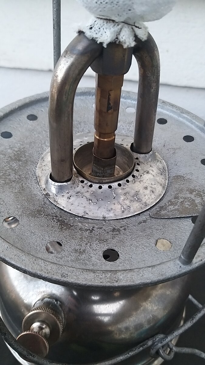

    I use the top of a spray can and a 30mm steel washer.
    I had to make two notches to allow passage for the air intake tubes (pictures soon)
    I'm working in a shipyard, and I have welding colleagues :D/

    @Nils Stephenson ,
    I use a 65mm spray can.
    The adjustments to be made, provide 2 notches for the passage of the air intake tubes. The detail pictures below.
    it requires rotating the cage/frame with the burner, and fixing with the screw on the collar in the end.

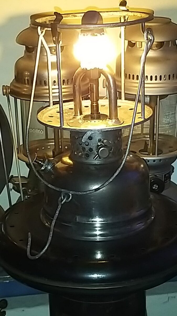

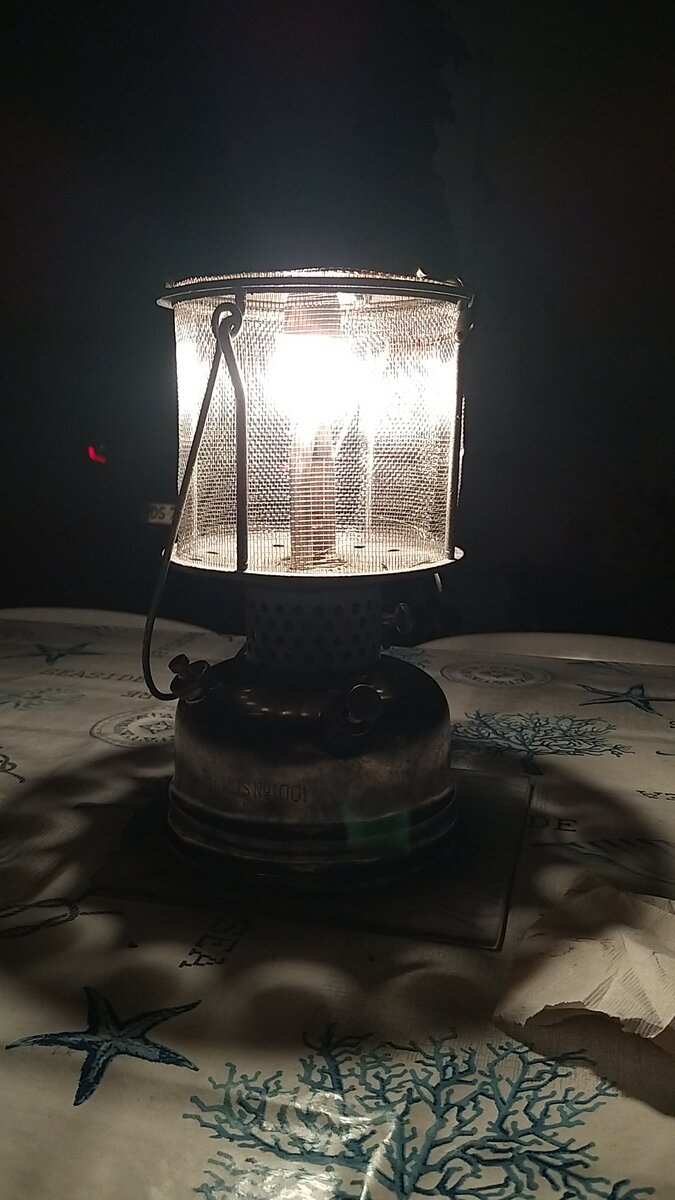

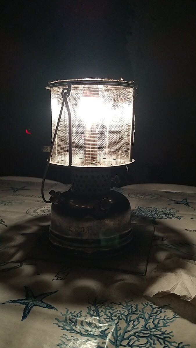

    Some news...
    I make a mesh stainless steel globe, it run well !
    Next step, rebuild a hood !
    A big job ....
