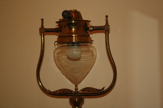

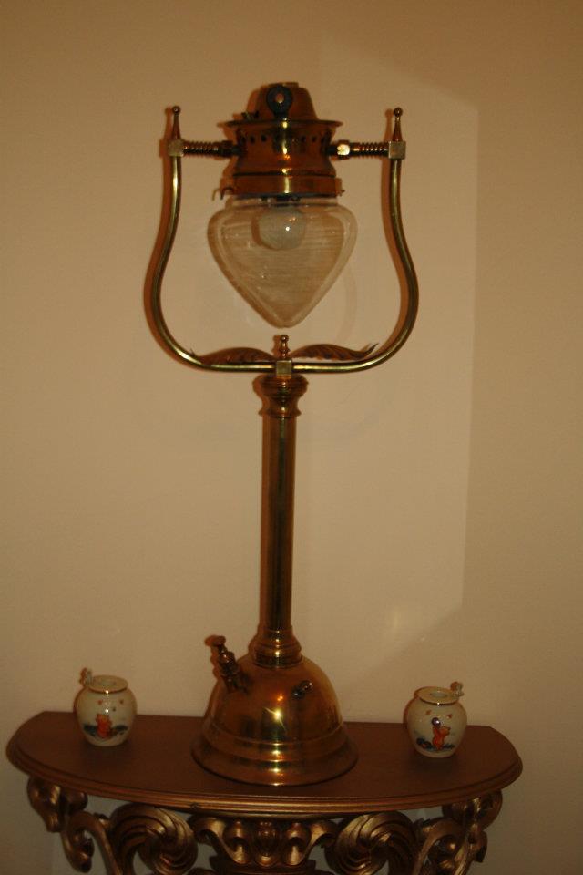

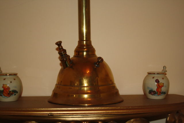

    Blanchard Table lamp Courtesy of my friend Chris Smithson

    Need to change the title here. This is a Circa 1929 150 cp Blanchard model 1000.
    Very nice lamp and one I wish I owned. Well a whole one anyway as I have the bottom half.

    Really nice lamp you have there Chris and thanks to Ozzy too for posting.
    Does the burner have a date on and a rated CP, I know Neil says Model 1000 and it is in the 1929 paperwork but i suspect Blanchard put out this lamp earlier than this date but there is lots of big gaps in the paper from 1915-1929, indeed little paper exisits on this company.
    I wonder if it could be a bit earlier as i have this lamp dont know model number but it is dated sept. 1921 but i reckon it has the same style tank as you table lamp so maybe yours is of the same period??
    We often date tilley stuff by the fonts so blanchard wont be any different i should think
    cheers pete
