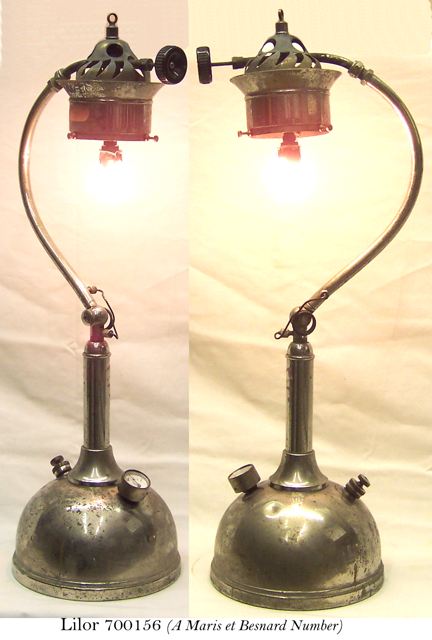

    Not sure that is the correct number for this table lamp. I don't have this illustrated in a Lilor catalogue but just in a Besnard one and they were retailers so may have given it their own number. Running here on gasoline and quite well at that. No globe because French lamps use a differerent fitter size to English product and I have yet to find one small enough to fit.

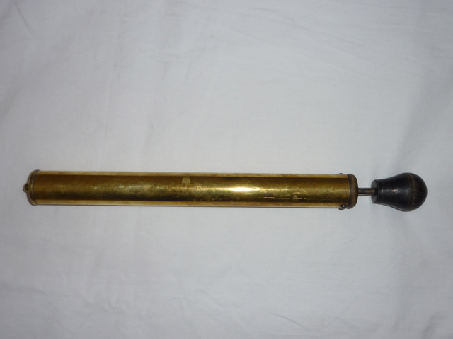

    In the image below can see a pump used for this lamp!

  7. Carlsson
    3,867
    Conny, that must be a Coleman pump, right?
    Which of course not is anything wrong since they use practically exactly the same kind of fitting/valve at the tank.
    And Coleman are sold all the time at ebay, so much easier to obtain.
  8. Conny C
    Conny C Sweden Subscriber
    879
    Well spotted Christer, that is a Coleman pump! I use this pump for all my French lamps as well as some others. There couldn´t be a major difference thou to an original Lilor pump!
    /Conny
  9. Carlsson
    3,867
    No, they look very similar.
    Not that I have seen any Lilor pump in the flesh, but atleast from what I can tell from the catalogue picture you show.
    You could turn a new wooden handle, shaped like the one on the Lilor pump, and swap it with the smaller Coleman one to make the illusion complete! :lol:

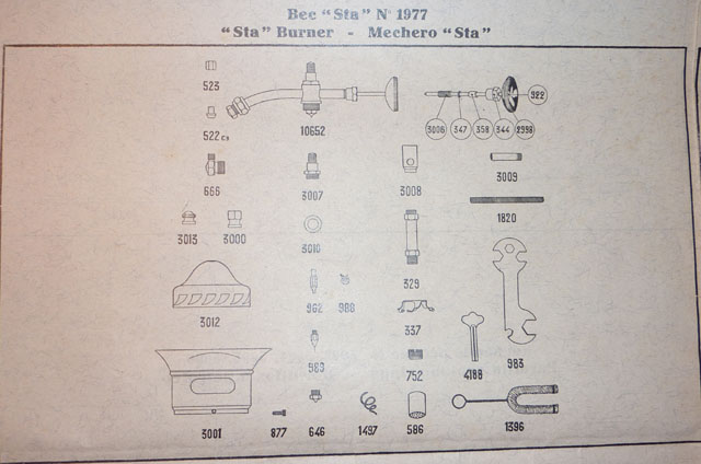

    Conny, do you also have the sheet with the burner and it's parts?

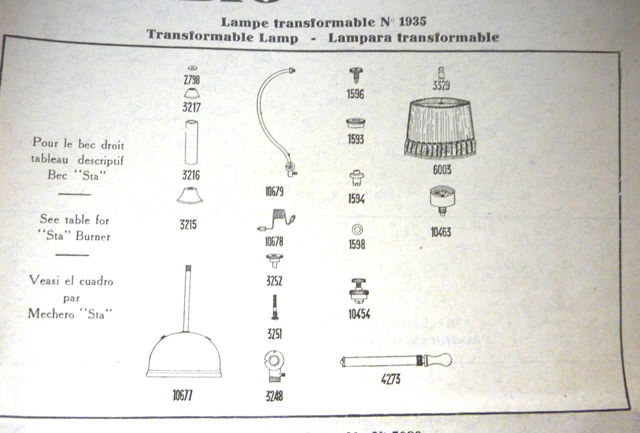

    Yes, I have a sheet that was included in the 1929 Lilor catalouge. There are some exploded view examples of burners, lamps, radiators and stoves.
    (Sorry for the bad image quality, my scanner is out of order, and I had to make photos instead)
