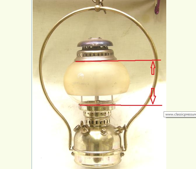

    I was woundering if any of you lucky 25x owners could provide me with this meassurment... see picture..
    Regards Fjellot
  6. Henry Plews
    1,277
    I've measured mine in three places around the circumference and taken the average.
    On my lamp, the distance is 130mm.
