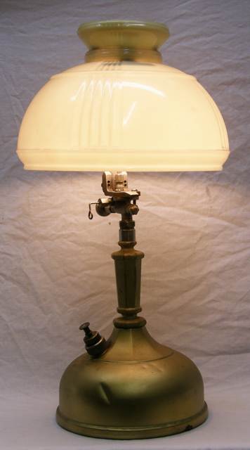

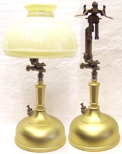

    This model 330 Lind-O-Lite lamp was made by A. J. Lindemann & Hoverson Co., Milwaukee, Wisconsin, USA. It will be from about the mid 1920s to early 1930s. A 300 cp gasoline lamp which has a pricker control built into the valve block and an integral pricker in the generator. The shade on this lamp is an original one. ::Neil::
    I had the model number wrong for this one. It is a mid 1930s instant lighting lamp with an integral pricker and combined pump/filler so it is 333A not 330 I originally listed ::Neil::

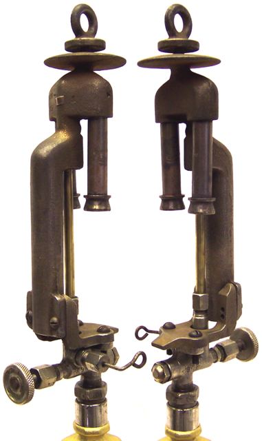

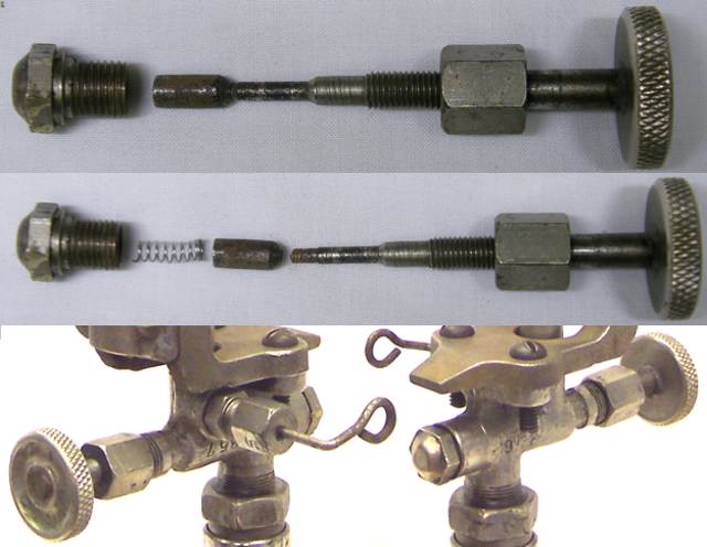

    OK I have now fettled this lamp and made it run. The spindle with air/fuel valve was sheared off so the air valve did not pull back to shut the air off. I have inserted a spring in there to push the piston back but I have to be careful now not to open the valve too far because there is now nothing to stop it screwing right out. This is the second of these I have found broken and I conclude that this might be a problem with operating any of the later Lind-O-Lite lamps. ::Neil::
