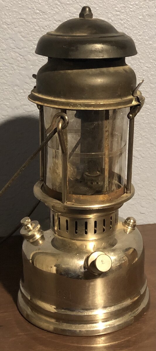

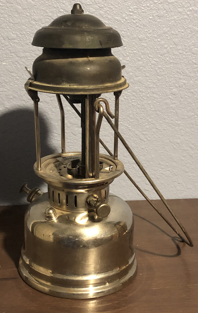

    Hello all,
    I have just received this absolutely gorgeous little 991, I’m a bit surprised as to how small it is; it’s good for limited shelf space. :lol:
    I’m pretty sure the mica is not original to the lamp but it fits nicely and will work.
    I know it’s an earlier production by the valve knob; but I’m a bit rusty on Primus dating.
    As fate would have it it’s either 9 Z or Z 6.
    All of the vents that I see in the gallery are porcelain; this one shows no signs at all.
    I believe they were 250 cp so no problem with mantles for this one.

  2. Henry Plews
    2,954
    Ignore the number, it is not known for certain what it signifys. The letter Z indicates 1935.

  4. Nils Stephenson
    3,314
    Just so you know, the number is a 6. As Henry said, we don't really know what the number means.
    The 991 was available with mica, but all the ones I have seen had full length panels. This one is probably a replacement.
    The nickel plated brass hood was an option and it is not seen very often. Both the 991 and 1020 had this option but they are fairly scarce.

  7. John
    John United States Subscriber
    Jan 8, 2011
    770
    Dallas, Texas; United States
    Thank you Nils.
    The mica appears to fit the 200 and 242 family of Coleman lanterns; so if not correct then at least as old.
    The cleaning rod, needle and nipple are all missing; I think that someone rolled it all the way up while disassembling it and they were lost through time. That is probably why it looks like it has sat on a shelf for a very long time.
    I have a nipple and needles coming from S Korea and will try the lamp with those.
    I’ve had pretty good luck at making a functional cleaning rod before, this is the gear type so it will be a nice challenge.
