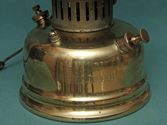

    Stamped AB19. A late (last year?) lantern of this model.
    The early 1001 has the non-nickeled versions in the catalogues, but it doesn't appear in later catalogues.
    But this one is in polished brass, and from every detail I have looked over it appears to have been made this way.
    Either that, or someone has made a very thorough job in removing the nickelplating in every possible nook and cranny all over and in every possible detail.

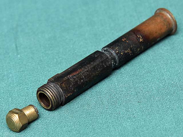

    The "1001-type burner" has the best vaporizer there is for us who tinker with old stuff. It uses a two-tied mantle, but the vaporizer has a jet you can exchange, and the vapo is simplicity itself; just a solid, straight tube.
    No one can fail to clean that one. :lol:
    Vaporizer with jet mounted and needle in top position:

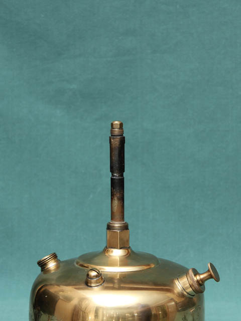

    And the central tube (that's what it's called in catalogues) without the air tubes assembled so you can see where the gas stream suck the air in:

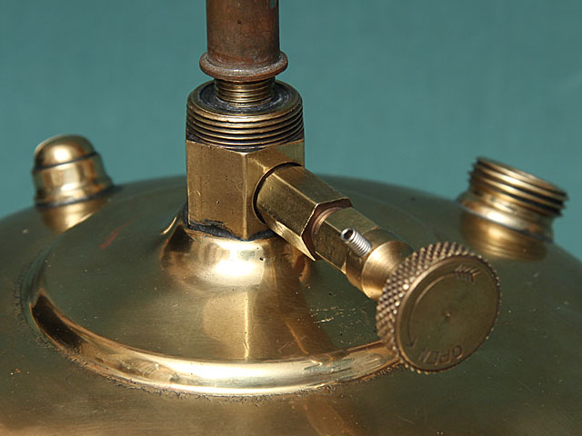

    Some other views of the burner system. Vaporizer, then vaporizer with central tube and finally with air tubes and mixing dome (gas mixer according to catalogues):

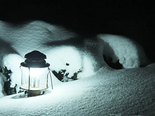

    Then it's out in the snow to see if the lantern perform as it's supposed to.

    Any thoughts about the possible brass option from this period?
    I was a bit sceptical first, but after all it all look too good to have been "de-nickeled" afterwards in my eyes.

    Some initial tests outside. The lantern performed well. Even perfect...
    But what else to expect? It's a Primus, isn't it?
