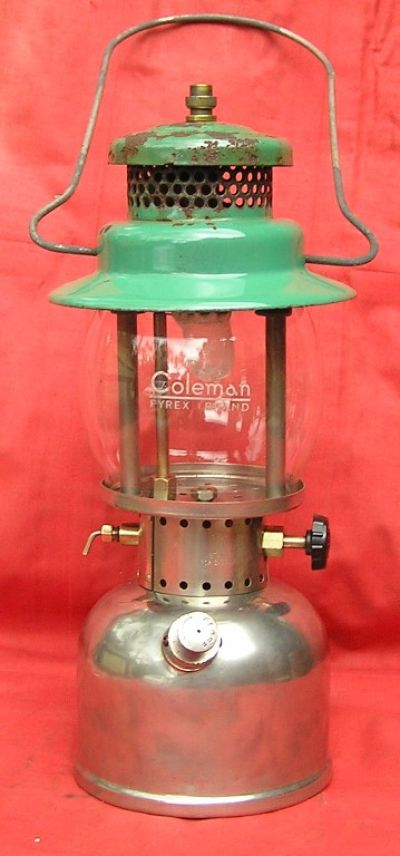

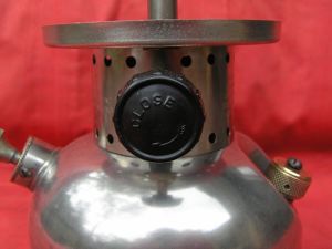

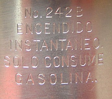

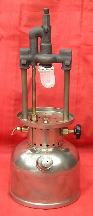

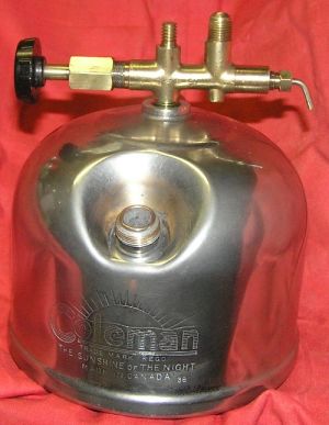

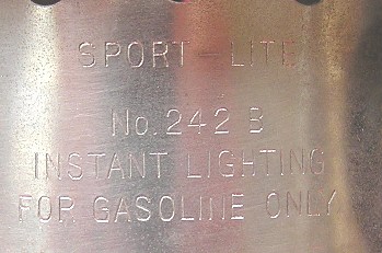

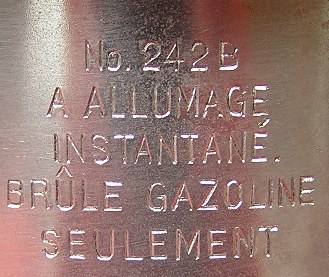

    Coleman 242B "Sport-Lite".

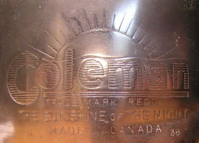

    Date stamped A 38 made in Canada

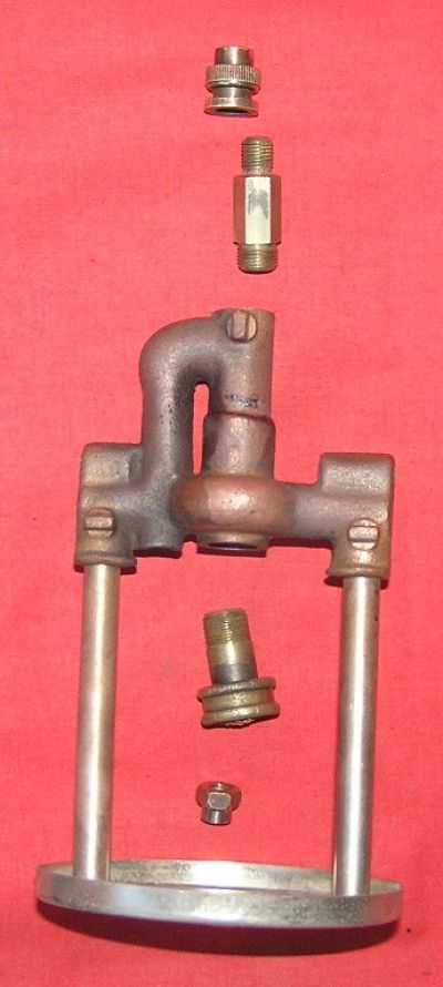

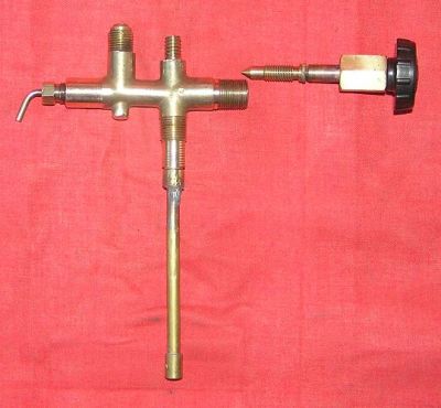

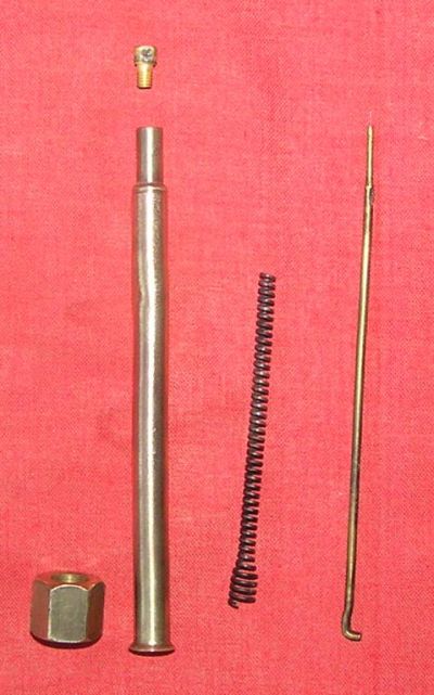

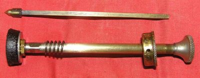

    All moving parts on this lantern were seized and I thought it would require a complete strip down. I was wrong it only needed 95%.
    1453636099-2_opt.jpg 1453636130-P2_1.JPG 1453636163-P2_2.JPG 1453636188-P2_3.JPG
    1453636232-3_opt.jpg 1453636294-4_opt.jpg 1453636319-6_opt.jpg 1453636361-7_opt.jpg 1453636410-8_opt.jpg 1453636505-9_opt.jpg 1453636612-10_opt.jpg 1453636650-11_opt.jpg 1453636698-12_opt.jpg 1453636728-14_opt.jpg 1453637681-16.JPG
    Links to Two topics I found useful:

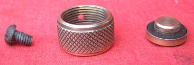

    Both graphite gland packing’s responded to a little heat and didn’t need replacing. Link
    The check valve responded to "lacquer" thinner and didn’t need removal. Link
    The lantern has a steel base and was rusted on the inside. I cleaned then treating the rust with phosphoric acid.
    Overall I am pleased with the outcome.
