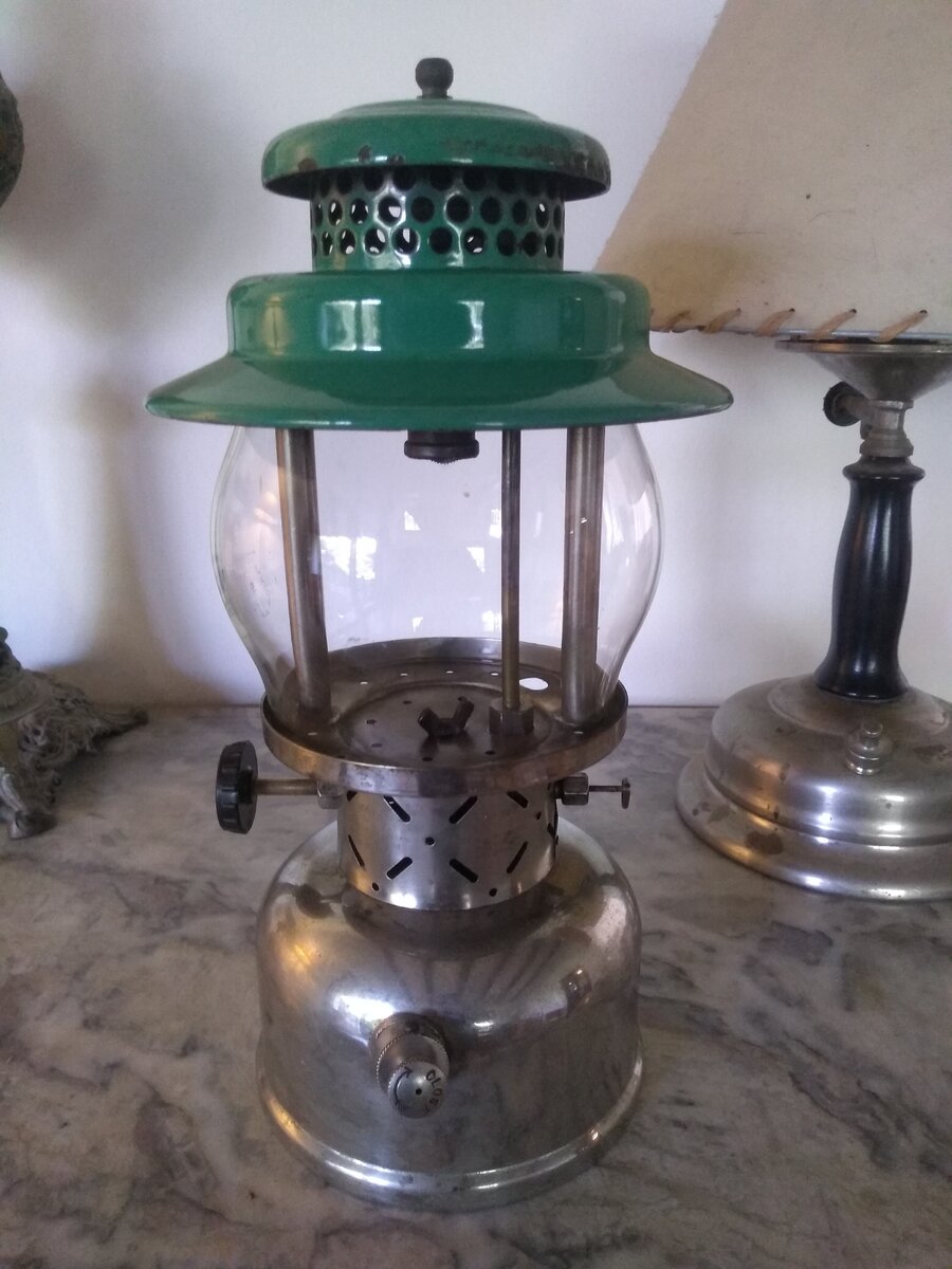

    A splendid restoration project!:thumbup:

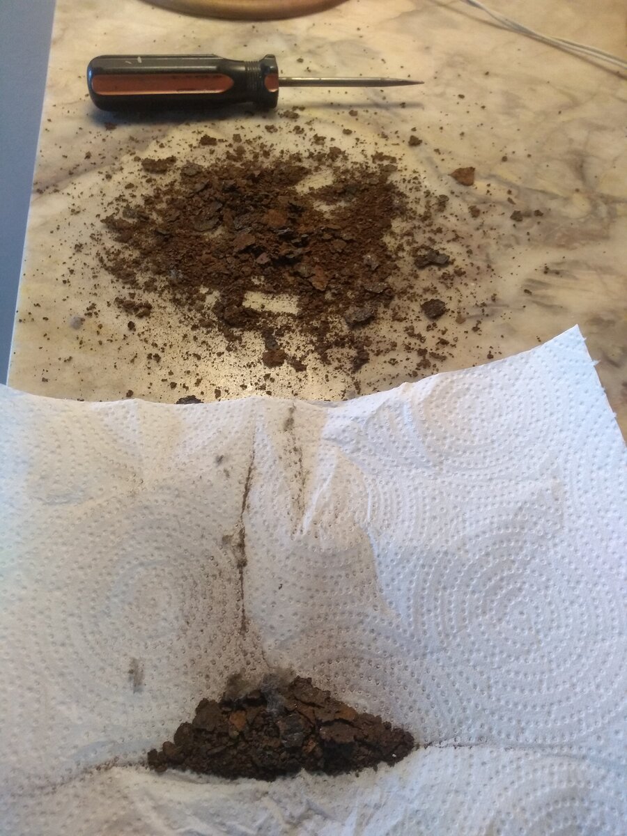

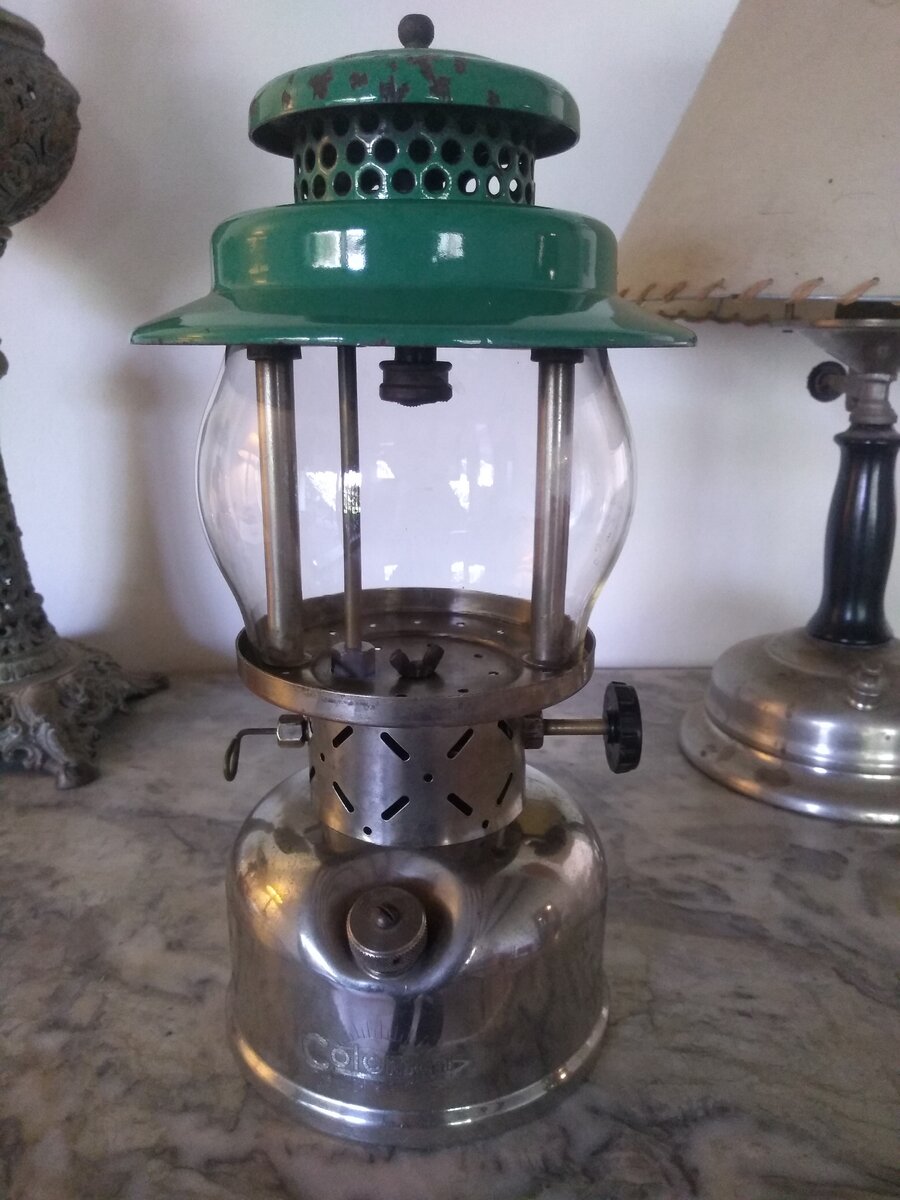

    The lantern is in great condition, only missed the hand bail. The quality is amazing but I wonder why the bottom is steel: I found a lot of rust inside and I hop it will keep pressure. See the pictures.

    That's a lot of chunky, flaky rust! Before you go any further, I'd check the bottom and any areas that look suspect, I'd poke at with a sharp awl. If it still seems solid, I'd do a pressurize and dunk test.
    Coleman used steel baseplates on all of their lamps and lanterns, and while they won't bulge out like a Tilley from over-pressuring, they do rust. Water from condensation sinks in naphtha and this is the result.
    Good luck as you press on. I know your pain.
    Mike.
  9. AussiePete
    2,858
    @Juan
    A steel base doesn’t bulge under pressure as easily as a brass base. Of coarse brass, if used, is sometimes ribbed or thicker to provide structural strength with some manufacturers making allowances for bulging by a thicker base rim. I guess Coleman weighed up these methods and went down the cheaper steel base path.
    As @MikeO has said, check the base carefully for pin holes and do the dunk test.
    Good luck.

    I did a good pressure test and no problem with the tank! But I haven't got success on lighting it fine.
