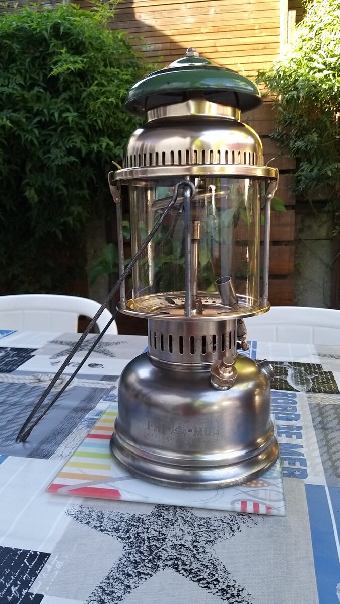

    I received my spirit cup, and i try to do one like a Primus one.
    First run, with a chinese mantle 500/600 CP. When it burn, it's look like a 300 CP !!
    20200929_180419.jpg 20201001_175150.jpg 20201001_204821.jpg 20201001_204827.jpg 20201002_164941.jpg

    Hi @Sellig33. Was the 1081 not rated at 300 ? maybe try a smaller mantle for max brightness.
    looks like it is burning well
    Chris

    @Fireexit1,
    That's right !
    The Chinese mantles i use, when burned are the size of a 300 CP :D/
    It's chinese made :mrgreen:
