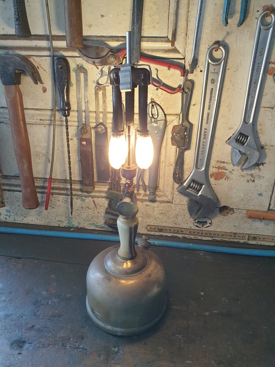

    These are an okay lamp but I now prefer Shellite lanterns in the Coleman series! Fettling these has been challenging despite simple appearances. ](*,)

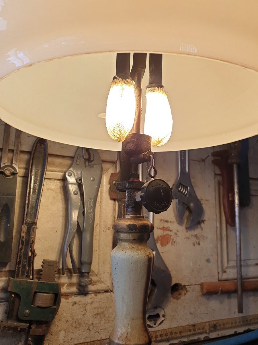

    Anyway this November 1939 unit works well and quietly. The original Canadian shades were fabric and laced and I have none so I have added a glass shade which goes okay with it. A globe was another option. If I was firing it up again I would probably use Coleman #20 mantles as they are a smidgeon smaller than the ones I used which hit on the pre-heater cup.

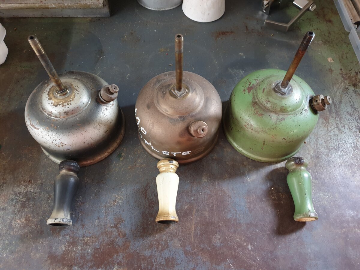

    These lamps differ a bit over the years. The riser tube in 1935 had a round fitting at the base beneath the wooden handle and in 1939 and 1945 the fitting was square.

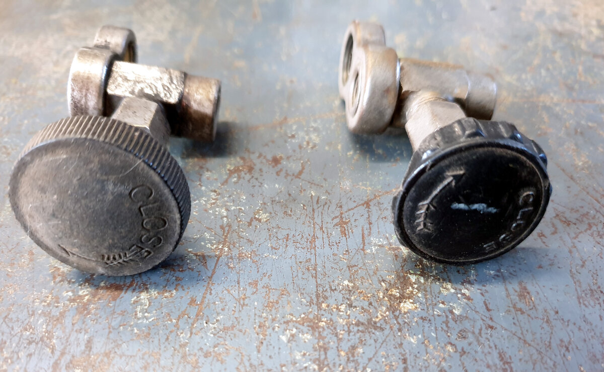

    The control valve wheel was not the 12 ribbed type on the 1935 model but round and fine lines.
    Here are some photos of a 1935, 1939 and 1945 in comparison (L to R)

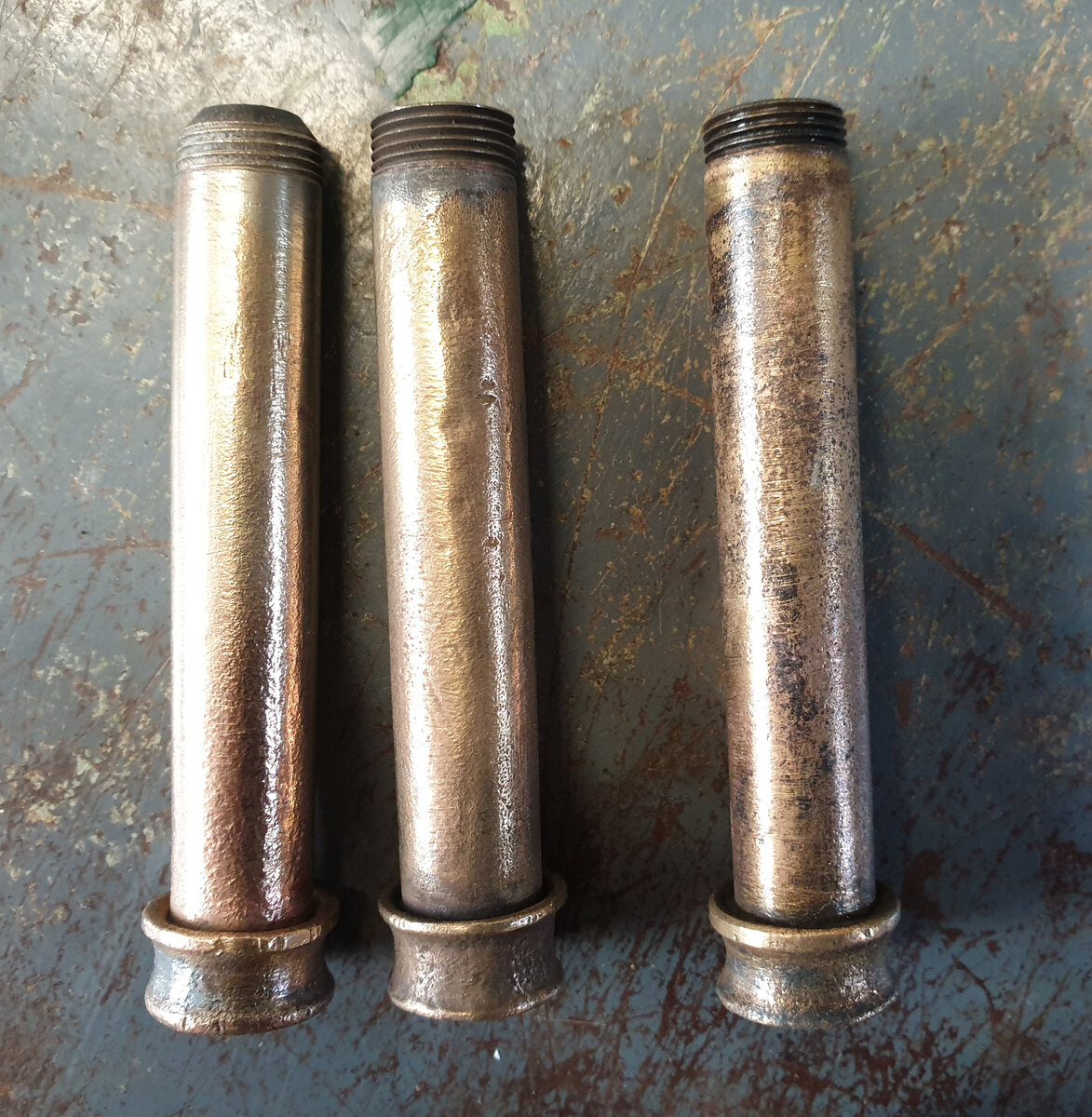

    The rear of the burners:
    The front of the burners
    The valve wheels 1935 and 1939
    The generators were all R55 with a square nut at the bottom.

    I agree with something that I once saw @Mackburner write. If a shade fits and looks good that's all that matters. I like your shade though it is probably a touch too large for this lamp even if it is only 10". Each to their own, I'm sure I have shades on lamps that aren't quite the right dimension's for the lamp. Often you have to make do the best one can.
    Many of the GPA companies or their agencies, sold lamps with or without shade. Back in the day most households had a spare shade that was off a clapped out lamp. It made buying a new lamp more affordable if one didn't have to buy the shade too.

    It is actually surprising how different in size shade holders can be from lamp to lamp. Going against the grain of what I said above "Many of the GPA companies or their agencies, sold lamps with or without shade.", quite a few of the companies seem to organise their shades to fit a shade holder particular to their lamps. It is a nightmare trying to find shades to fit some lamps. It is much easier to change the shade holder.

    Which shade should be on that lamp?
  7. Sedgman
    326
    Wimmera, Victoria
    @Jean J
    I believe only fabric shades; not glass. One of mine had the shade ring still and the finial.
