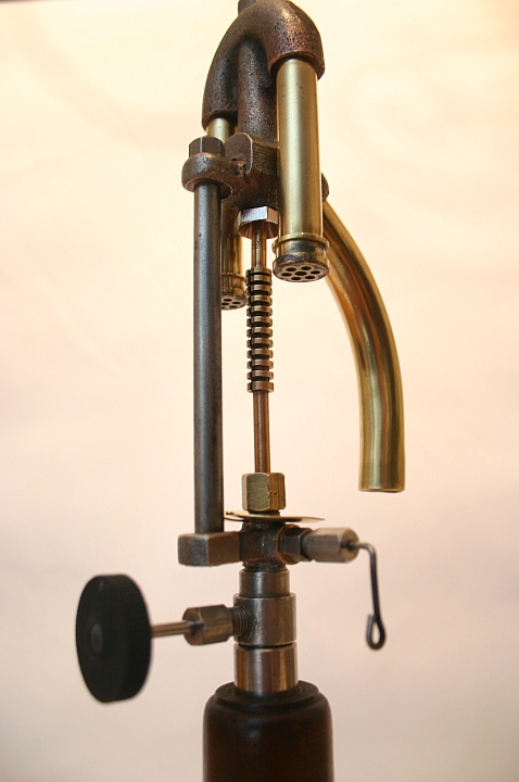

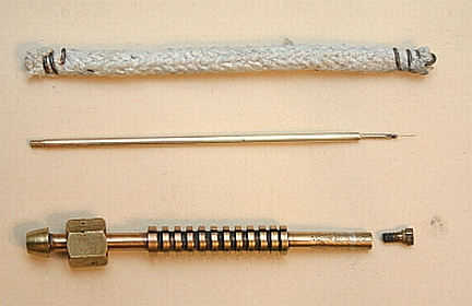

    It does have a very unique looking generator. I could not find a patent for it, so I'm not sure of the intended purpose of the applied ring structure around the body of the generator. Perhaps as a better heat transfer to the skinny body. You still need to pre-heat for a good minute and a half or so, for proper vaporization. The cleaning needle screws into the eccentric block, and the metal spring inside the tube is held captive there, by having the base opening swaged to a slightly smaller diameter, probably to keep the spring from coming out and resting on the raiser mechanism. There is no meths cup, instead there is drip shield, probably on which you rested an asbestos torch, so you did not need to hold it during pre-heating. Just a guess.
    Even though the generator spring was not removable, I was able to clean out most of the carbon via some heat/quench cycles and engine carbon cleaner. There is also an asbestos fuel restrictor/filter in the feed tube from the fount, just below the main valve. This was in excellent condition.

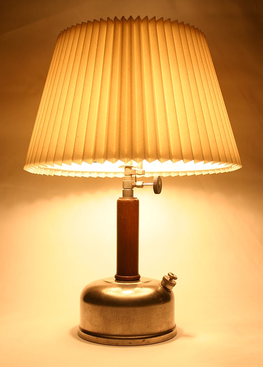

    Once all cleaned up and tested, the lamp performed really well, very bright, with pair of Coleman 21 coarse weave Silk-Lite mantles. I have better luck with these rather than standard Coleman 21 or Peerless mantles. Not sure why.
    The only thing remaining was the shade. In keeping with the spirit of the original shade shown in the catalog, I had a complete new pleated hard linen material, white styrene lined, shade made to my dimensions by Fenchel Shades for a very reasonable price. Time will tell how the styrene (plastic) lining will hold up to the heat, but the white lining does a great job reflecting the light from the lamp.
    The mica globe is probably the original. It was quite dirty and not very translucent at first, but after running it through the automatic dishwasher, it came out looking quite nice and clear enough to use (after a little bit of straightening). The dishwasher trick has worked well for me before. If not, Fred Kuntz makes excellent replacements.
