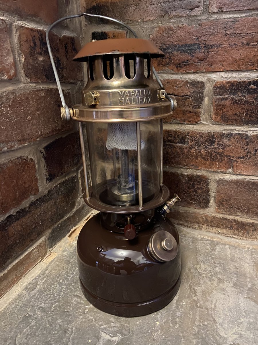

  1. BigStevie
    1942 300 which came from another member. This has ticked the box for a much wanted model! Hood with WD and 1942 stamps, later globe.

    Nice looking lamp Steve, how far will you go with the restoration? I think once you get that sort of patina it's a shame to loose it.

  4. Alenstein Poland
    Oct 3, 2019
    181
    Ełk
    Nice lamp :)

    Non gallery? E41 style top? steel font? is that different, certainly not common.
    Martin
  7. BigStevie
    @paparazi This is my first early vapalux, so I’ve a lot to learn! I guess being a military lamp they must have been made in some quantity?

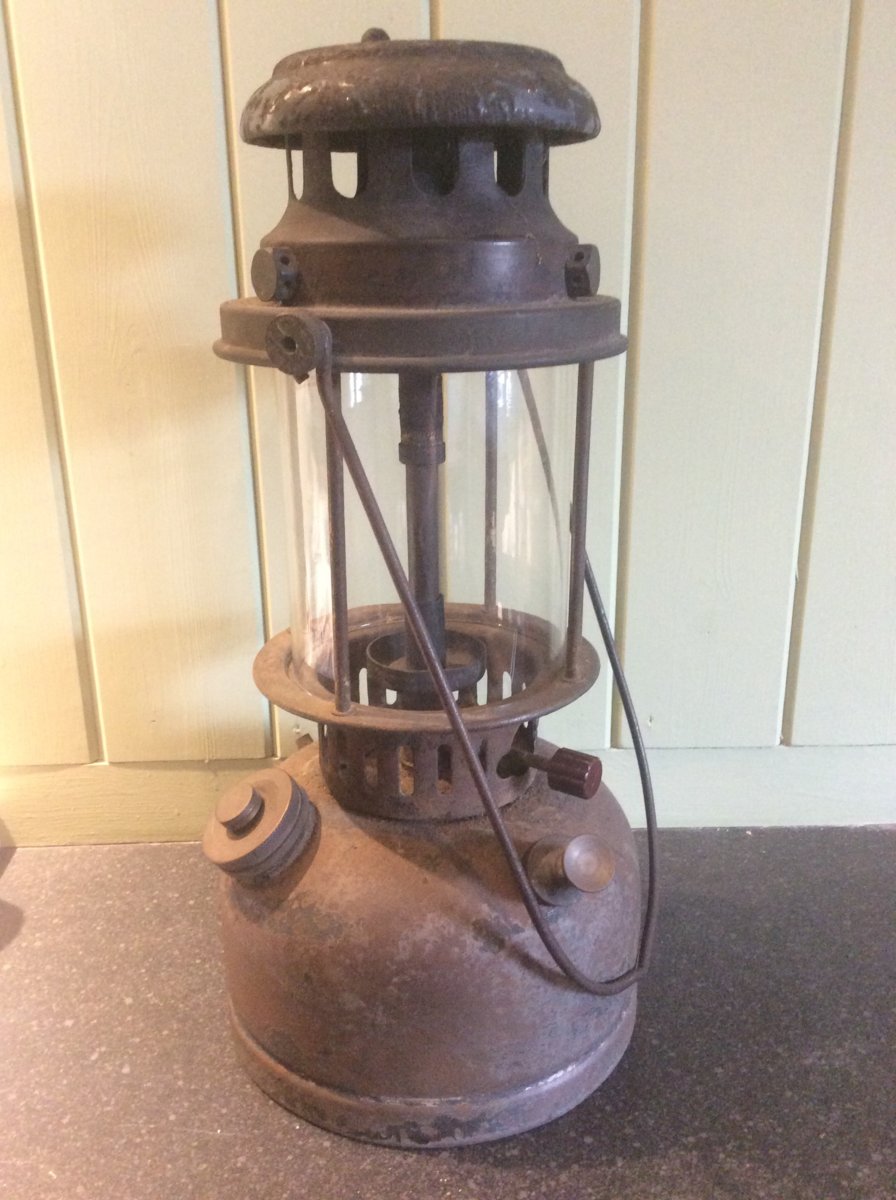

    @BigStevie Very nice lamp. It’s very similar to the one I restored last year, but mine sadly didn’t have a date stamp on the hood.

  9. steerpike451

    Nice! IIRC that's the very first version of the 300 and supposedly wasn't made for very long-first the pip went then the cap was replaced with the " coolie hat" by the end of the year.

  13. M.Meijer
    608
    Netherlands
    This lamp is a merger of styles seen among the lamps from 1942. Appearantly W&B initially made the typical E41 top also in steel and fashioned this on the newly developed brass ventilator with the 3 visible air buttons.
    There might be a year punched into the rim of the latter, as in this lamp, but there are without. Also ventilators with Vapalux in small lettering has been found on lamps from this era. A typical W&B product with varying detailing.
    As to why this E41 style top was soon replaced by the simple coolie style, perhaps making it in steel on the same dies did wear these out rapidly, or produced too many rejects? I am just guessing here.
    To my eyes the E41 top has the most classy looks; when it was replaced by the simple coolie-style top the lamp as a whole became more utilitarian.
    Lovely time piece, Stevie!

  24. Matthew James United Kingdom
    May 13, 2020
    1
    Manchester
    Gary I'm pretty sure this looks the same as yours. What do you think.

    @Matthew James this was what I found when I restored mine.
    - Hood stamped RD838212
    - All steel tank
    - Filler cap appears to be Speculum-platedor?
    - Brass tap with arrow on, not see that before
    - Frame, top and bottom collars steel, vertical supports brass. Marked PAT no 540783
    I believe mine to be 1941/42
    Yours looks to have a brass tank, larger opening in frame for the control cock and you don’t have the vertical slots. I would says yours is later from 1944. It would have a brown enamel top on like this one.

    @Gary Waller
    The blue one you posted further up is mostly E41. The brass tap is as far as I know unique to E41 yours also has the circular indent in the top of the tank where the frame sits, again E41. If it’s an all steel tank, then I believe that is somewhat uncommon, if you look in the E41 section of the gallery you’ll see 1 example from Ian Ashton.
    If you could get hold of a two piece E41 hood and fit it to that lamp, then it would all be correct as an E41.

    @Matthew92 yes you could be right, but it could also be a first version 300 as detailed by Ian. Who knows what happens to these lamp over a period of 70 years. But I do agree a E41 tip would sit nice on there, but would it be correct.

    Does anyone have a clear definition of the differences between the E41 first & second model, and the first 300? I'm asking because I have what I always thought to be a transition model; it is dated 1942, has the E41 type of top, brass knob, pressure tit and brass fount with circular indent. I hope to have it working soon, if I can find a decent vapourizer.
  30. David Shouksmith
    E41s have a separate gallery/burner and ''empty' hood - compare with the Petromax arrangement. Anything later will have the burner and hood as a combined unit - compare with the Tilley arrangement. I'm almost certain the two types are interchangeable.
    I suspect there was an overlap period in production when the E41 parts were used up so late E41s and early 300s are concurrent. I've no proof of that but I can't imagine a factory foreman saying, 'right lads, we've used up all the old parts now so let's have a cup of tea and we'll start making the new lanterns after that.' - particularly in wartime...
