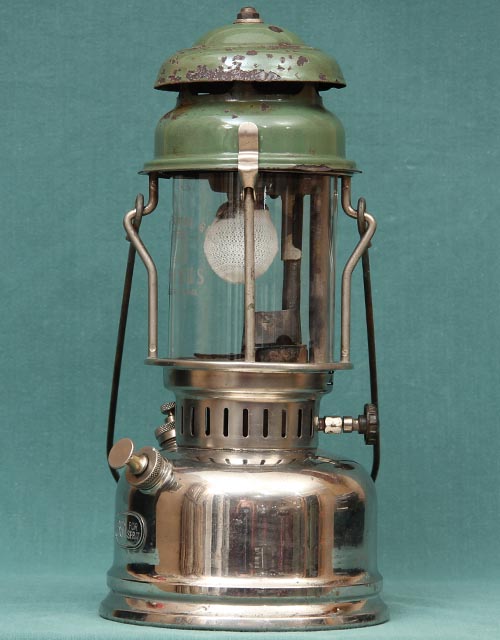

    Marked AI 8
    391 is the alcohol fuelled version of 991, and this particular specimen still had the alcohol jet, but for some reason it had the thinner paraffin cleaning needle.
    The air restrictor was also removed- or lost- so I borrowed the mixing tube from this one so I could test it. I will turn a new restriction later on and press into the air tube.
    It's a worn and battered lantern, but as usual with these Primus models (the 991/1020 burners), you can't fail.
    Simpler and easier lanterns to get working is hard to find.
    The third image with the lifted mixing tube is to show the air restrictor at the bottom of the air tube.
    1375390490-sidovy2.jpg 1375390497-sidovy1.jpg 1375390479-strypning.jpg 1375390506-ratt.jpg 1375390545-exploderad.jpg 1375390553-391.jpg 1375390538-glas.jpg
