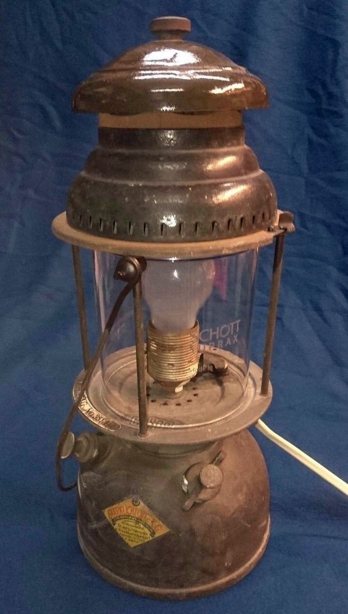

    Hello Frederik,
    that's a nice find. I've got the same variant, but it was in this condition when I bought it:
    Luckily I was able to restore it to original condition because the electrocution was done carefully, and I had all needed spare parts at hand from some other donors. From the side shown in the picture you can see a decal from a well-known German reseller which tells "Starklicht Otte K.-G. Stammhaus Bochum, Zweigniederlassung Rönkhausen", whereas on the other side the small blue/gold "HASAG" decal can be found.

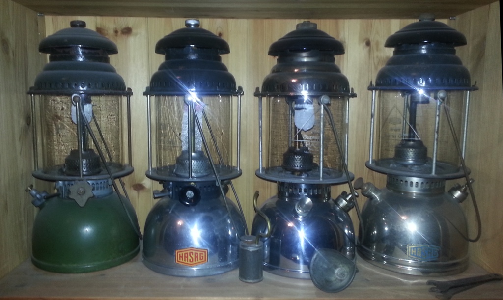

    Obviously there are several variants of the 351L, and this one in particular has a dark grey/greenish laquered tank, grey enamelled hood ring and a brown cap. But besides that one I have now 5 other versions of the 351L which seem to be original, since they show up in the same configuration from time to time. Four of them are shown in the following photo:
    Unfortunately none of them has a date stamp.
    BR, Martin

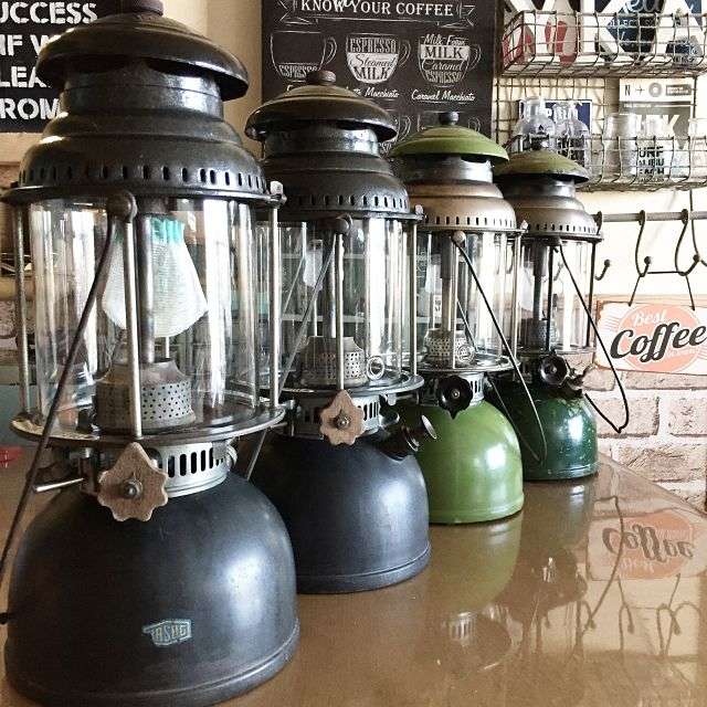

    Oh,nice351L!
    I like Hasag & MEWA 351L.
    My collection are shown in the following photo.

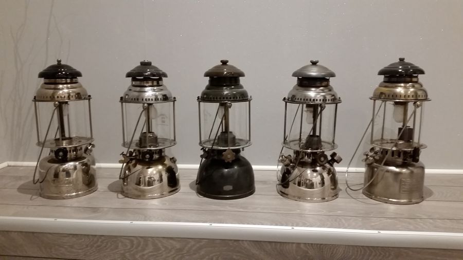

    Hello Martin & YOSH
    Nice collections, i have a number of Hasag/Mewa/schatz lanterns and yes, they really runs and looks good.
    I did run my Wartime 351L on gasoline yesterday and it works flawless, even though a bit noisy when running on Gasoline.
    Frederik

    Frederik,
    the two with the light/dark green tank in the background are most likely "MEWA" built by "VEB Leipziger Werke" in GDR after the war. You can see that from the pricker dial (bakelite wheel with "pointer") and the filler cap, which are different from those used at the earlier Hasag types. However, in a technical sense these are mostly identical to the Hasag 351L. More different is the BAT 270 and some other types made by VEB Leipziger Werke, e.g. those equipped with ceramic burners and slim shaped vaporizers.
    If somebody would be more interested in the particulars of the differences I could make some photos maybe at the next weekend, and maybe make up another post in the discussion area.
    According to the manual you can run them on both petrol and paraffin, and also my experience is that they sound noisier on petrol, in particular in the first few minutes when they are cold.
    BR, Martin

    Hi Martin,
    These are my HASAG and related lanterns, they are from left to right.
    HASAG 51A Probably late 1930's to early 1940's
    HASAG 351L this one had a Steel tank, but i had to change it out becuase of a pump tube failure, has the same handle and needel wheel as the 51A, and i believe it's from the same period as the 51A, HASAG 351L Whermacht circa 1944, MEWA post war, and the Schatz 551L, basicly an over engineered 51L.
    The twoo HASAG 351L's are very similar, but the MEWA has alot of small differences, such as no light hole hatch, smaller preheater, different vapourizer, and a DDR marked top nut.
    Frederik
