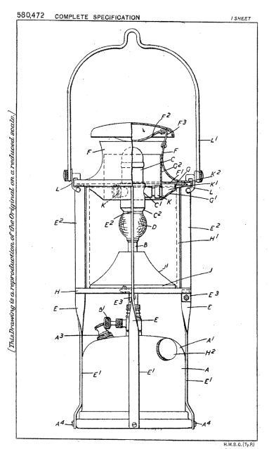

  25. Anthony
    Anthony Australia Subscriber
    May 7, 2013
    1,389
    "Complete Specification Accepted: Sept. 9, 1946"
