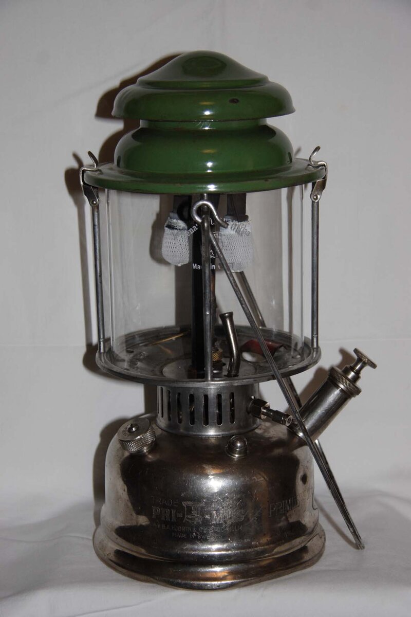

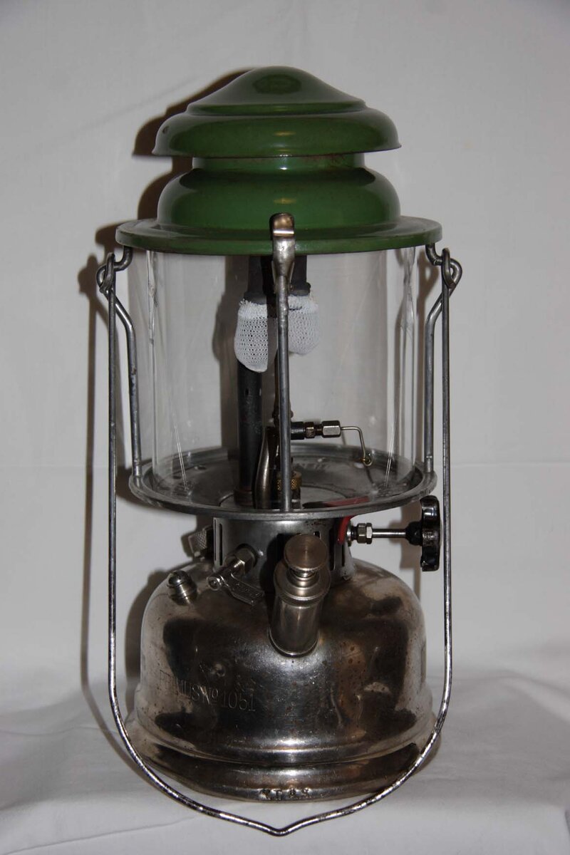

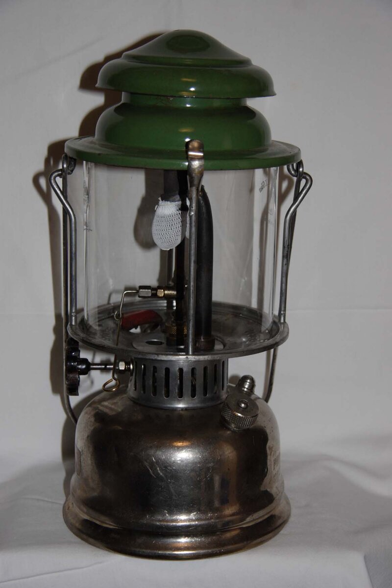

    This is a lamp that my brother in law had for many years without doing anything with it. I have now cleaned it up and got it working. Unfortunately I forgot to take photos of it lit.
    It is basically the last variation of the 1051, so no surprises there. This one though has been used by the old Copenhagen telephone company (KTAS) and still has the decal on the tank. It has been well used but is in quite good condition. An interesting thing to note is that the glass is marked Optimus. These must have been ordered by Optimus to have as spares for the Primus lamps after they bought the Primus rights. It has date mark AO 17.

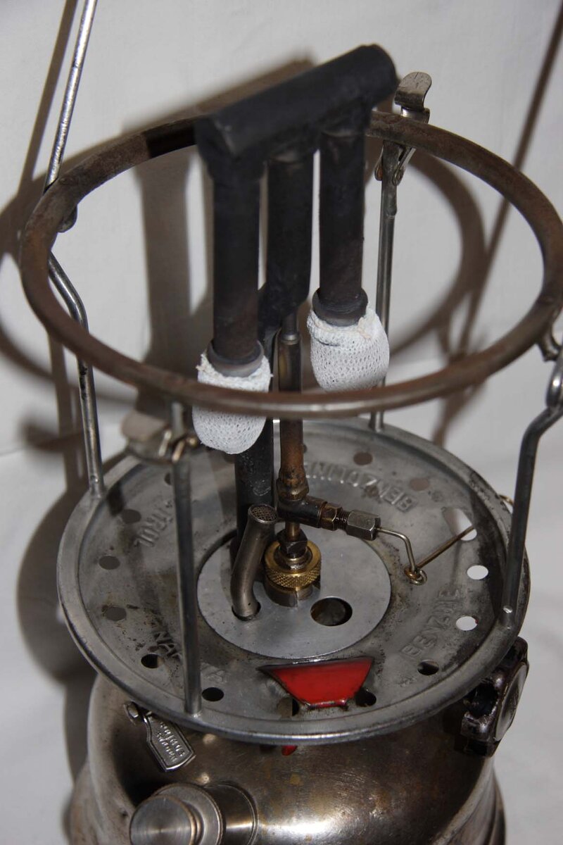

    It's actually just a line of carbon. For some reason it wont burn away and has been there for some time. These are still the mantles that were on the lamp when it was bought, so who knows how old they are. Still going strong though.

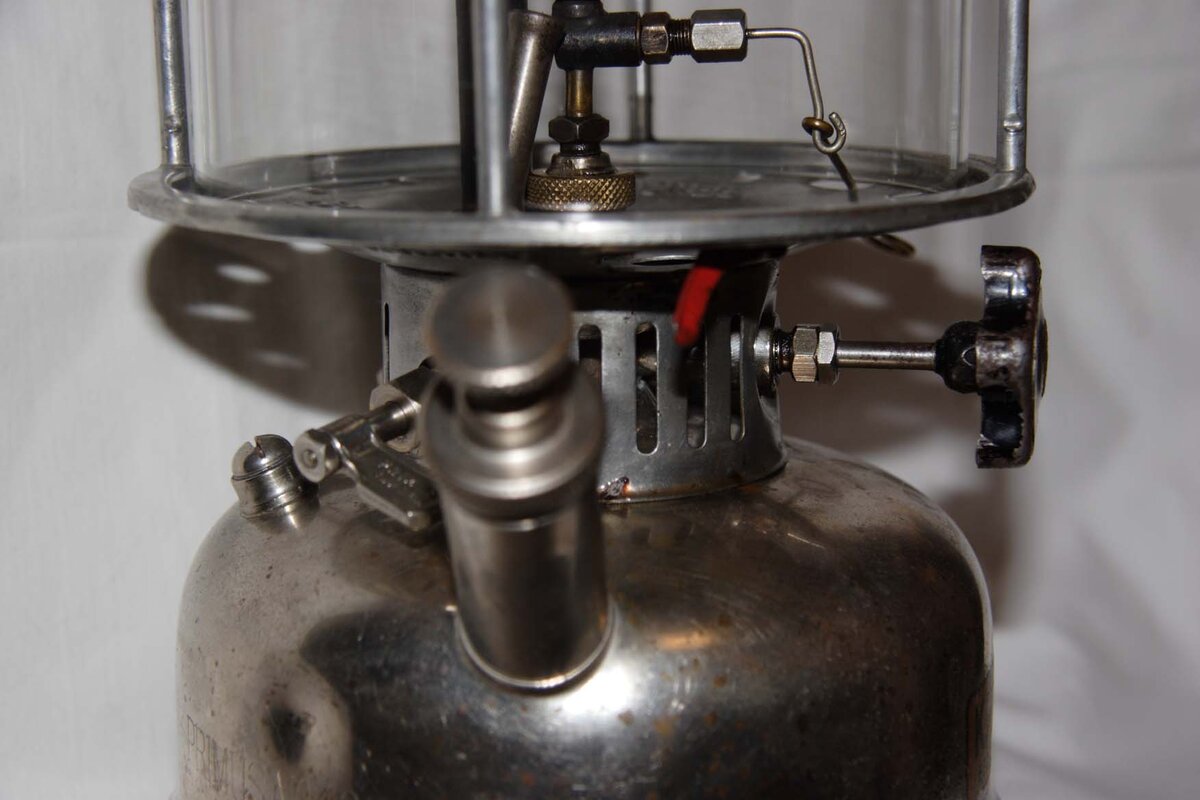

    A very fine lantern indeed. Interesting way to adjust the needle is that the original way? Or was that an addition using a different generator or a vaporizer as it may be called over there? I’d be interested to find out it reminds me of a Coleman generator vaporizer if it isn’t one

    @Stovie21 The burner assembly and generator are all Primus. There were two generations of the generator for the 1051. The first one was almost identical to the Coleman R55, but this second generation one is a bit different. It can be disassembled and the larger diameter of the tube probably helps with the vapourisation of the fuel. All the 1051s had the long wire to move the cleaning needle arm.

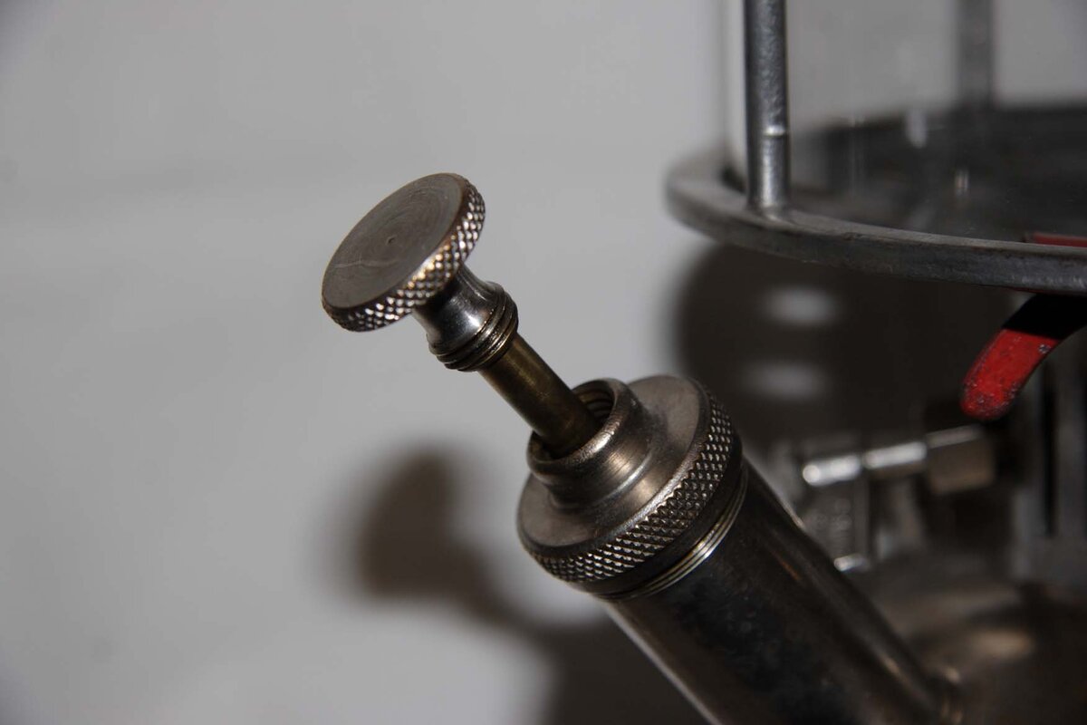

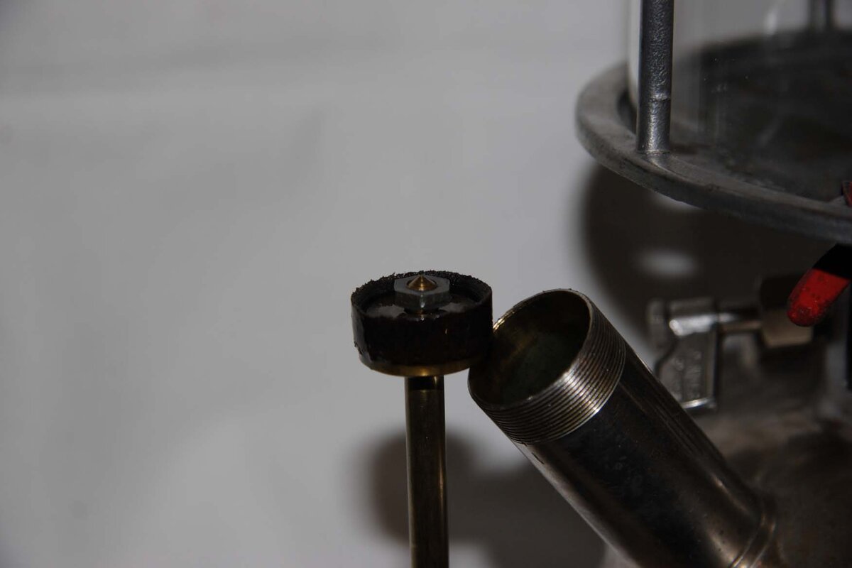

    The pump uses the standard NRV design but has a larger diameter. To ensure positive closing, they have a screw down pump cap that forces a conical end of the pump rod into the NRV hole. Simple but effective. The pictures aren't the best, but I hope you can see the details.

    The 1051 was in production until 1950. A couple of the differences between how it would look in 1939 (AD) and 1950 (AO) is there are only six 'knobs' on the valve wheel instead of 12, and the handle only has a kink in the middle instead of the loop they used earlier.
