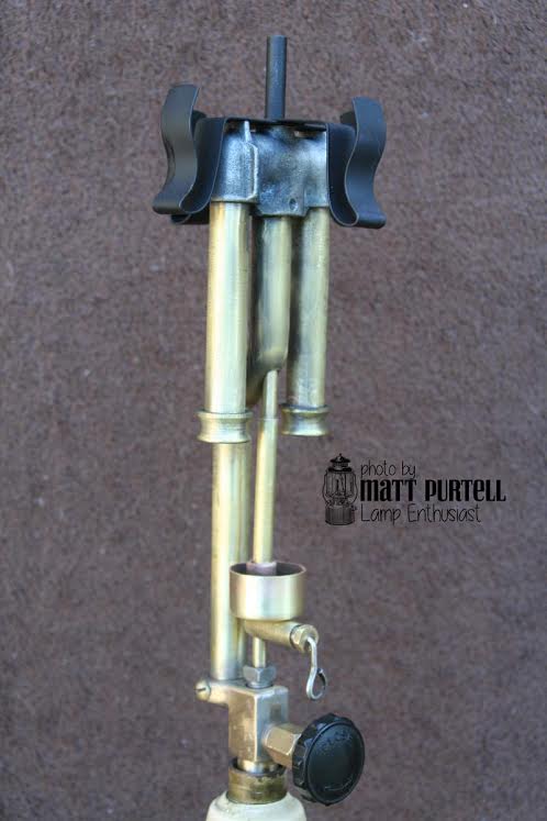

    G'day all,
    This is my 159x. I've just finished cleaning it up. I'd like to find a finial and shade someday.
    1434700619-159full.jpg 1434700626-159globe.jpg 1434700632-159globe2.jpg 1434700638-159middle.jpg 1434700645-159side.jpg 1434700612-159center.jpg 1434622143-base159x.jpg

    Hi Matty,
    Very nice restore! A few of mine also had severe paint loss, and I ended up polishing the brass instead of repainting. One had a charred wood handle which I sanded and varnished. The brass and natural wood look good together. Your reversed handle is easily rectified; you may want to use a drop of sealer on the valve thread to prevent leaks rather than tightening it too much as the fount end of the riser tube is soft soldered (and threaded) into the fount bung. I think the globe on your lamp is quite an early type. The later 355 globes have a more rounded (bulged)side wall and slightly smaller opening at the bottom, and have the green sunrise logo. Either way; scarce and fragile, so hwc ;-)

  6. Matty
    Mar 22, 2015
    2,376
    Queensland, Australia
    Phil,
    Thanks a lot for the reply, very informative. Thanks for the info on the Globe.
    Phil, I was interested in what you had to say about the 'wood' handle. When I first got the lamp I assumed it was wood. However, when cleaning it to replace back on the lamp yesterday I get the feeling it's some type of plastic.
    If it is plastic, would you suppose it may be a later replacement handle? Or, was your wood handle an 'upgrade'?

  9. phaedrus42
    phaedrus42 Subscriber
    1,954
    I've not heard of a plastic handle on those. The wood on mine was a light colour under the charred paint and I happened to have some old oak stained varnish handy. It's a little out of round but it works well enough.
    As you can see I use Veritas gas globes on mine, and keep the original globes safely packed away.

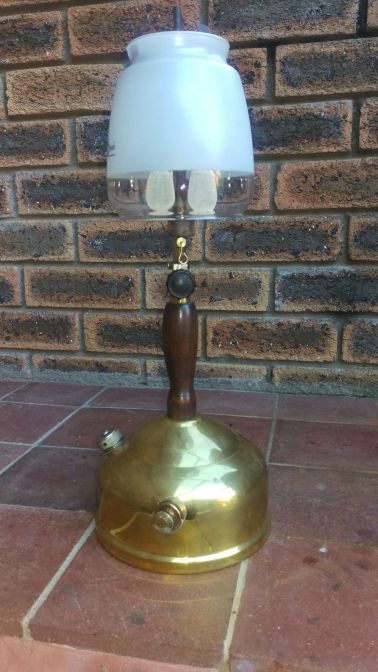

  11. phaedrus42
    1,954
    Hi Matty,The colours in this pic are fairly accurate (gold sprayed over cream):
    And the finial on the wire frame & shade:

    Phil,
    Good grief they are terrific photos, thanks. I have long wanted to see such a photo of your second picture. I have made an offer to a seller for a parchment shade that I think dates to the '40's.
    My handle looks the same as your one. Perhaps the paint is such a good job I just thought it was plastic. It is 2:30am here, I'll check it thoroughly in the morning - daylight.
    I've tried my best to determine if it is wood or plastic but I can't for sure. I don't want to mess with it too much as it's in very good condition and I don't want to damage it.
    If I had to bet my life on it and pick one, I'd probably opt for plastic - or would I, I just don't know.
