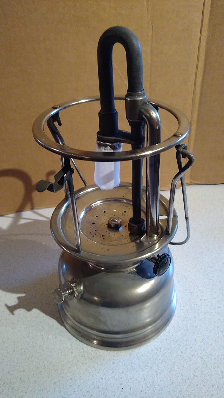

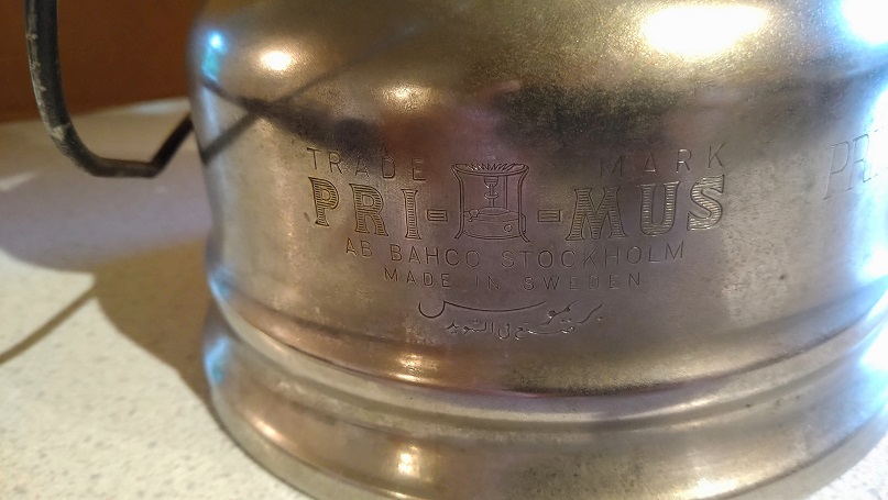

    An AV2 1956 Primus 1020 Straight-Vapouriser Storm Lantern.
    The last variant near the end of production of these workhorses :content:

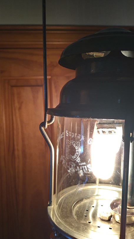

    Came as a runner (just), using a tilley preheater which was very effective. the mica has bad cataracts so a Suprax glass has been substituted for now (would Mica still have been an option in 1956?)

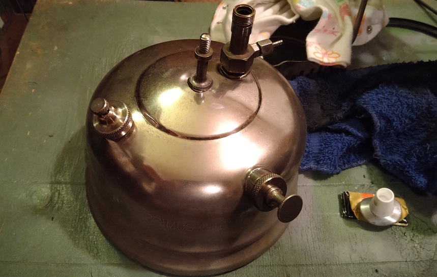

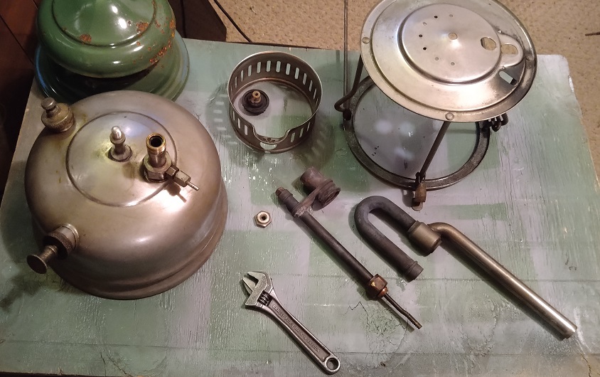

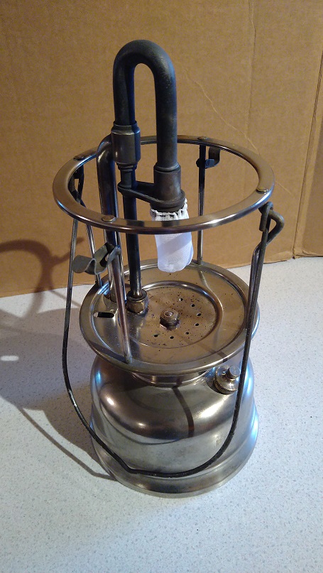

    Stripped for a thorough clean-out. Lots of carbon in the vapouriser, it cleaned up nicely and easily! :D

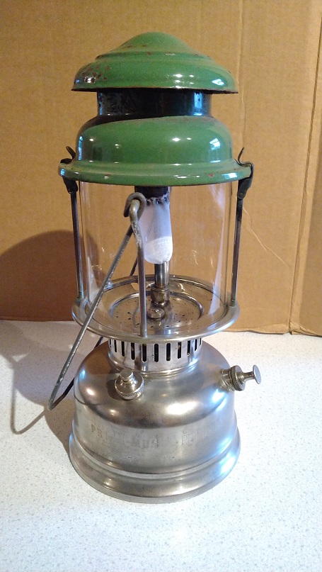

    Reassembled and fitted with a Peerless 24A.

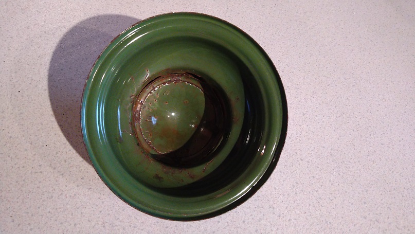

    Hood in very good condition!

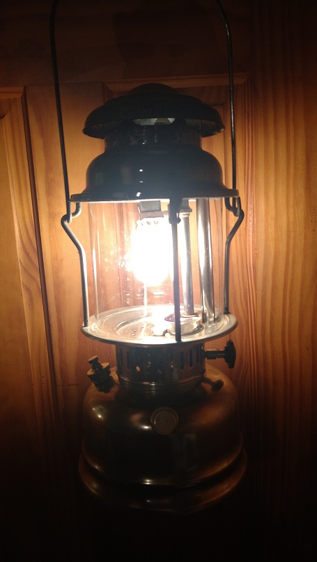

    New mantle burned-in and running well.
    I have around 10 hours running on this lamp so far and I'm impressed with its light output and stable running, easy to see why they are so common/favoured :content::thumbup:

    Is the nut holding the glass cage to the tank the original (for you)? This is the nut used on the 1060 and it is the first time I have seen one on a 1020. Maybe at the end of the 1020 production they ran out of the correct one and used what was at hand.

    Well Spotted Nils, I noticed this anomaly as well :-k
    Its certainly the one from this lantern. I checked the others I have (X, Z, AC) and they have the usual "Dome Nut" for want of a better phrase.
    Feel free to send me a 1060 for comparison purposes, I'll cover the postage, its a hole in my line-up anyway ;) :lol: :mrgreen:
