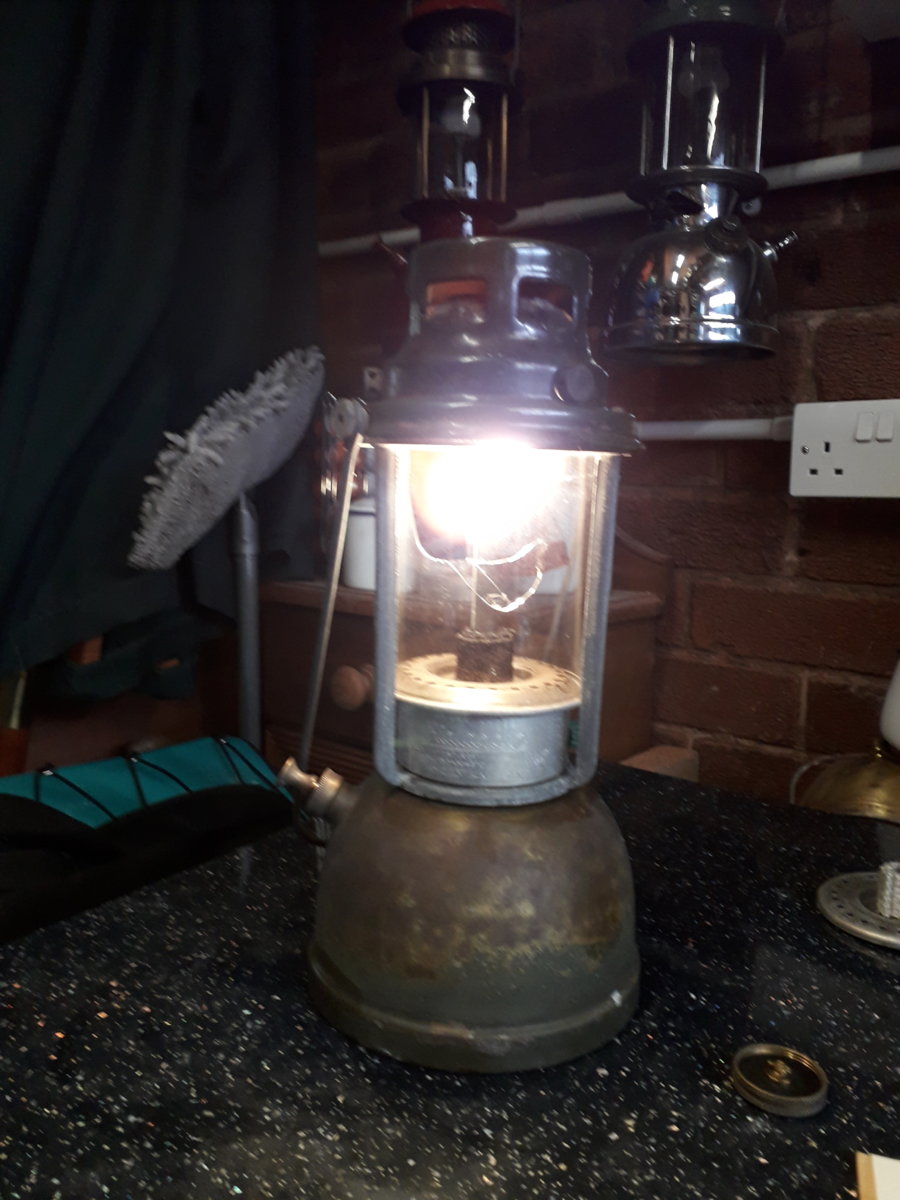

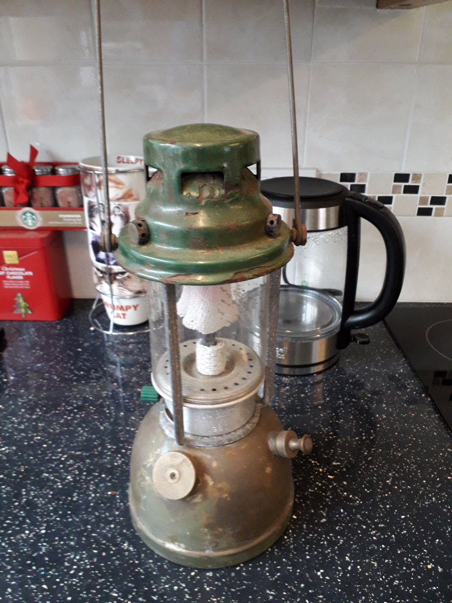

    1960 Military 305 picked up this morning, a local item for collection only and very cheap!
    Been after one of thrse for a while, just need a decent 310 at a reasonable price now to complete my Bialaddin collection.
    Glass was broken, hood not perfect but serviceable, the lamp otherwise looked little used. Lamp pressure tested successfully after fitting a spare fuel cap as the one fitted had a broken off release screw. Next step was a test lighting, on filling the spirit cup I noted maths all over the tank I then discovered that the aluminium spirit cup / diffuser was fractured and someone had attempted to repair (unsuccessfully) with araldite which explains why the lamp has been little, if ever, used, the wick actually looks new.
    Spare (incorrect type) plated spirit cup fitted, a bit more maths, a match and a couple of minutes later:
    It's still running 2 hours later sat on the garden table.

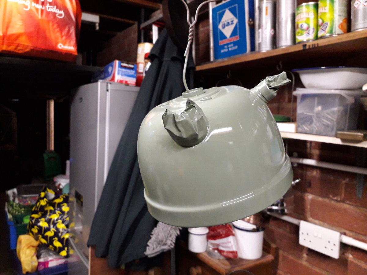

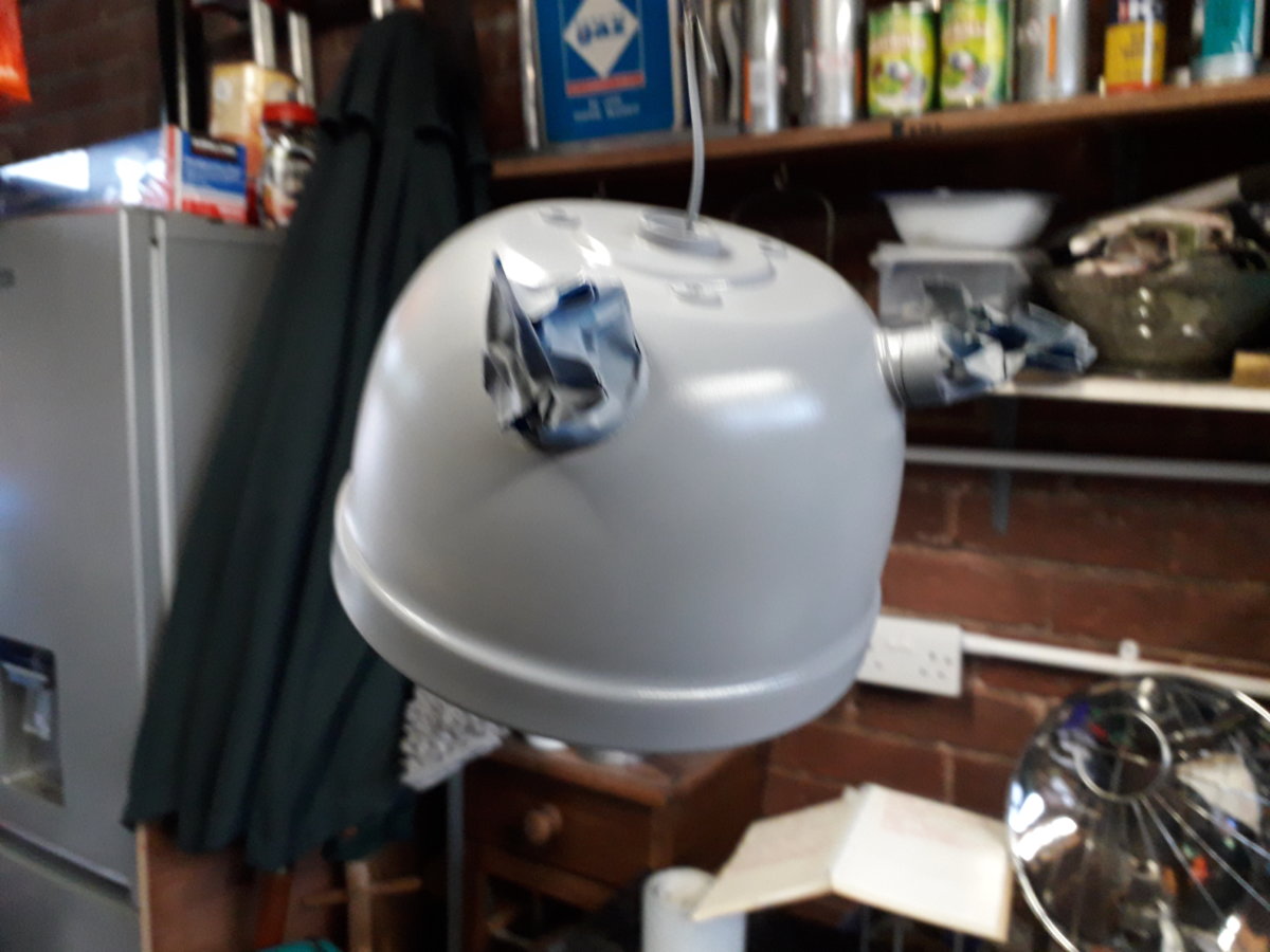

    Never had any problems as I only lightly spray the top, I use a coat hanger to hold the tank whilst spraying and then to hang it up to dry.
    Primer applied:
    After 2 coats of Ford Highland Green:
    A bit lighter than the original army olive green but I am happy with it. Note the coat hanger inserted in the control cock hole which provides both a good hold whilst spraying and a convenient method of hanging the tank up to dry. Just out of view below the tank is one if my trusty 300x's providing a bit of gentle heat to aid drying and prevent blooming of the paint as it's very damp here in Liverpool today.

    I have a scrap Tilley vapouriser in an aluminium control cock which I use when spraying tanks. The cock screws into both Tilley and vapalux/Bialaddin tanks so can be used for either. I drilled a hole in the top of the vapouriser and use wire to hang it up. It can be used for table lamps too, which can prove difficult with other methods.

    Screw the screws into their holes and then you don't block them with paint and also get the heads painted at the same time. I generally use a suitably sized cork in the control cock hole but I'm currently working on a couple of ideas; one, something slightly along the lines of what Matt suggests...

    Each to their own, I have a pet hate of painted screw heads!
    I have done a lot of spraying and if you spray across the top of the tank at about 20 - 30 degree downwards angle and not directly onto the top face i find that very little paint gets onto the thteads.
    Going to have to spray it again as the colour is definitely too light, been looking at bs381c colours and it looks like Aircraft Grey / Green is the closest match to the original paint on the bottom of the tank, have also found a company that can supply this colour in aerosol, will get semi gloss finish as full gloss will be a bit too shiny.

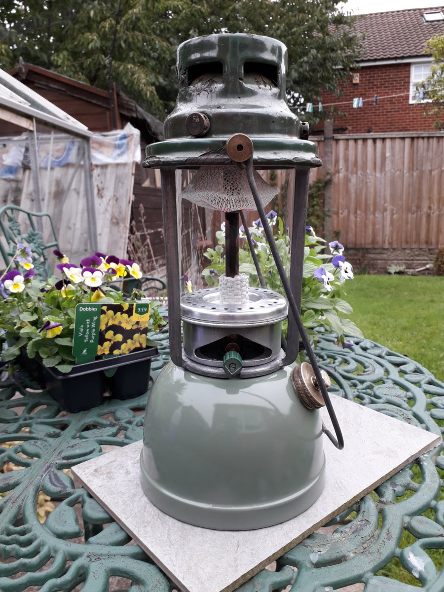

    Repainted the tank using Rustoleum Sage Green which is a close match to the original colour.
  23. DP2
    Nov 29, 2016
    206
    Liverpool, UK, Europe.
    The finished lamp
