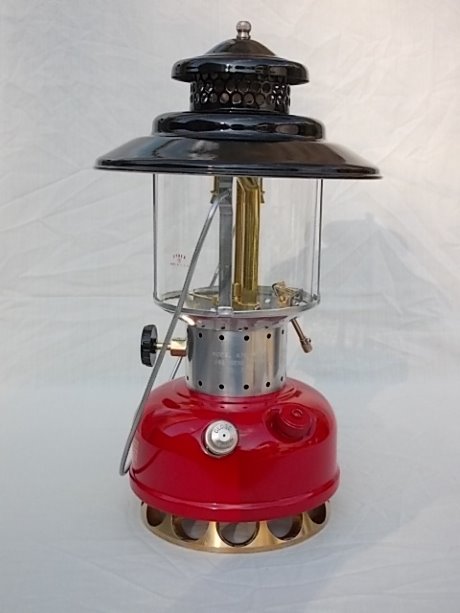

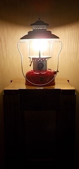

    Hiya,
    This veritable beauty wasn't "far gone" when I recently won it over in Ebay.com. I had a lot of work to do though, it turned out; this wasn't something I'd anticipated, just by looking at its main overall appearance from the out set.
    After the main fettle & polish up, the fuel/ air assy was behaving like a mad dragon, suffering no continual fuel flow, with anything deemed fit for use. As I'd fettled it first (bit of an error there), I was lucky to get some good advice from NE, USA (Cheers Dd) :thumbup: ., and suggested that if I didn't want to risk "digging out" the main valve & F/A assy (potentially ruining the tank in the process/ stuck fast in real bad, it was), the safest way first, would be to try to "clear & irrigate out", all the lower detritus & oxidization, most probably causing the foul up !
    Using some potent "rust remover", I seeped plenty in, down the main valves (bare) "thimble cup res", spending many hours before, beginning prior, totally masking off the founts fruity & pristine paint work. The safety masking/ de-masking, in between all the different cleaning/ application processes, is what stretched out the main brunt of the work; but it was essential if I was to do no damage, to what had miraculously lasted 50 yrs, without much 'a do' !
    Pressurized air canisters, helped "blast out" what ever there was left in there, "sticking" the torsion coil spring, to the F/A's clearing rod needle. After all that, I gave it a good "flip soaking" in Marine Clean degreaser solution, as well as adding to this some small nuts, screws & pebbles, to shake out & knock off any obstinate portions, still reluctant to break free.
    When it seemed as clear as I could get it, I then fully dried the fount unit out, then proceeded to "work" the main, off/ on valve wheel (repetitively), with the fount half full with kero. I've purposely missed out a lot of the "other stuff" I also had to do (too long a type, ect), but basically after the "kero" had lubricated the F/A's workings, freeing it up much more than before, I did the same thing with "Naptha/ White Gas", only I fitted the generator back on this time (minus the stuffing), just to "see & hear" how/ if, the system was faring any better ?
    I'd not spent as many days (if not weeks), meddling around with a 'problem lantern' like this before, but all the effort, on that "second fire up" attempt, proved to have just done the trick; the lantern didn't "conform", on the "quarter turn", at first, but taking it near to a "full turn", time & time again, I found on each subsequent "light up", it successfully pre-heated, nearer back towards its preferable quart turn dynamic ? It could possibly have just been acclimatizing & re-setting itself; if not that, possibly it still could have been burgeoning itself of more grunge, clearing free from the F/A assy ?!
    Mighty fine though now, lights every time without fail, & the brightness from the Sears mantles I attached, was just phenomenal ! This one's a very quite burner, which has me suspecting "something's" still not quite right ? 'It hasn't spluttered, threatened back up or fluttering' at all, the clearing assy works sweet enough, "no tightness, requiring resistance on swivel turn"; I'd suspected it could have been a "reject", as there was quite a few parts, during the fettle up, that were marked with flaws & irregularities, I'd not seen or noticed that much before, with all the other US lanterns I'd worked on (this may be more usual though, the many score thousands, manufactured) ?
    Well, for one thing, that could explain why it appeared almost "brand new" on receiver ship; it mightn't have been lit more than half a dozen times, if that; the burner & generator were very clean, up top, & the only real damage, aesthetically, was to the underside of the collar, where the paint had been slightly marred & coursed, whilst being sat all those years.
    "Enough of the rabbiting then, here's the new look lantern", I like it a lot, finally ! "phewww, hard work, that one. . . . . . . " !
    I hope this 6th one loads ?!
    Cheers,
    Jon :thumbup: .
  2. kerry460
    kerry460 Australia R.I.P. Subscriber
    305
    Launceston Tasmania
    G,,day Jon . it is a pretty lantern .
    red , black and chrome goes together nicely on that .
    I did wonder in the first couple of photos about the strange base .
    then realised it was something you had it sitting on .
    a very nice lantern .
    cheers,
    kerry

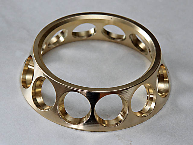

  3. Jean J
    2,101
    What a great job you've done, gorgeous lamp. I fancy one of these bases. Saw one recently at a vintage steam rally but was told that even if I could lift it I couldn't afford it! Pity.
  4. kerry460
    305
    Launceston Tasmania
    G,,day . could you please post a photo of the base , and tell me more about what it is etc .
    cheers,
    kerry
  5. Lamp Doctor Australia
    Jan 3, 2013
    622
    Geelong
    Kerry.
    Its a brass bearing carrier
    Bob .
  6. jonathan fairbank
    Jul 17, 2013
    238
    Hi Kerry,
    Christer knows what type of machine it is used in, something to do with a Hydro plant, there's his explanation somewhere within the site, attached to one of my own lanterns/ lamps Gallery entries. It's a large ball race (I thought), I paid a fiver (£) for it, pulling it out of the local scrap yards 'brass box'.
    If I aren't beaten too it, I'll take a couple of snaps, then load it for you a.s.a.p.
    Cheers, Jon :thumbup: .

  8. kerry460
    305
    Launceston Tasmania
    G,,day . thankyou all for what it is .
    know I know , it is so obvious .
    :content: :content: :content:
    cheers,
    kerry

    Very nice lamp Jon. Good find and well-restored. I like those Big-hats a lot. Nice decalls and enamel. Lucky you - Again :mrgreen:
    Claus C

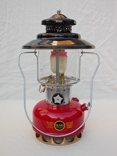

  11. mr optimus
    360
    Hi jon what beautiful stunning lantern, you have done a first class fettle bringing it back to perfect working order well done there

  13. jonathan fairbank
    Jul 17, 2013
    238
    Thanks Mr O' !
    I've only just noticed the skew whiff Big Hat, in most of the scans (crumbs). I bet you can tell what happened there ;) ?
    Jon :thumbup: .

    Yes Claus, cheers for the praise, this lantern really took me to the wire, in more ways than one; I was just so really pleased when I finally had it lit up properly. The first 'light up', after the initial fettle, was a complete nightmare; all most a complete fireball, yellow flaming, higher than a metre North, then when I'd cleaned it all off, trying again with it; one of the mantles just "popped", channeling blue jet, directly into the base tray :rage: . (Close call, I used a spoon to deflect it) :idea: !
    Got it going though, eventually, which is what counts, mainly (as well as the fun, also) :) .
    Jon :thumbup: .

    Another stunning restoration Jon, :thumbup: :thumbup: :thumbup:
    This lantern looks better than it when it left the factory. Your attention to detail is incredible, as well as your patience in getting the F/A system working. Sometimes mint looking lanterns when received are hiding some difficult problems. Just when you think you've found a runner, you end up spending a week getting it to work right. But your end result is worth it.
    Three cheers for the Big Hat and with a color combination that's hard to beat.
    Dan
