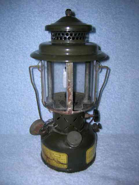

    This is the infamous 5cp version which I pulled out of my storage unit today. I'll give it a good looking over in the morning to see if I can locate and rectify the problem... [-o<
    (Edit - I've dismantled the lantern and the problem turns out to be the gas tip which is now completely blocked - presumably it was merely partially blocked when the lantern was 'running' at Newark. That's a poor show from a new generator with, maybe, a total of 15 minutes running time, which has never worked properly from the very beginning - bah! :evil: )

    1. I aligned one of the globe cage uprights in line with the knob (as seen in the first image above). Then I aligned the burner at 90 degrees to the block to which the vapouriser attaches - that brought it in line with the globe cage. I just doesn't look 'right' at the bottom, though:-
    Is this OK?

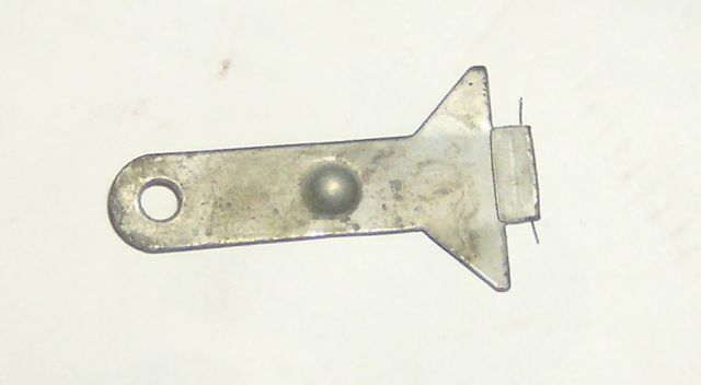

    Yeah I don't have the wrench but at least I have the pricker. I got it with a Junk 1945 AGM MilSpec with a bad fount. here's what it looks like: 1294605115-milspecpricker_opt.jpg

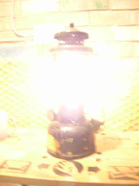

    Did Mr McRae refer to my Milspec somewhere as 'a bit of a dog', [-X or did I dream that? - can't find it anywhere... :whistle:
    Woof, woof!
    Actually, it still wasn't burning properly with flames outside the mantle, but it did manage to baffle the auto exposure on the camera. It also managed to attract a moth! - not bad for the middle of January in the northern hemisphere!

  8. Mackburner
    6,884
    Well that is certainly doing a bit better. Probably work OK without the gauze but that is normally there to prevent a burn back into the mixing tube and I guess there should be a screen of some sort in te mantle carrier.
    Removing the air plug might be worth a try but doubling the air is not likley to improve the burn. More likely to give mixture problems and a yellow burn. You have to understand that in all lamps the air intake is restricted to achieve the correct mixture. The effect of too rich or too weak gives the same symptom of a yellow flame burn. ::Neil::
