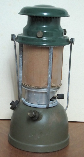

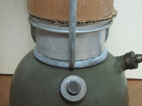

    here is an IDF (Israeli defense force) issued lantern.
    this one is not marked with model number and marked on the hood.
