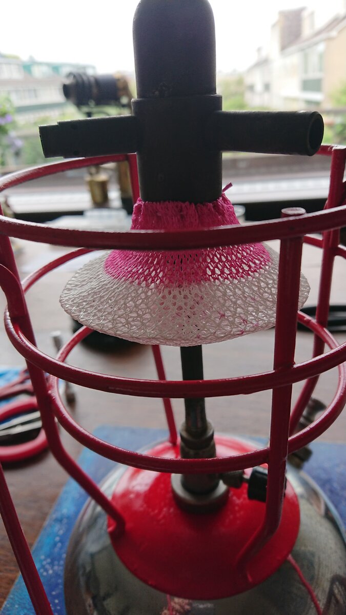

    I posted a thread a while ago about using Butterfly mantles as double tie mantles by un-stitching the sewn end. What might not have been obvious, particularly for new lampies, is the different methods of tying mantles to the burner assembly.

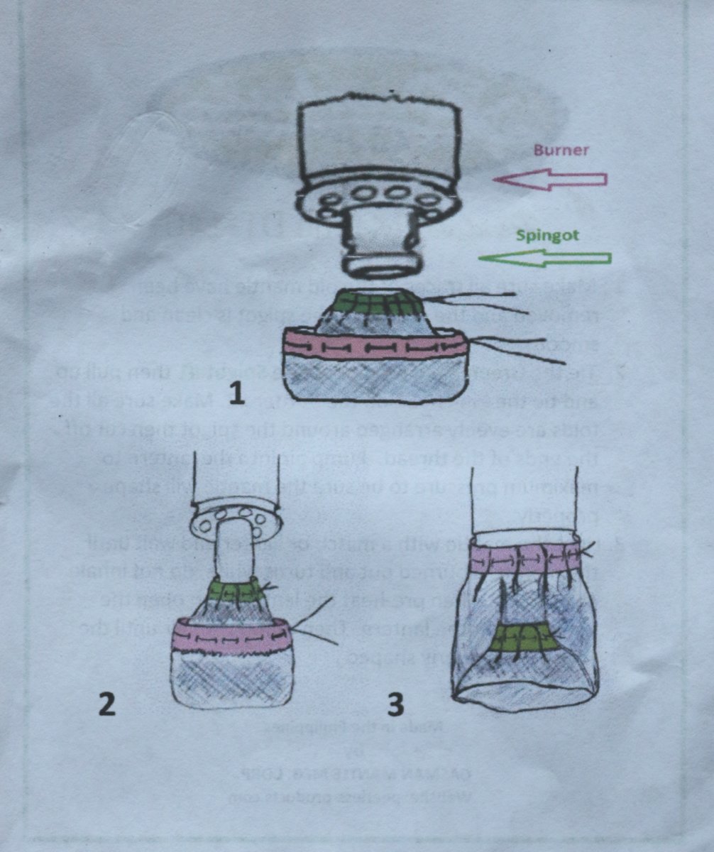

    On the back of Peerless DT 140s, there is a diagram that shows the method they favour like this...

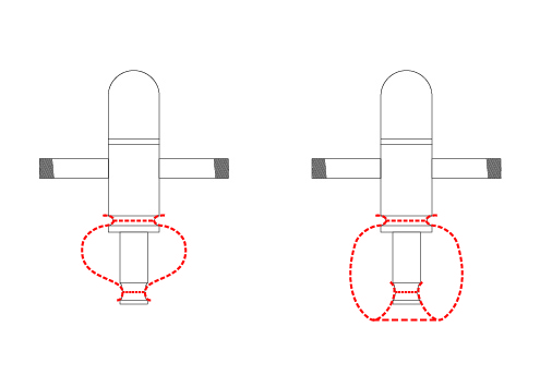

    This is a little different to how Tilley shows how their 164 X mantles, so I drew a diagram that attempts to show the two methods side by side.
    When I use Butterfly mantles as double ties by undoing the stitching a the bottom seam, I use the method on the right as these mantles are a bit larger. I'm sure others my have a different opinion, but I think the second technique gives a better shape when the mantle is 'inflated' for the first time and forms a greater surface area.

    “Spingot”?

    I don't know how many DT 140s Peerless manufactured but they really should have got someone to check them for typos! I was going to redo their diagram but in the end I figured I'd just leave it as it was. I don't want to be mean but it looks like a 5yo drew it, although you could argue it has a simplistic charm.
  5. phaedrus42
    phaedrus42 Subscriber
    1,936
    Colin, If you volunteer to update the drawing and instructions, I can ask the new owners of Peerless to use your artwork on their packaging for the DT-140.
  6. ColinG
    2,664
    Definitely! I almost re-drew it anyway rather when I took a photo. I was always doing this when I used to be the marcomms manager at the company I used to work for. I'll do it now even if it doesn't get used, I don't mind as I love using Illustrator.
  7. ColinG
    2,664
    My version...
  8. MYN
    1,315
    Very well done with the Illustrator, Colin. But as you had guessed, Peerless' diagram does have some sort of simplistic charm as it is. My opinion is just the way the new owner(s) incorporate some cultural tastes or styles to blend into its current place of origin.

  10. AussiePete
    2,488
    The diagram is very clear and well done @ColinG
    I will be using your method on the larger mantles in the future.

    If you want to experiment, you can use the same technique with cheap Butterfly mantles by un-tying the inside seam and using a freezer bag twisty tie to fasten the loose end to the spigot.
