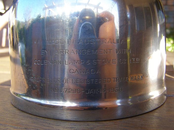

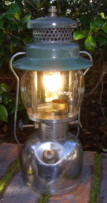

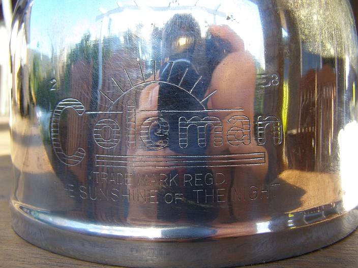

    This 249 was made in Australia under licence of the Canadian factory. You can see the date numbers are stamped above the logo Feb 1953. The country of make does not feature under the logo.
    The globe is by Austramax so am taking it that this was the Australian firm who made it under licence.

    It's in fine condition and I had not seen that stamping before.

    I wouldn't use the globe as an indication of where it was made (even though I think you are right). The Austramax globe is the same size as the Coleman globe so this could be a later replacement after the original broke.

    Research I have undertaken reveals that Austramax did make Coleman 249s under licence. Certainly Austramax lanterns globes are a matching size. Given globes are interchangable, the only way of knowing if a Coleman or Austramax globe was fitted when sold, would be to find an advert from that time.

    This is the first time I have seen an Austramax globe on an Australian Coleman. Most of the ones I have seen, with presumably an original globe, have had an English made Coleman globe.
