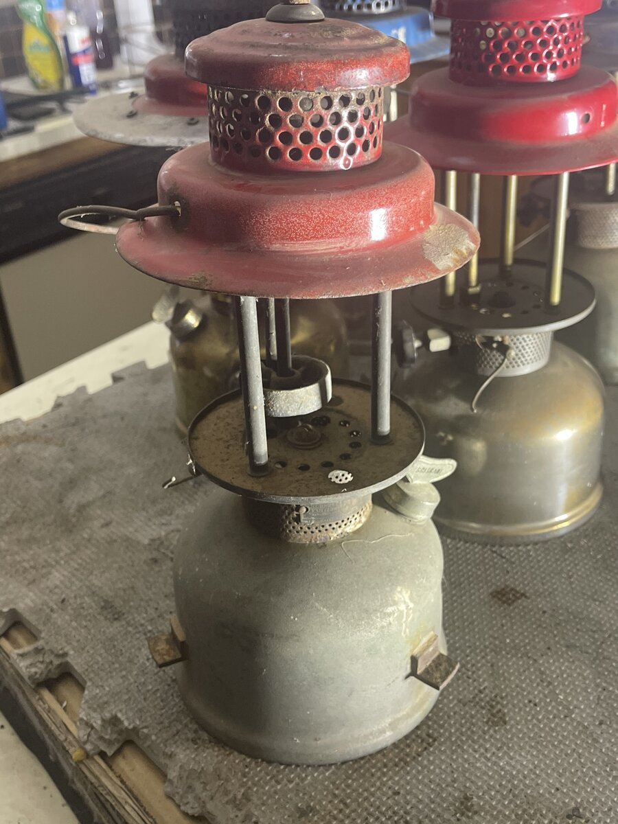

    This is my newly aquired 2nd generation military Handi kero pet. Very cool and very excited 20190909_165130.jpg

    3,988
    G'day Darryl, I'm not sure it's original. It looks to be Swift Lite from the collar up but mounted on a Kero Pet fount.
    Having said that @Tony Press showed me one recently in the same configuration.
    Are they transition or rebuilds? Don't know. :-k
    It's still a good find and should clean up nicely. :thumbup:

  6. Nils Stephenson
    3,303
    It is understood that this is the second variation of the SwiftLite. The first had the tank with the combination filler and pump. The second had what would become the KeroPet tank. I believe the handle was different as well, but havn't seen enough of them to be sure.
    As far as the military having used them, I have no idea. It's quite possible as they had lots of different gear. If they did you would expect to see more of them today, but they are pretty thin on the ground (painted green or not).

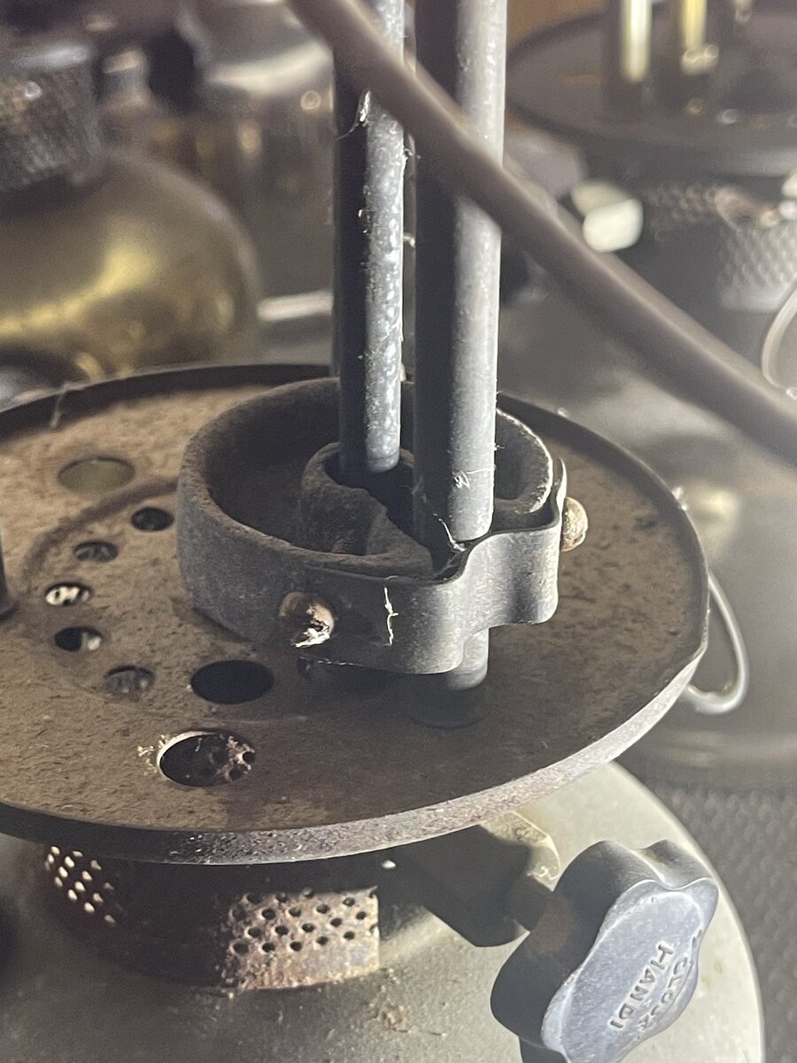

    Three questions about this lantern:
    1. Is the tank steel or brass?
    2. Does it have a label?
    3. Does the spirit cup have a full hole for the generator, or is the gap where the generator fits continuous to the outside edge where the air tube fits?

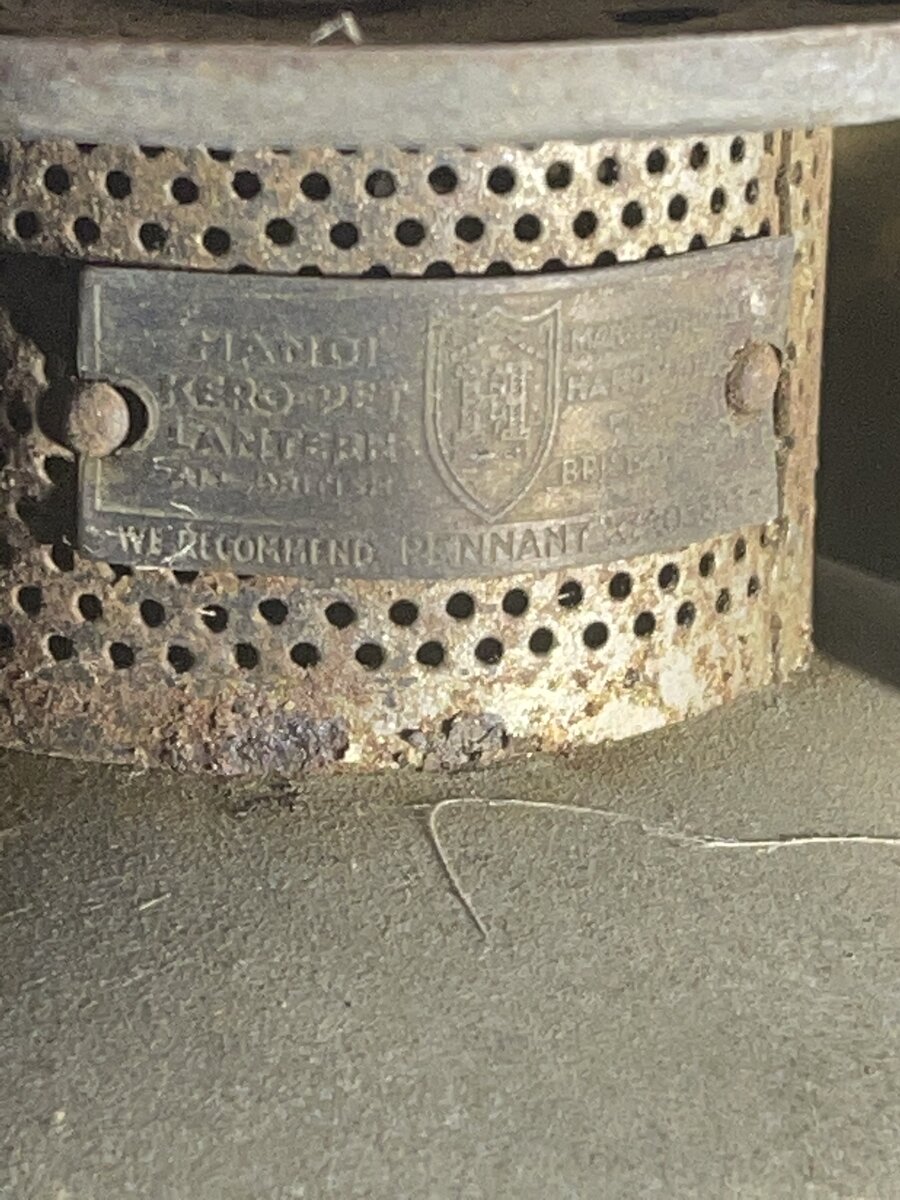

  12. Darryl Durdin
    1,563
    @Tony Press , I’ll get it out and check it out tomorrow .I will get back to you all. I have v1 and v2
  13. Darryl Durdin
    1,563

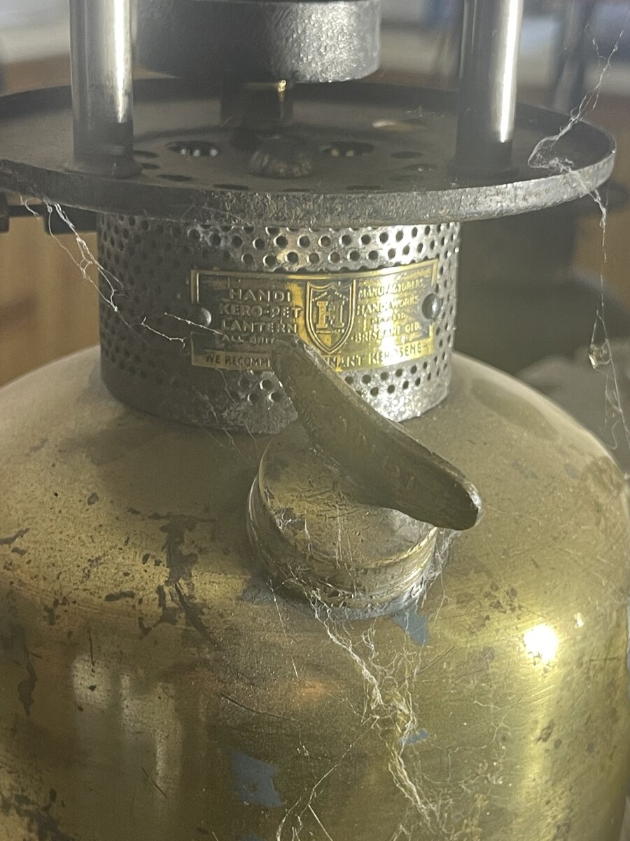

    Hello Tony. The lantern in question has a brass tank with a steel base, I did the magnet test.

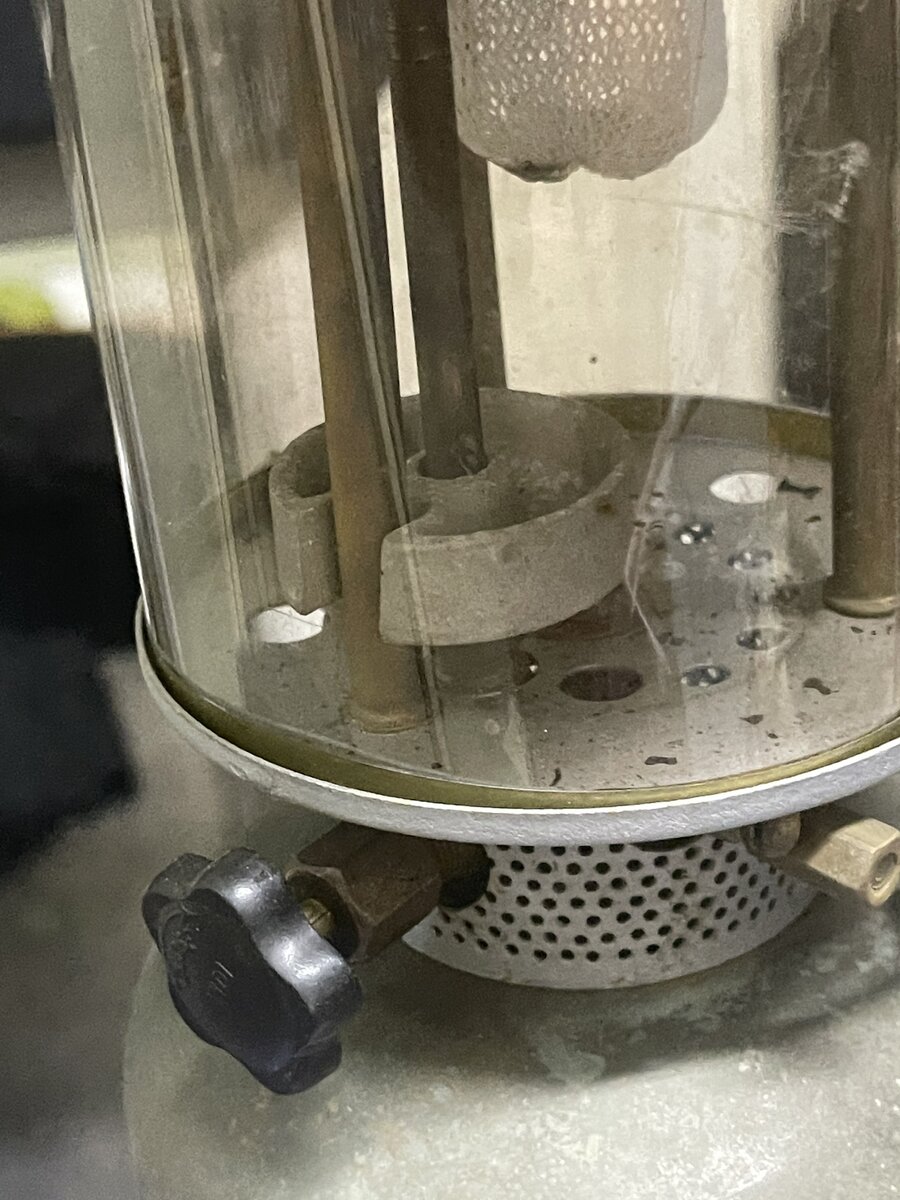

    The aluminium meth bowl has the hole for the generator as one piece. With the allowance for the air intake.
    I went about checking all my Handi’s that I can get to , they all have steel bases except for one that is a type 3 it must have a brass base.
    My v1 swiftlite do not have the Handi badges my v2 some have the badge riveted on, my v1’some are shellite and others kero the same with my v2’s.

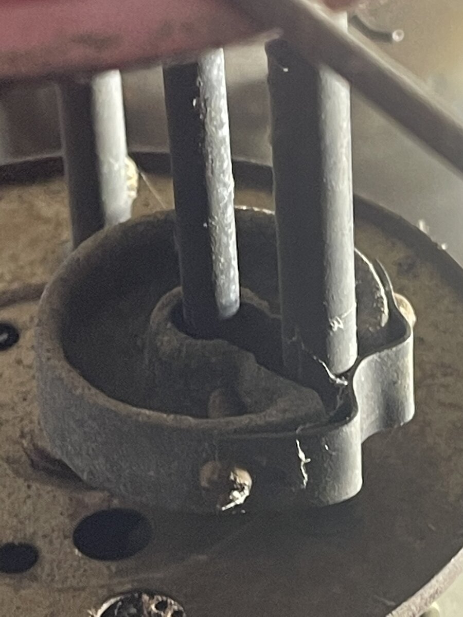

    I v2 stood out, it’s kero but the meth bowl has been altered as I’ve not seen this before, a small plate screws to the bowl and contains it to the air tube,
    I took pictures of everything I have v1+2
    this type 3 has a brass base

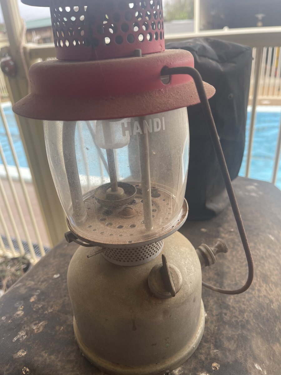

    F9F33018-6A5E-4737-A190-4EE127802DE9.jpeg 25E80B3B-9C19-436F-A826-46165AC854CB.jpeg
    v1

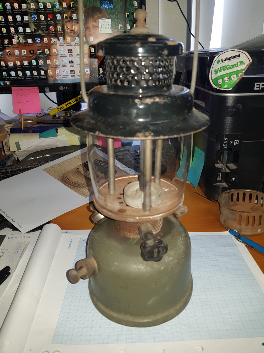

    the v2 in this picture has the army olive drab original colour,
    I have to correct myself my v1’s are all shellite,
    34054A0C-BFC9-44DE-89BD-5754193EF835.jpeg CF375F53-5820-43CD-8C4E-61CA83E8E3D8.jpeg 25E80B3B-9C19-436F-A826-46165AC854CB.jpeg

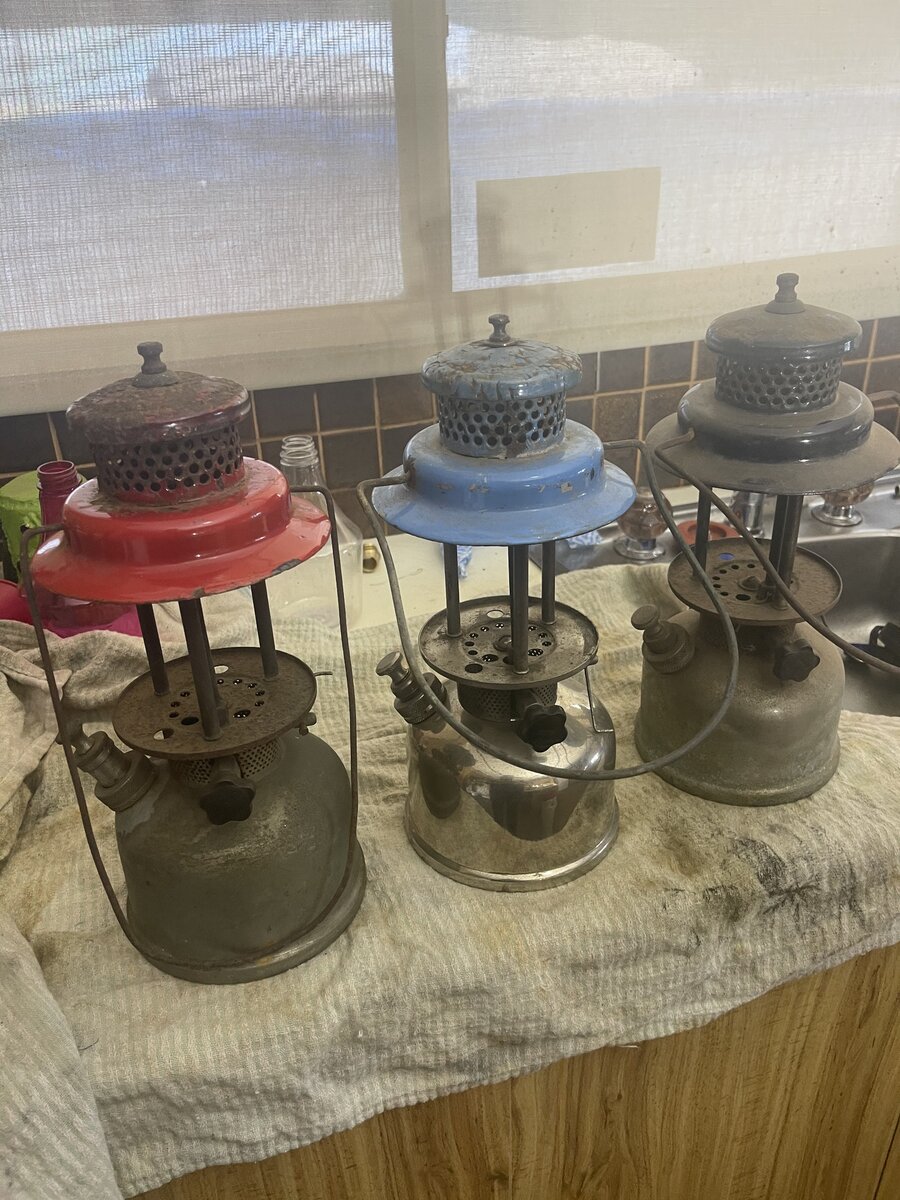

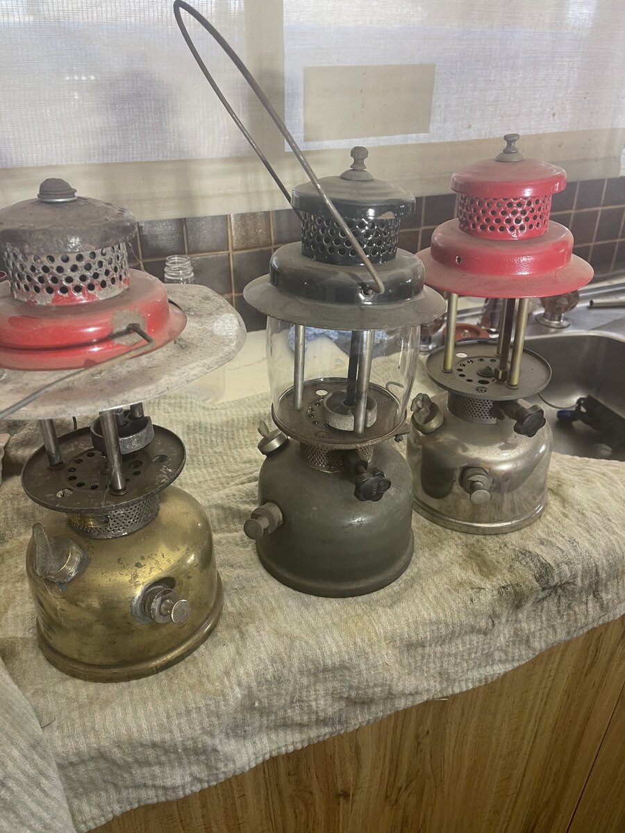

    v1’s
    FFF9DF4F-7B3A-489E-B1F9-CCE9A4B43039.jpeg 6AB5FF65-1D49-4E9E-BE25-678039A12BFF.jpeg
    the middle one is of the above original thread, it has the military olive drap tank but the hood is black. Some kero others shellite.
    4D0865C9-052E-4462-B205-01A37227D525.jpeg F3A131FB-B0F6-44CA-9FD4-DDF88D0D55DC.jpeg
    This is the v2 with the altered meth bowl, it’s had some other bits added. as found, I’ll be looking for if anything I have has a steel tank, I hope this helps you
