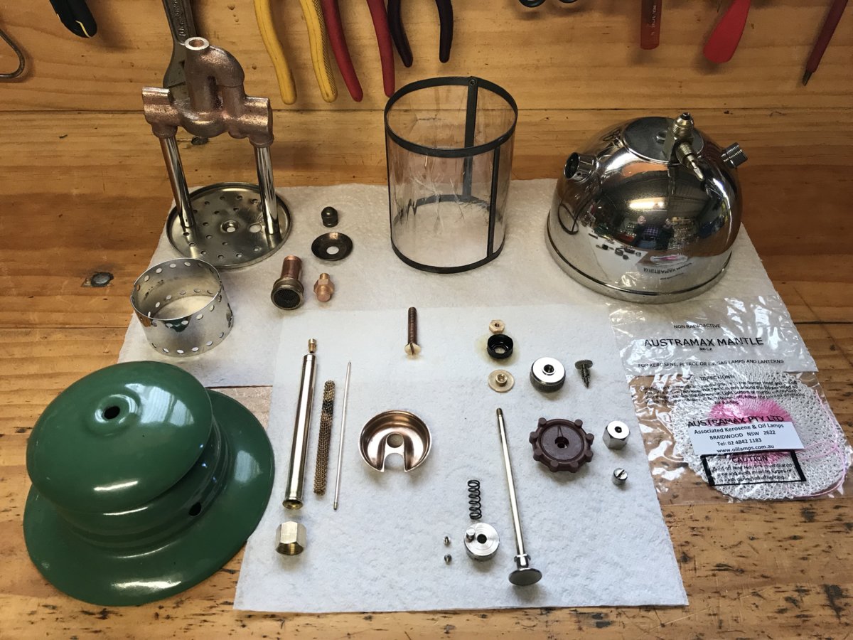

    The lamp was purchased reasonably clean and just needed some TLC.
    The following images are the lamp's parts after cleaning prior to assembly.
    [​IMG]
    The nickel plated frame rest or collar has no marking whatsoever. The fount or tank has 2 identical stampings located on the the fount on opposite sides. The hood or vent is in excellent condition retaining all of its original enamel. I reused the original leather pump cup, just re-oiled it with neats foot oil. The filler cap seal was the only part that need replacement.
    The following shows one of the Austramax stampings. You may have to magnify the image however it displays the standard Austramax logo with the model number 3/300. The fount has a brass nickel plated bottom and the fount itself has nickel plating, not chromium, dating this lamp to before 1962, perhaps this lamp could be dated before 1952.

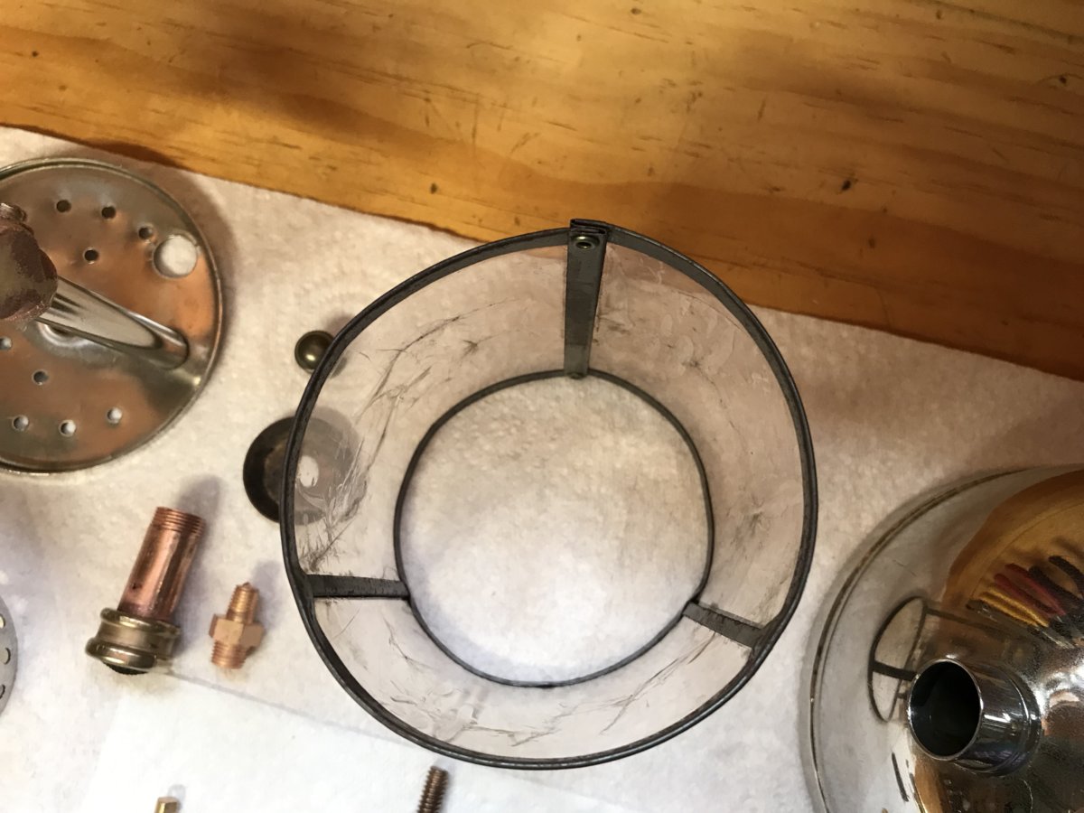

    The mica globe is in reasonable condition given its usage and age. There are no holes albeit there are some creases.
    [​IMG][​IMG]
    The lamp was assembled, and to help future re-fettles I used a nickel anti-seize paste on the threads.
