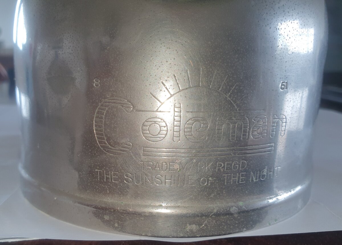

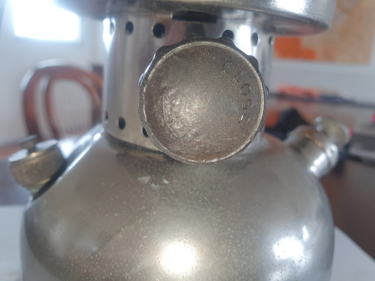

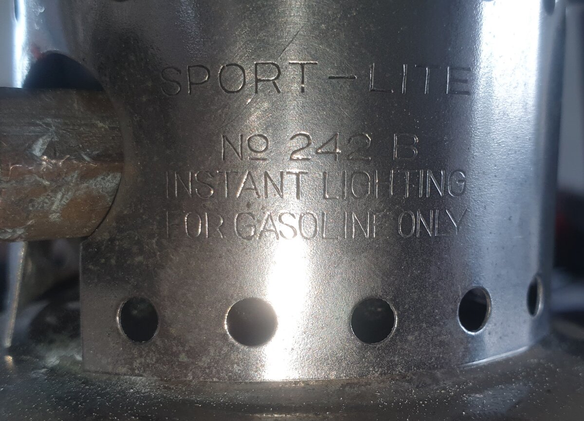

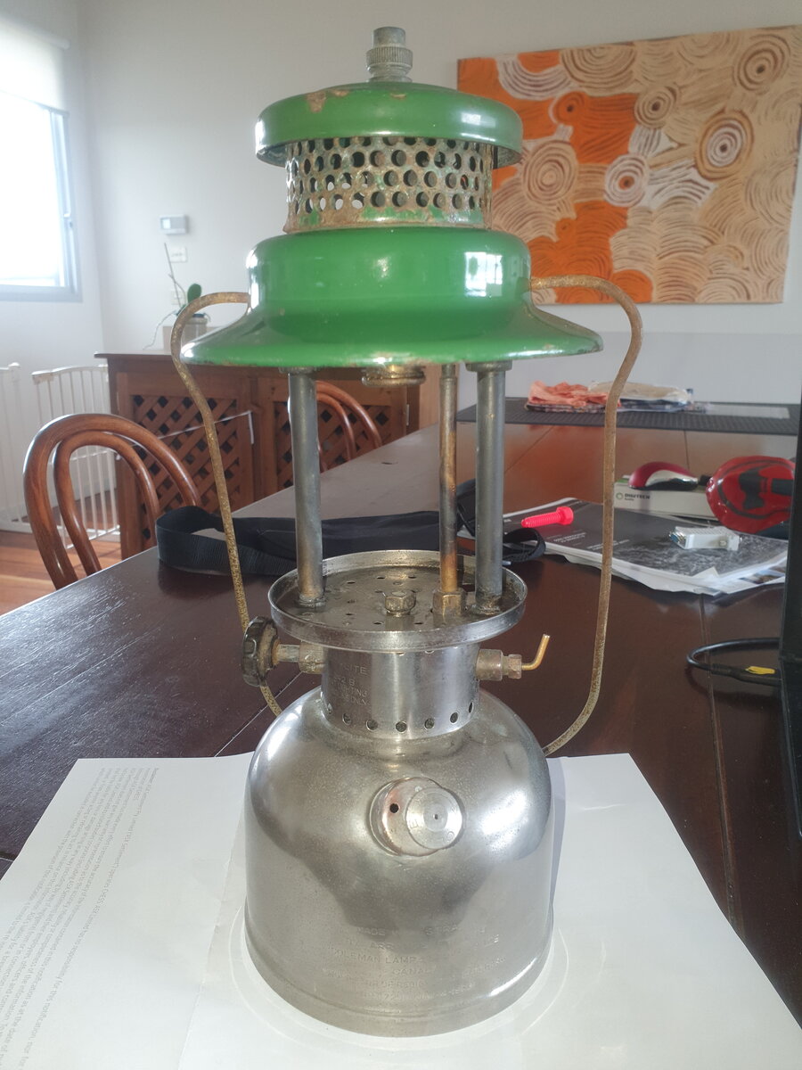

    Have completed an initial cleanup of my 8/51 242B. The fount nickel is a little marked from the shoulder upwards but don't want to risk damaging it by being more aggressive. (Long soak in soapy water then some Autosol polish as recommended on this forum.)
    Not sure what to do with the bail, it remains untouched. probably no different from most 242B except this was made in Australia...

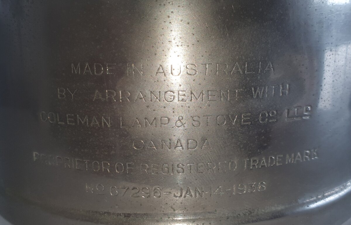

    MADE IN AUSTRALIA
    BY ARRANGEMENT WITH
    COLEMAN LAMP & STOVE CO LTD
    CANADA
    PROPRIETOR OF REGISTERED TRADEMARK
    No 67296-JAN-14-1936​

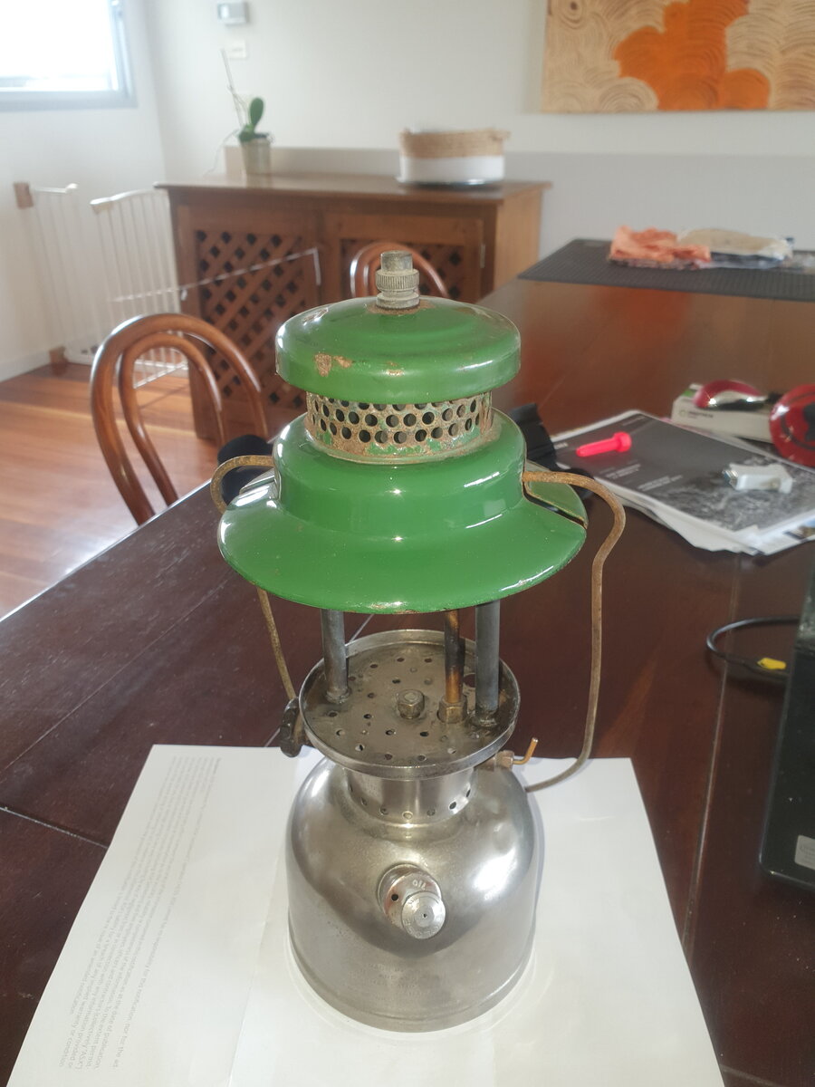

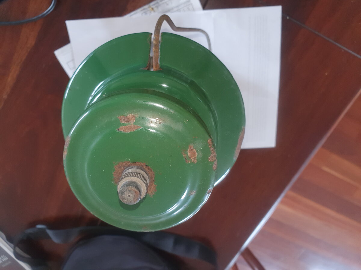

    Enamal hood has a few chips but not too bad.
    Now need to find a globe for it, preferably in Australia as postage could be a killer. Any forum members in Australia have a spare that they would part with?

    That’s a nice example of the Aussie 242B. That one would have been made in Adelaide by Colton Palmer & Preston. It’s pretty early in the Aussie lineage. The earliest one I’ve been able to track down is @Nils Stephenson’s February 1951.

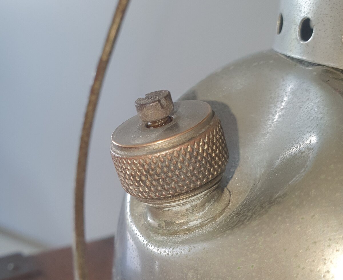

    It looks good to me. The screw on the 3-piece filler cap looks a little different from the standard round headed screws. Looks like some kind of knurled pressure release screw found on some lanterns. Its a little blurry on that area.

    I think @MYN us right about the filler cap. Can you post a photo of it? It looks a bit like an old Austramax filler cap.:-k If so, it should not be used to release pressure when he lamp is running or hot.

    Re the bail: Sand it down and if its close to bare metal, treat for any remaining rust, and then paint it with a silver or aluminium finish. Works a treat.

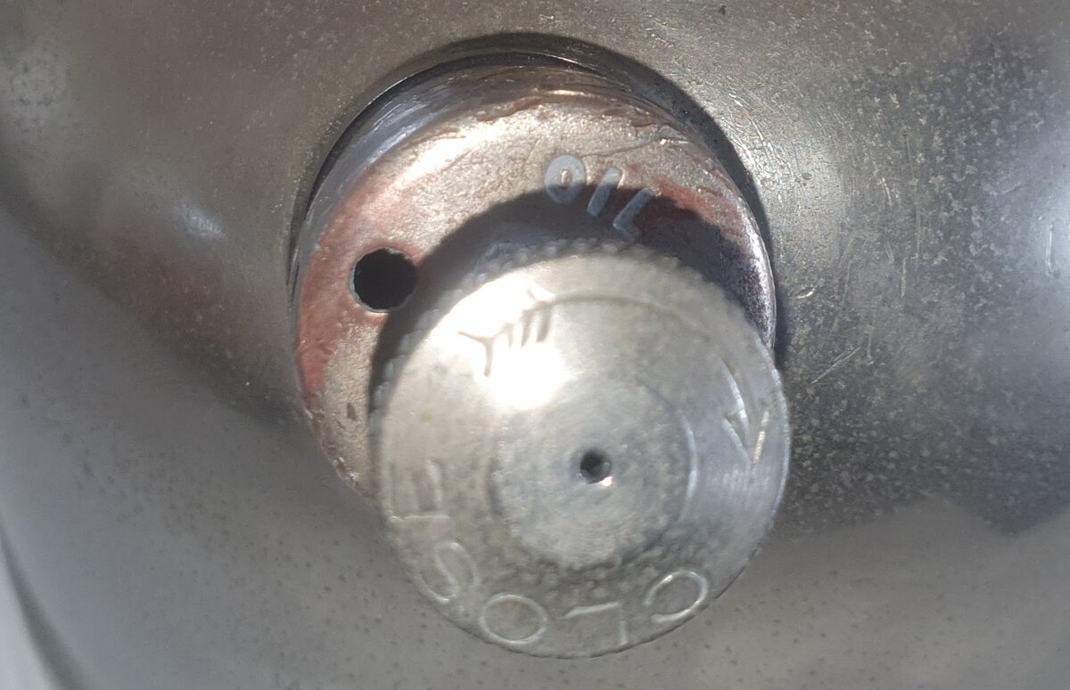

    Here is the filler cap. Seems to seal correctly when snugged down. (New washer)
  10. MYN
    1,887
    Well I think it'll still work. The screw looks like its been replaced with a cheese-headed one instead.

    I believe the cheese head screws are correct on the filler caps for the 242B Sport-Lite Australian models. I have quite a few, and all my Australian made ones have the 5/32" BSW steel cheese head bolts in the filler cap. My 1935 Canadian models have hexagonal heads but all other Canadian models that I own, have round heads.
    We can also push back the early date for Australian made Coleman 242B 'Sport-Lite' lanterns to July 1950.
    Hope this helps.
  13. Tony Press
    6,813
    Thanks, for that, @Sedgman. You are correct! I checked a Canadian, and when I just looked at my Aussie 242Bs I saw they were all cheesehead screws.](*,)
    My apologies @Graham-Melbourne: your cap is correct.

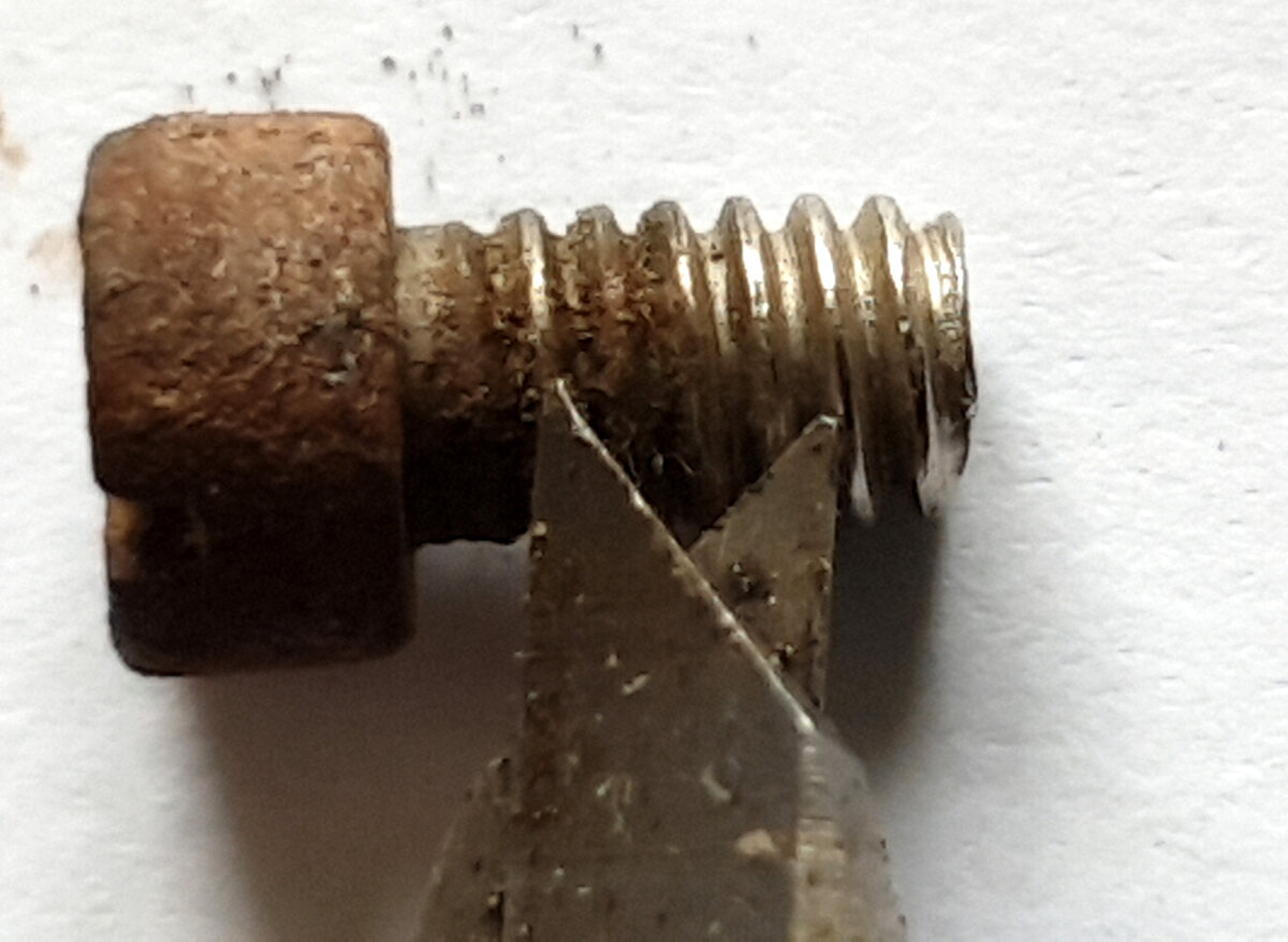

    Anyway, I have remeasured the cheese head bolt in the filling caps as follows:
    Model 242B Filler Caps
    Diameter = 01.50” (avg of three measurements; in fact all the same)
    TPI = 32
    Construction steel and length 1/4"
    Picture shows vernier measuring threads over 1/8"

    This is why, I am still inclined to refer to the bolt size as 5/32” BSW (because the diameter is much smaller than 0.190”)
    As I say clearly a thread angle tool would confirm one way or another as I do realise the whole question of bolt sizes is a thorny one and anyone working with lamps, guns or anything else involving small bolts, can be excused for being driven to despair at times.
