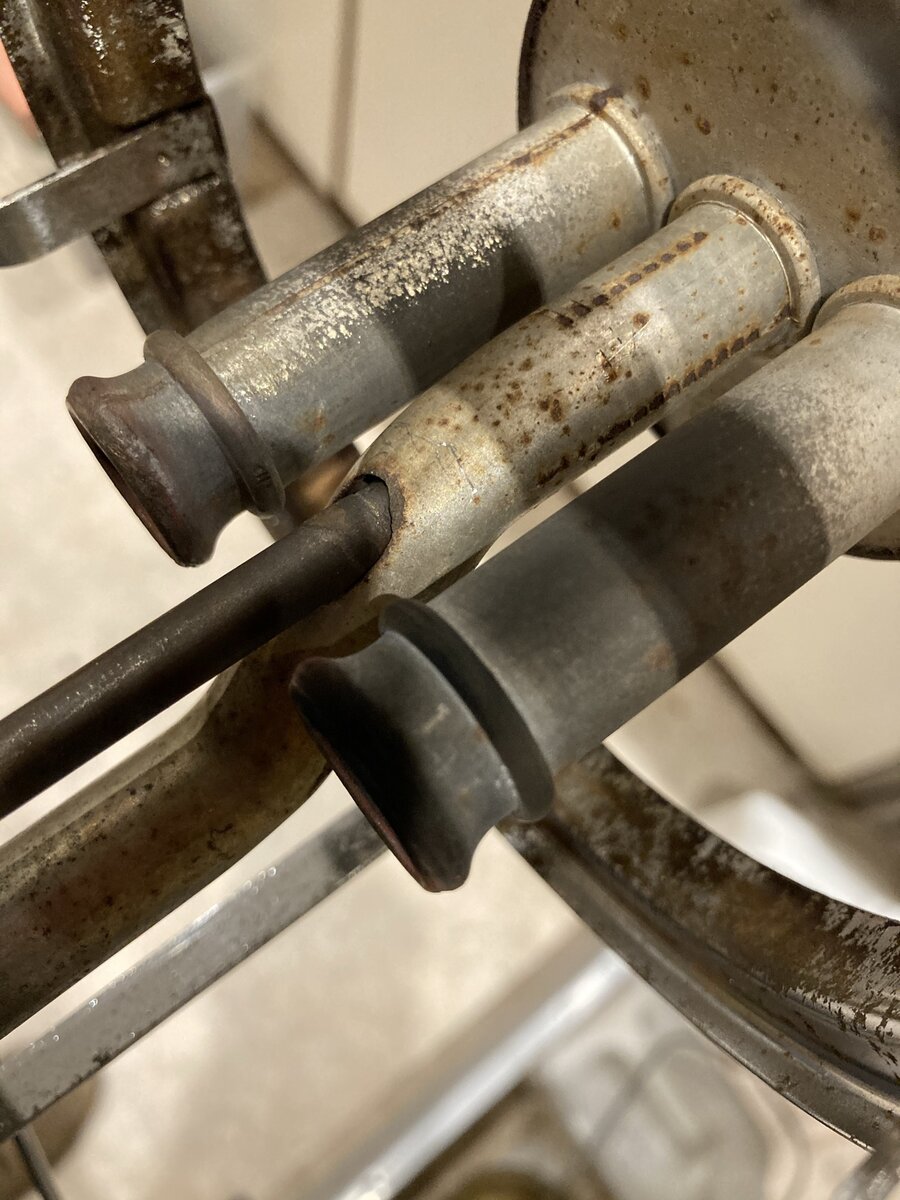

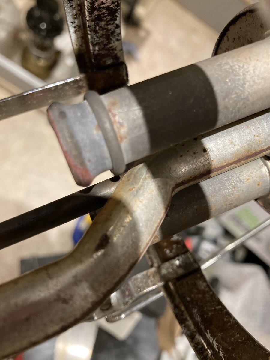

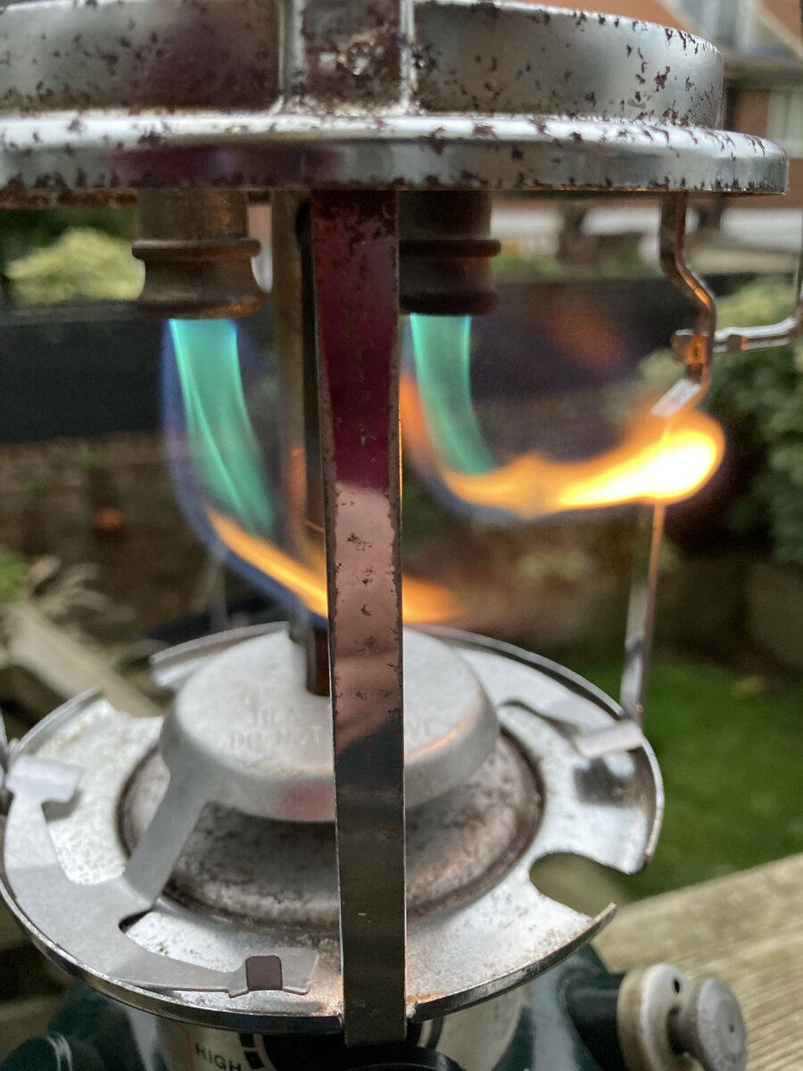

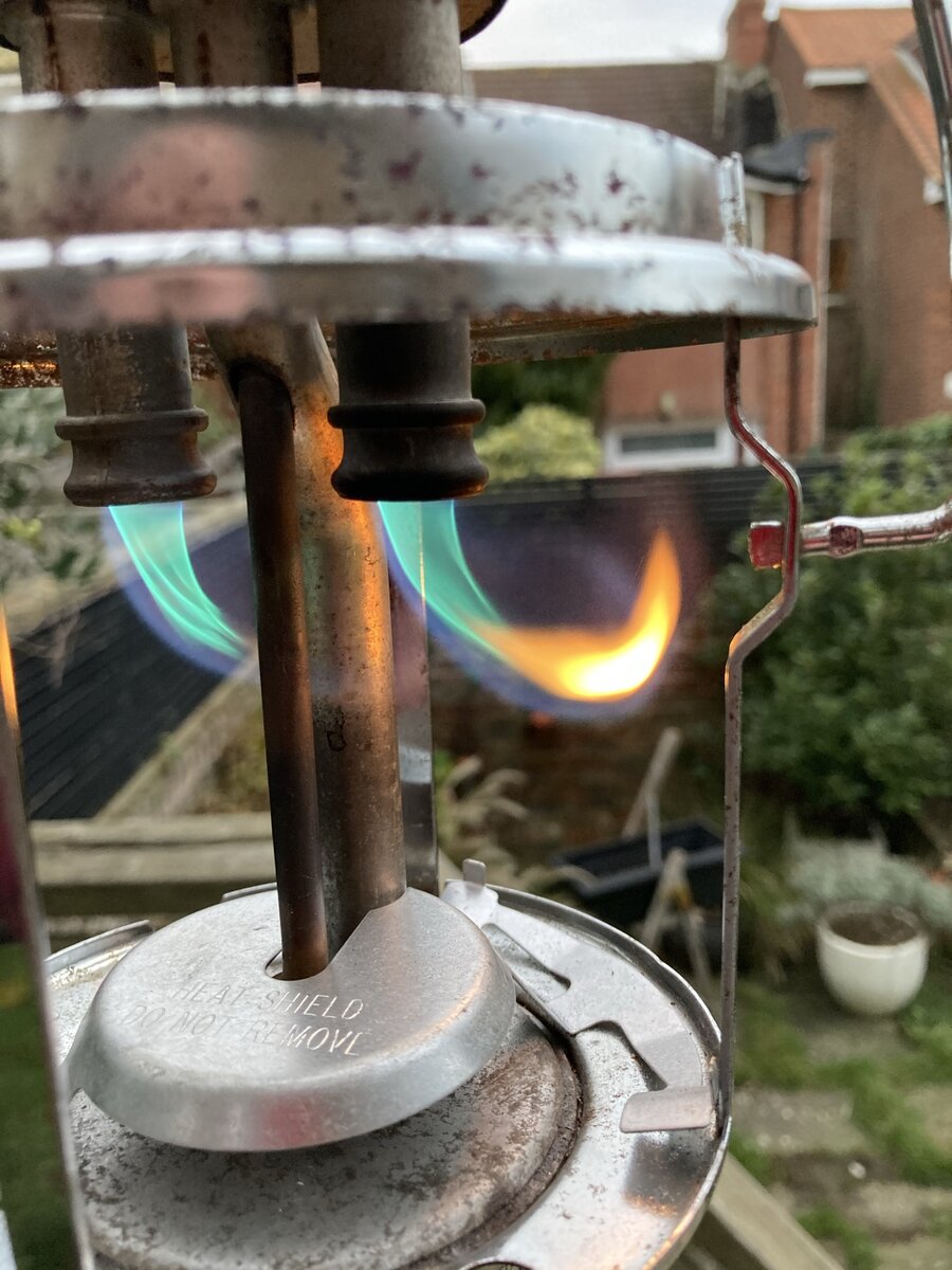

    A series of photos as requested:
    IMG_4526.JPEG IMG_4527.JPEG IMG_4529.JPEG IMG_4530.JPEG IMG_4531.JPEG IMG_4533.JPEG IMG_4534.JPEG IMG_4535.JPEG
  13. Tony Press
    6,830
    @Fireexit1
    Does that last photo show that the right hand burner flame has diminished?
    Could it be that your jet is shooting off centre, putting more fuel into one side of the burner assembly? Or that their is a restriction up top that means more fuel is getting to one side?
  14. Fireexit1
    549
    @Tony Press - yes - but with the valve turned to low. the "splitter" inside the burner body seem central, but I think the generator is a bit tired. This model seems to have quite a thin generator compared to later ones. It was bent and I had straightened it a little. The pricker is intact and moves freely, but of course the jet may be worn and throwing gas out of line. I had already ordered a new one from Canada so will try that before digging deeper. The previous owner told me he had spent more on globes than the cost of the lamp. His parents bought it for him as a teenager so he could practice/learn the guitar in the garden shed :lol:
