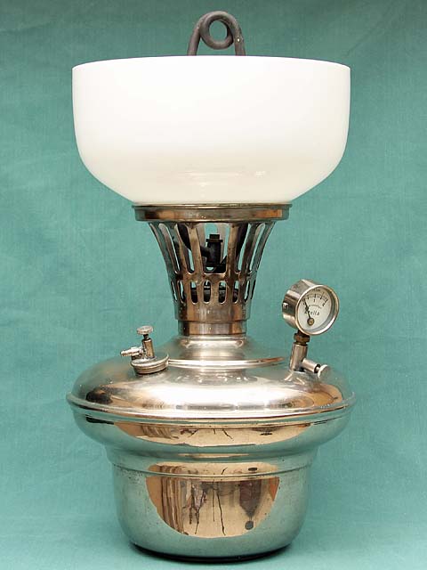

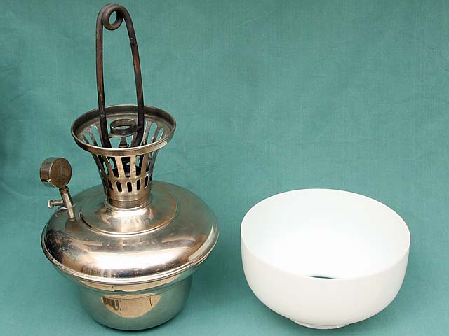

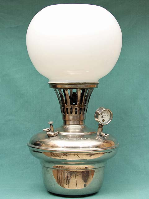

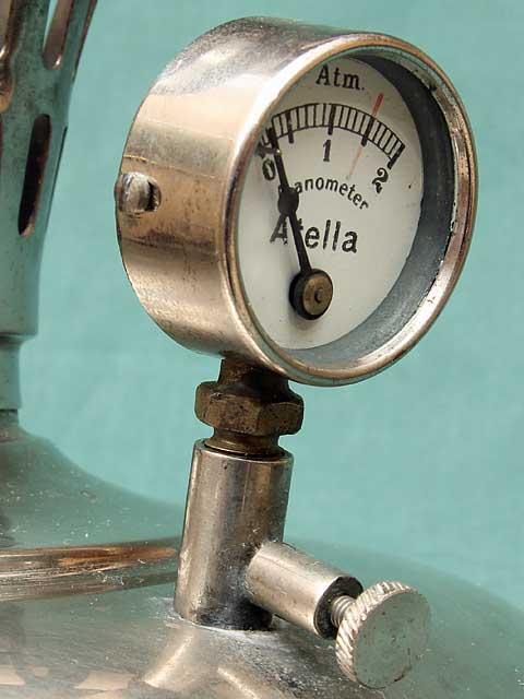

    A lamp from Aktiebolaget Atella, probably called Simplex considering this catalogues sheet.
    It shows many similarities to the very first lamps made briefly by Primus around 1912-14 or so. The vaporiser is a bit cruder, though.
    Primus used the "Lux-lamp vaporizer" in the shape of a ball above the mantle.
    Here we have a coil instead.

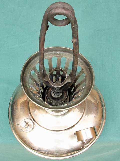

    This lamp is complete except for the combined flame spreader and mixingchamber.
    From the look of this lamp and its construction, I would expect this assembly to look pretty much exactly the same as on Lux or Aladdin, and therefore it's a pretty easy thing to turn in a lathe, so I will come back later with pictures of it running.
    I actually think that this globe is original since the lamp also was offered as hanging in a lyre. Just compare it with the Primus 1007, and you'll see the resemblance. This low cut globe was typical when mounted in a hanger at the ceiling and perhaps with a metal shade above.
    1295128495-atella1.jpg 1295128521-atella_bak.jpg 1295128550-atella_ovan.jpg 1295128597-atella_mano.jpg 1295128629-atella_lock.jpg 1295128653-atella_brannare.jpg

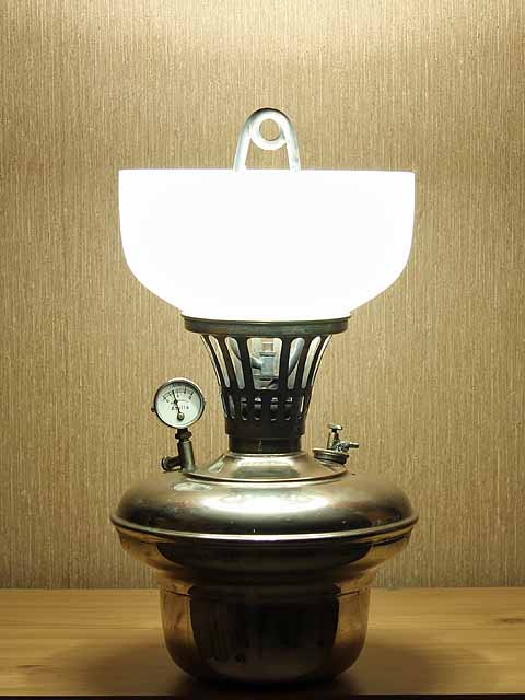

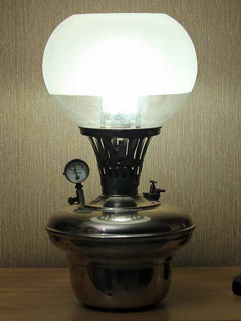

    This is the lamp with the combined mixing chamber and flamespreader from a Lux mounted just to give an idea of how it probably should look:
    And here's the Atella with a Primus 1024 globe mounted, just to give a look similar to the one in the sheet
    Notable is that a Lux globe will fit perfectly (it has a smaller fitting than the later Primus ones as you could see on the picture below since the globe is sort of riding outside the fitting)

    Kello Christer, a fine lamp, I assume that it's meant to fit into a hanger or a wall bracket etcetera?

    Christer, another lovely lamp. So its just the top cover that is missing? Any chance of taking a picture lighted :D

    Great lamp Christer. I like the hooks to hang the mantle, very ingenious. The Lux flame spreader/chamber looks to be a little high. Maybe the original sat down in the ring.
    The tank has some minor differences to the Primus 1005 so I don't think they came from the same factory, but there must have been collaboration or the design was 'borrowed'.

    Yes Jeff, it was made for use in a hanger.
    The shape of the tank itself does not necessarily mean that it was solely made for a hanger, but rather to make it versatile.
    Just look at the Primus 1005.
    The catalogue I posted says that it can be used in regular, large hangers.
    Ron, a picture of it in shining glory will come as soon as I have made that missing flame spreader. 8)
    Yes Nils, the flame spreader from Lux sits on top of the holder. I'm sure the real flame spreader assembly shall be positioned inside the ring, and therefore a centimeter lower which would give the correct distance from the bottom of the chamber to the jet.
    You're right. The Primus tank does not look exactly the same, but very, very similar.
    It would be nice to see some photos of a 1005.
    Maybe you could post yours in the Primus gallery?
    How large is the tank on that one? This is about 23 centimeters in diamater at the widest.

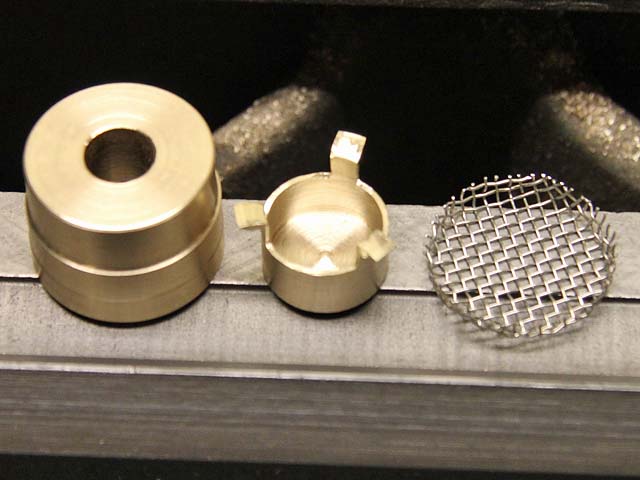

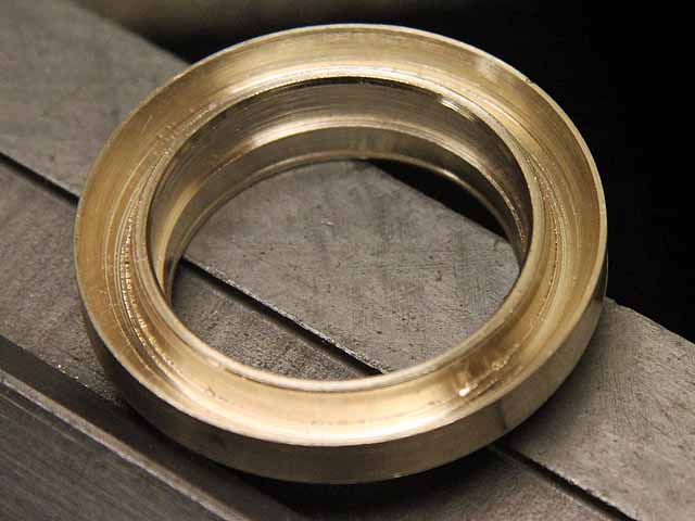

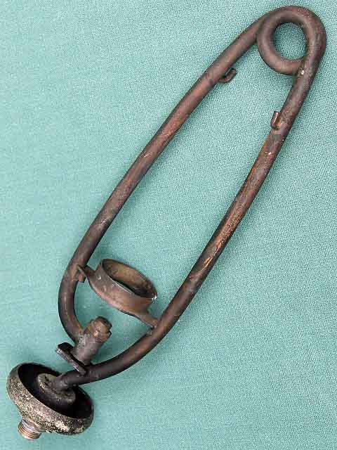

    OK! So I had to spend some hours by the lathe, but that's no labour. Just pleasure. :lol:

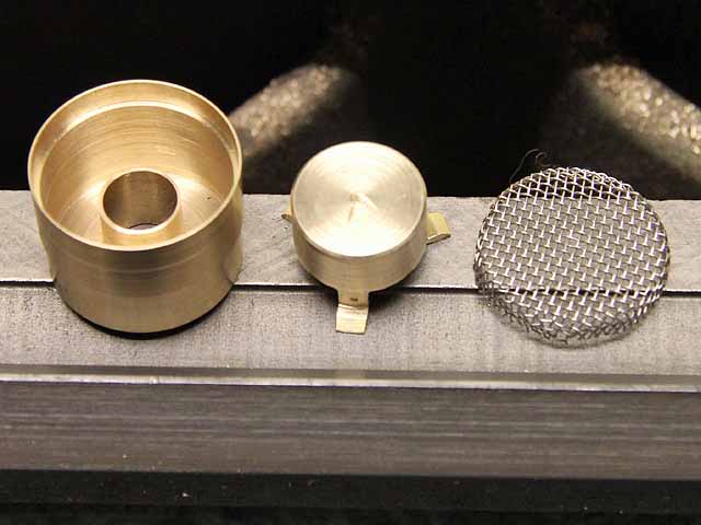

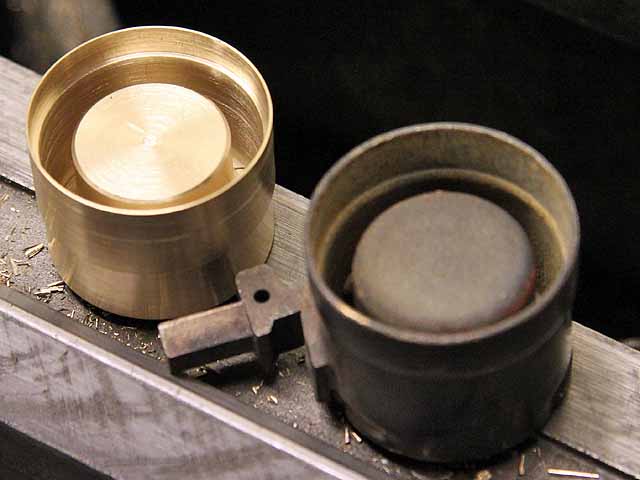

    Firstly I made my own version of a Lux burner/mixing chamber/flamespreader. (hereafter just simply called "flame spreader". I have no idea of what that gismo should be called for real...)
    I have no doubts that this lamp also used this kind of flame spreader, which was the usual way to get a "blue cone" on Swedish lamps with an upright mantel during this early period. Lux, Aladdin, eventually Primus... they all used it.
    The flame spreader consists of three parts; an outer housing, an inner cap and the flame spreader gauze.
    The outer housing and the inner cap are easily turned in brass on a lathe, and the gauze is made by firstly making a die to help forming the stainless mesh into the correct shape. The parts for the die is preferably made by the leftovers in the chuck after making the other pieces! No need to be wasteful. :lol:
    Here's the three parts seen before assembly from the upside, and then from the downside. The rim near the centre -seen on the outside - is to seat it at the holder at the lamp. The lesser noticeable rim on the outside a bit higher is just the widening for the seating of the gauze. (The observant will also notice that I made two different gauzes. Later test prooved the finer gridded one to be the best, no surprise :roll: ):
    The inner cap has three little feets which both lifts it up to let the vapour pass, but also keep it centered inside the housing:
    Here it is compared to a regular Lux flame spreader. My version is a tad bit smaller to fit inside the holder mounted just above the jet on the Atella:

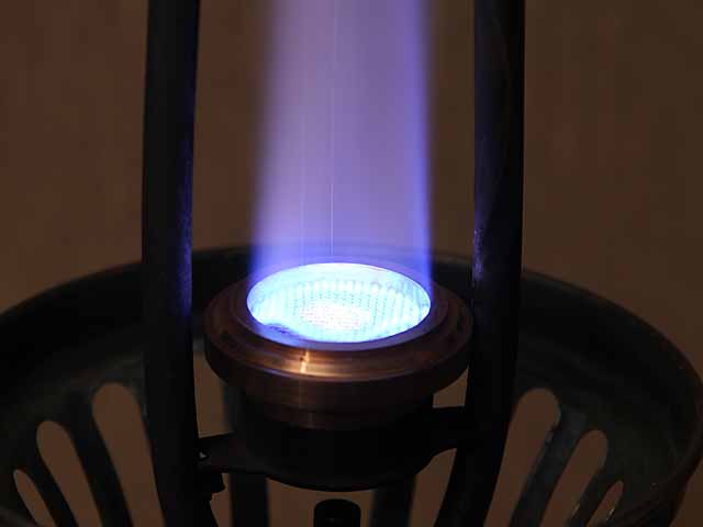

    And here the complete assembly is mounted on the lamp:
    I tested it, and it performed well enough.

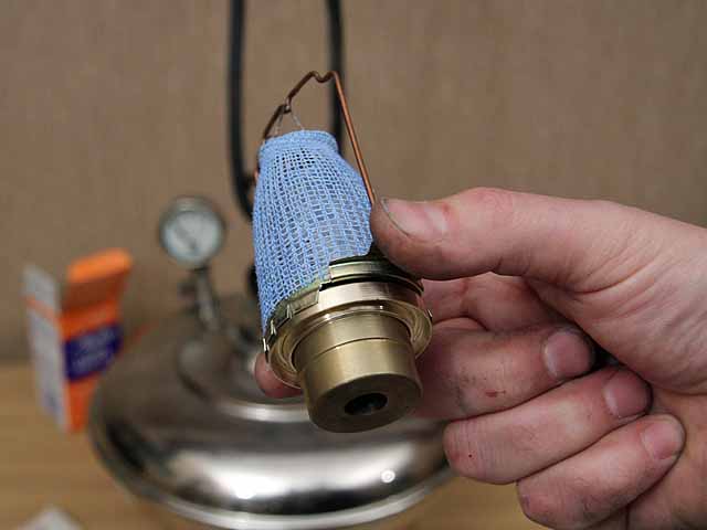

    Then the trouble came up to get a suitable mantle. The correct size isn't available anymore. The gaslight mantles I like to use on many of this kind of lamps had to small diameter at the base so I tested a regular Aladdin mantle (not the good old Swedish pressure-Aladdin, but the more common wickie lamp, e.g. No.23). I just put it above the flame, and it performed very well so I decided that this was the mantle to go for.
    It's very important to me that I have a lamp that I can use, and this also means that mantles must be available.
    I could of course hang it loose on the existant mantle holder, but I thought it would be more convenient to just simply be able to seat any complete Aladdin mantle directly at the burner, which meant that I also had to make an adapter to put on the flame spreader to get it to firmly hold an Aladdin mantle.
    This is it:

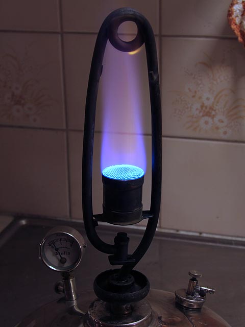

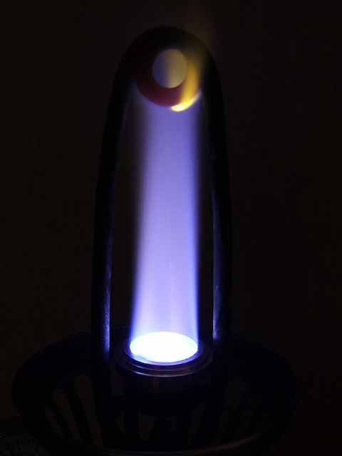

    It sits tight and firm, and doesn't interfere with the nice blue flame, which still looks good enough to me:
    On with the mantle again and let it go!

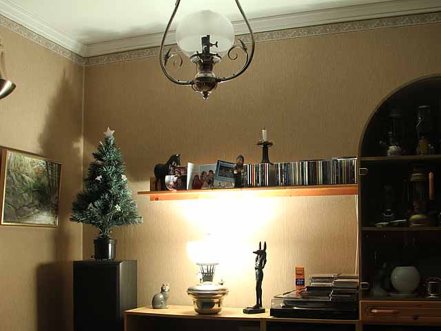

    First picture with the shade that came with the lamp. Second with a Lux-modified Primus globe, and the last to show the light. It actually performs great. And yet I haven't dared to pump it up to more than half the normal value of 1,5 atm overpressure.:

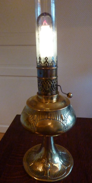

    I must say I'm impressed by this lamps performance. And then after about an hour of problem free and stable light - a confirmation that it all have worked well; a totally soot free Aladdin mantle! Not really the way we are used to see those when mounted on the regular wick lamp they were intended for :lol:
    PS. On the last picture with it lighted, you can see a part of the Lux lamp I borrowed the round globe from, hanging from the ceiling

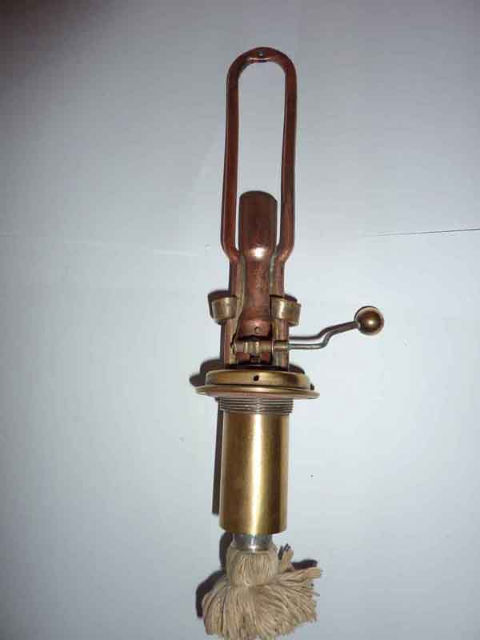

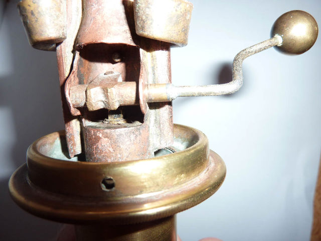

    I can show how this works with a loop burner a little similar to Christers but with the technique as the Tito Landi. This is a French gasoline wick fed Boler burner. You can see the big loop beeing preheated from the spirit cup beneth. This brings heat downwards through the prehaeted rods and in contact with the fuel brought up by the wick the vapourising is starting below the jet you can see as a small square piece in the middle of the burner.
    With the Atella lamp the pressurized fuel, if I am correct, is passing through the coiled loop and there it is vapourized by firstly preheating and later heat from the burning process. The loop is bringing down vaporized fuel to the jet beneth. The vaporizing process here is above the burner/jet and pressure is essential to keep the fuel up to the loop and keep the process going.
    /Conny
