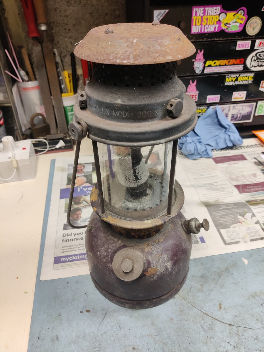

    A friend kindly gave me a Vapalux 300X to restore. I done a slightly later 300X a few years ago, but this latest one has a couple of issues that I'd be grateful for some more experienced advice with, please.
    I've got most of the lamp apart but I can't get the non-return valve out of the tube. It unscrewed without too much bother, but is stubbornly resisting my efforts to draw it out of the pump tube. Is there a good technique for getting it out, or a tool to pull it out? I have bent a small hook from still wire, which I can get through the air hole, but it pulls out before the valve shifts.
    Also, the tank is really mucky inside. It has a layer of what looks like hard shiny black enamel, which presumably is hardened residue from the ancient fuel that was in it. The bottom of the fuel pipe was coated in the same stuff; on that I carefully scraped it off with a scalpel (it comes of easily) but obviously I can't get inside the tank with anything abrasive. Has anyone else encountered this and discovered an effective cleaning product?
    The air nuts tubes had seized onto the tubes, resulting in the tubes unscrewing from the vapouriser. I'll give them a soak in penetrating oil, then apply some heat, and was planning on holding the tube in a lathe chuck (to prevent damage) whilst turning the nut with a ring spanner - should work, fingers crossed.

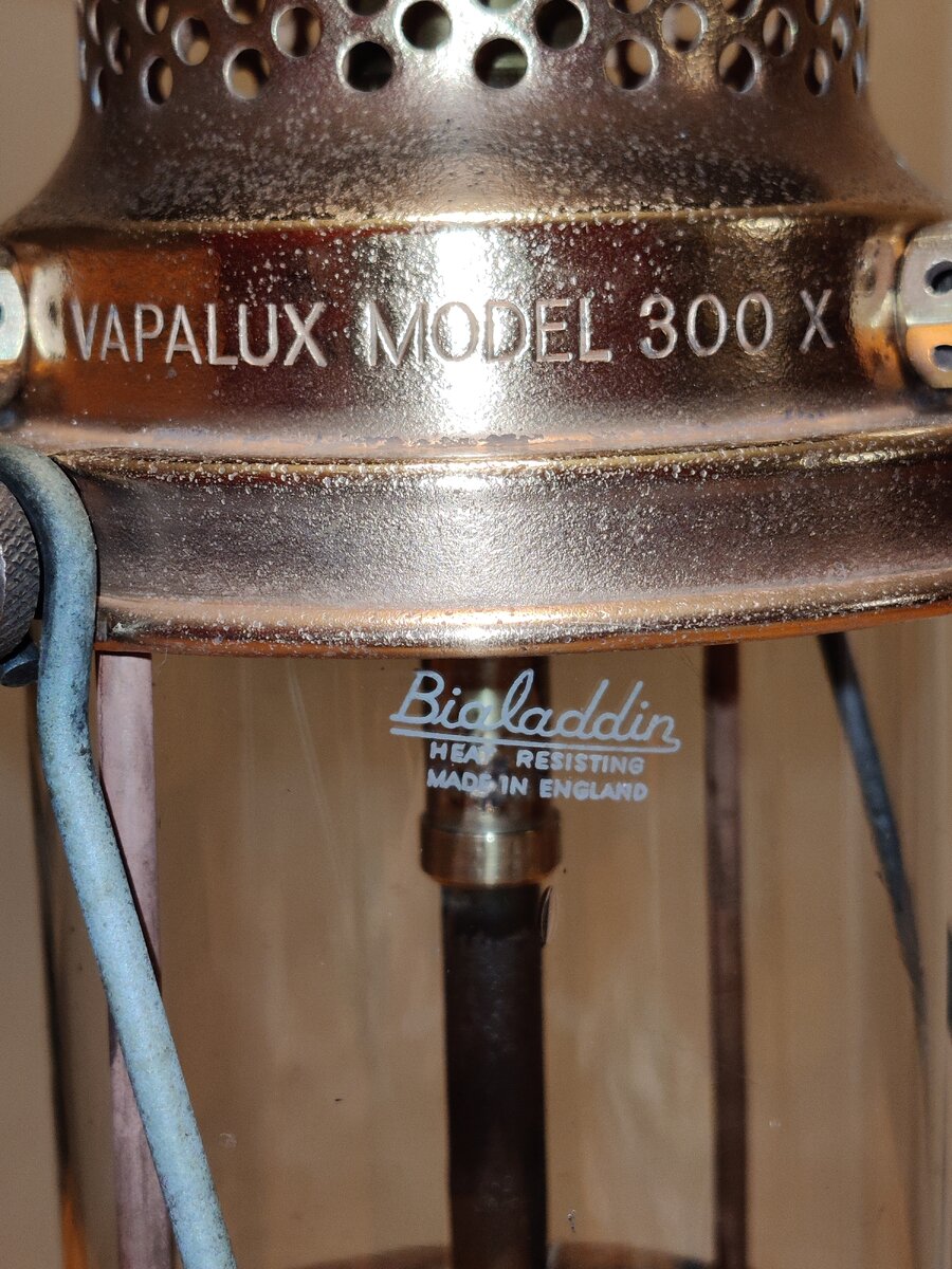

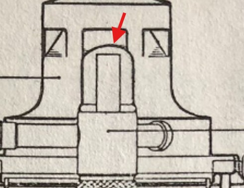

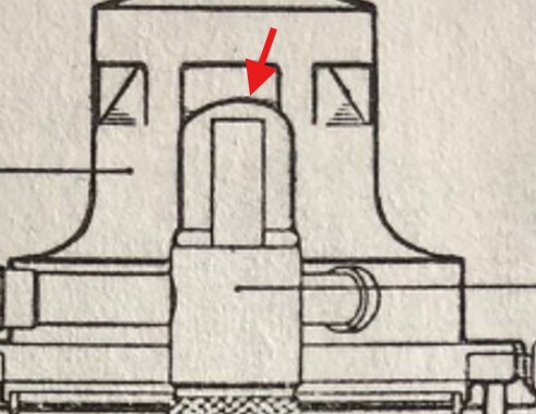

    One thing I just noticed is that right on top of the domed part (see image) has got a small pinhole - literally big enough to poke a needlework pin though. I'm assuming it shouldn't be like this, but please can somebody confirm?
    If it should not have the hole I will attempt to braze it to fill the hole.
    Thanks very much.

    It should not have the pinhole…

    Many thanks Tony. I guessed that was the case because it didn't look quite right and I can't imagine that you'd want paraffin vapour getting out of the top.
    I have now brazed it over, so fingers crossed it'll be ok when the lamp gets hot.
    Will progress with finishing it off now.

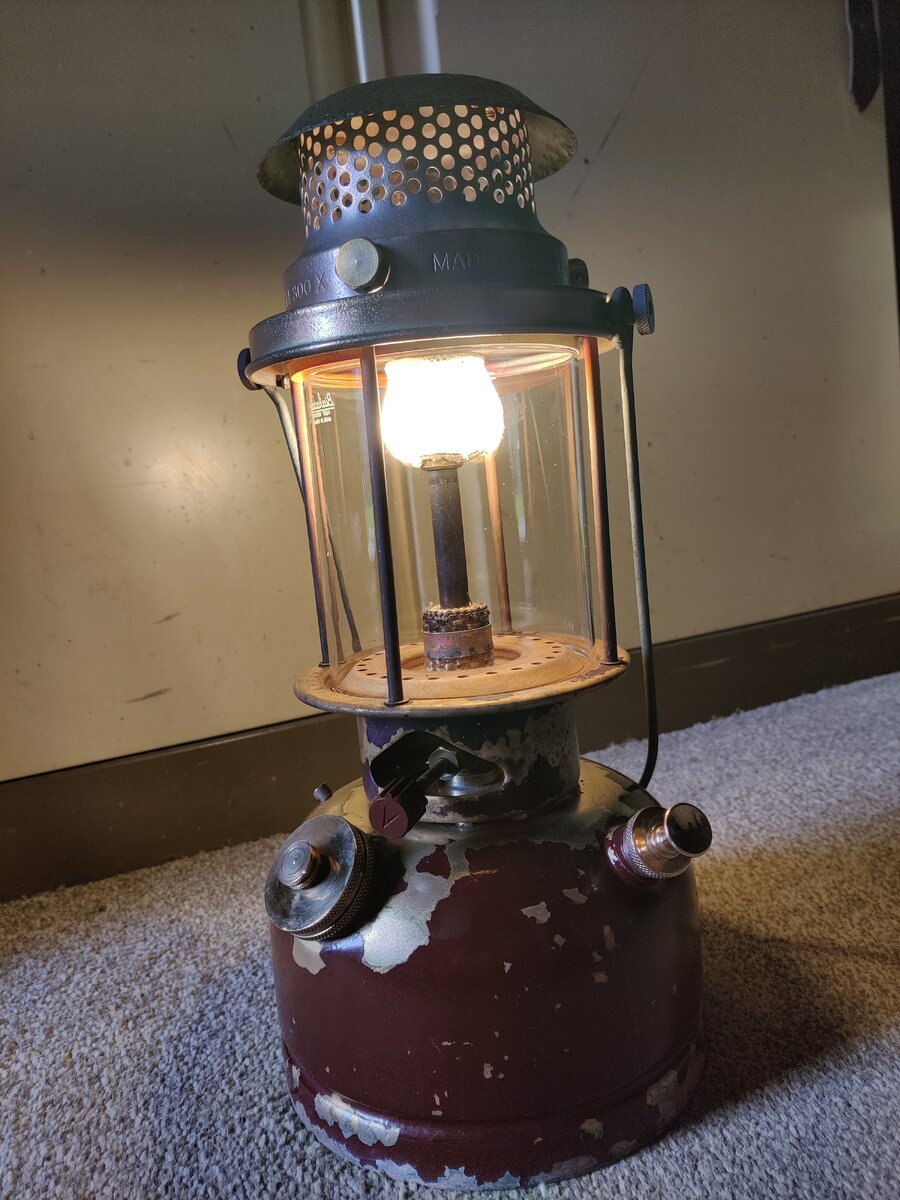

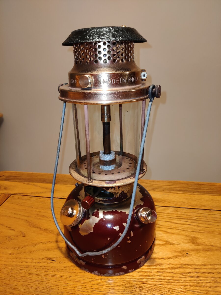

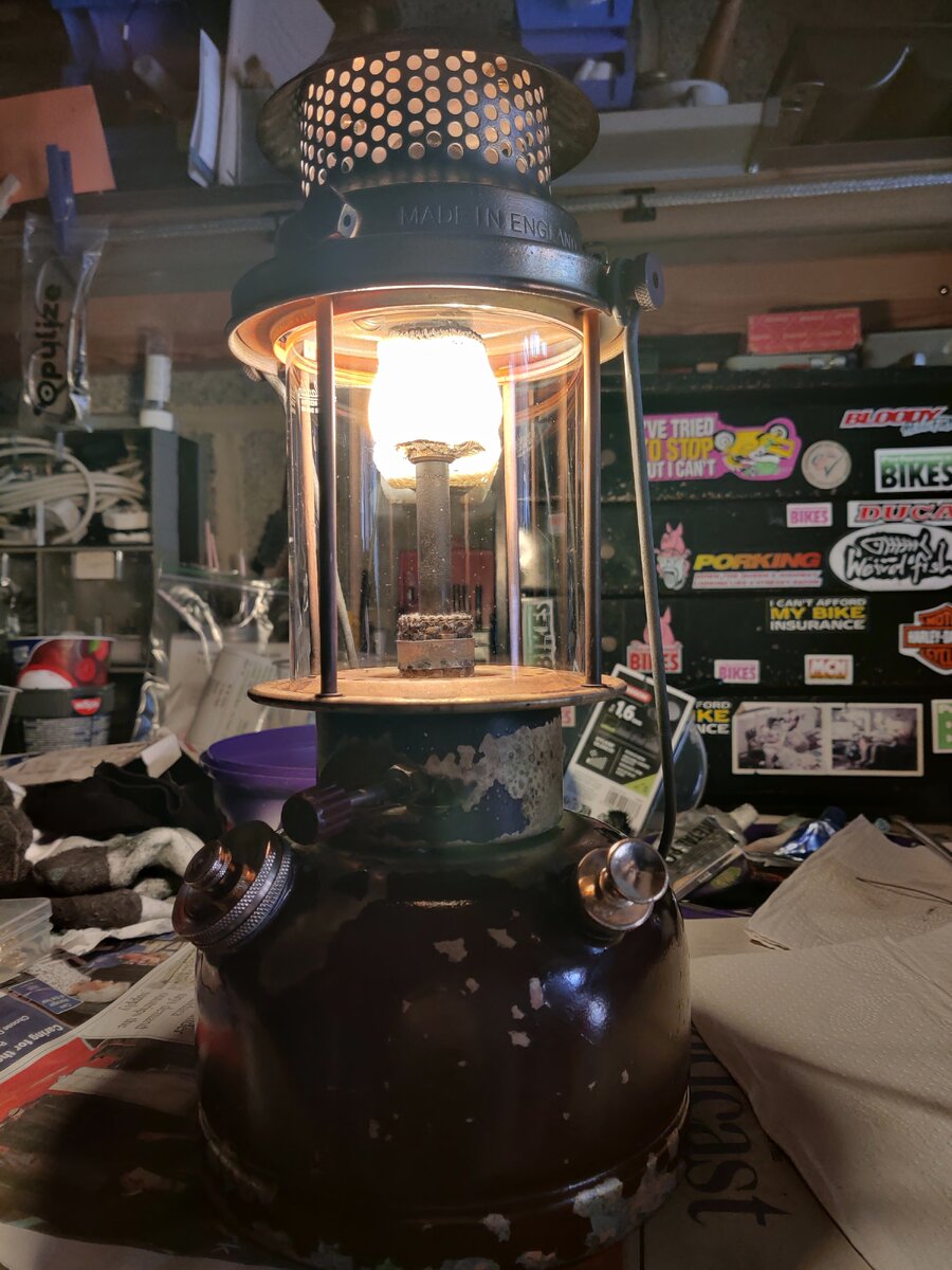

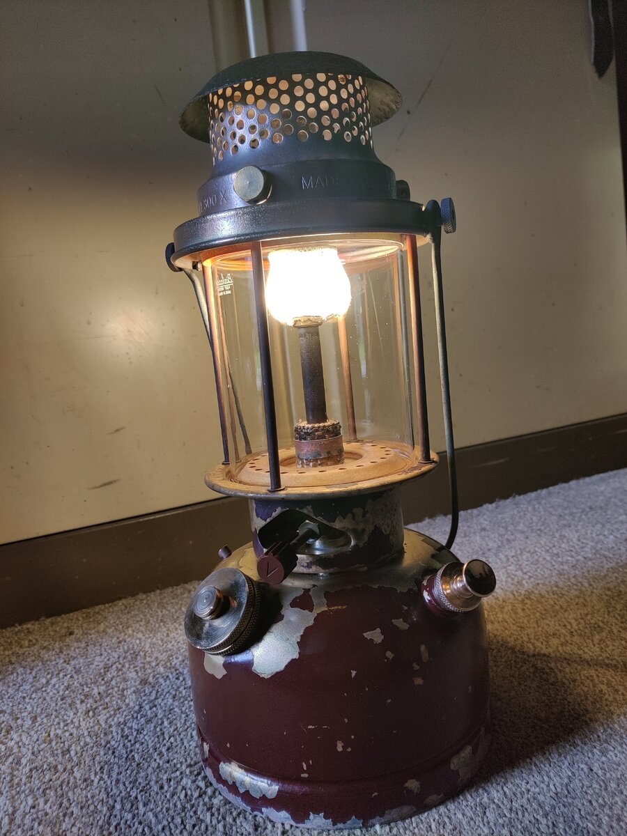

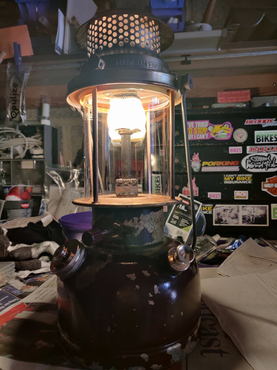

    Finally got the 300X finished and running!
    Took a bit longer than planned but along the way I have been given a Tilley TL10, so I've been working on both on-and-off.
    I had planned to get the top cap stove enamelled but opted for matt black exhaust paint in the end (doesn't look quite so good, but saved a few quid - a future upgrade potentially though).
    The only real issue I had was getting the pump non-return valve to seal properly having fitted the new washer, but after a few failed attempts I realise the washer wasn't pushed properly into the brass cup, so once that was sorted it kept pressure fine.
    Lit it for the first time this morning; just needed a few rotations of the pricker to clear the jet, and hey-presto it ran really well.
    Thanks again for your help and advice getting this done.

    Looks much better now @Matto
  12. Paul Burnell
    Paul Burnell Ireland Subscriber
    May 12, 2023
    176
    Ireland
    Cracking job.....love the the battle scars. They give it character.
  13. Gary Waller
    Apr 3, 2018
    621
    A nice early 300x saved and working well, a nice lamp, congrats.
