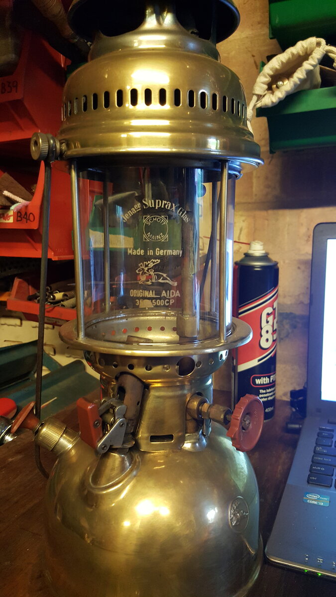

    Shower time , light provided by my aida, 1350.
    Great find, minimal needs to get it going, the preburner work a treat 20200813_183424.jpg 20200813_182706.jpg

    Very nice lamp! Are you running it on kero?

  4. Darryl Durdin
    753
    I asume it works on kero, its been going well, i think it may have an air leak as it gose out of pressure after a while.

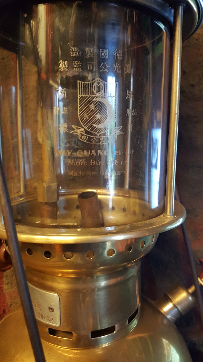

    Some pics,
