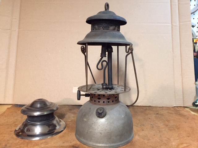

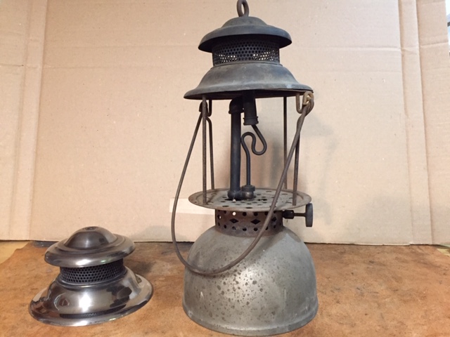

    The lantern came with a spare hood in excellent condition, which was fortunate because the original hood suffered from extensive damage. I suspect that the lantern, at some time in its life, had been dropped on its head.
    The following is the description of the lantern’s journey through the fettling process.

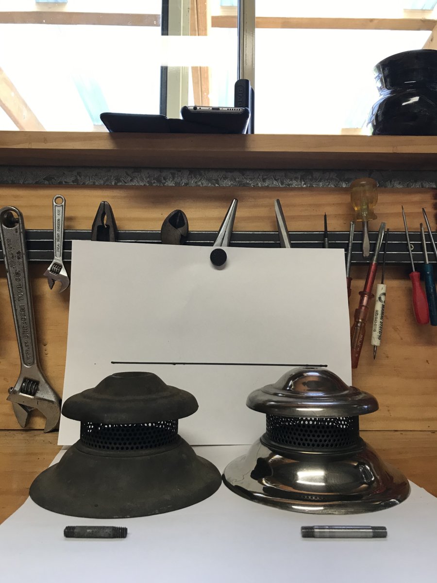

    As mentioned, the lantern appeared to have been dropped. The resultant damage to the hood can be seen in the following picture.
    It’s evident that the original hood has been significantly compacted, and as a result, the hood retaining bolt had been shortened during an earlier repair.

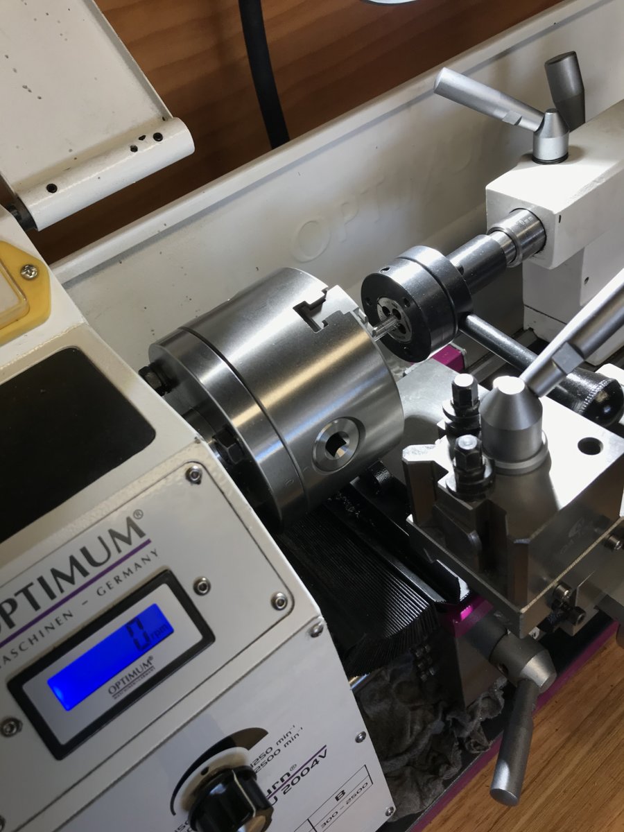

    I decided to use the good spare hood which required the manufacturing of a longer hood retaining bolt. The new retaining bolt can be seen in the above picture under the better hood. I used the original Akron thread type, 1/4 NF 28, shown in the next picture being cut using my lathe.

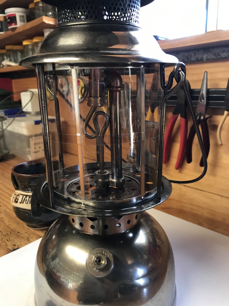

    Further, the burner’s air tube had been significantly bent causing the burners to be crooked. The misalignment may be seen in the following picture.

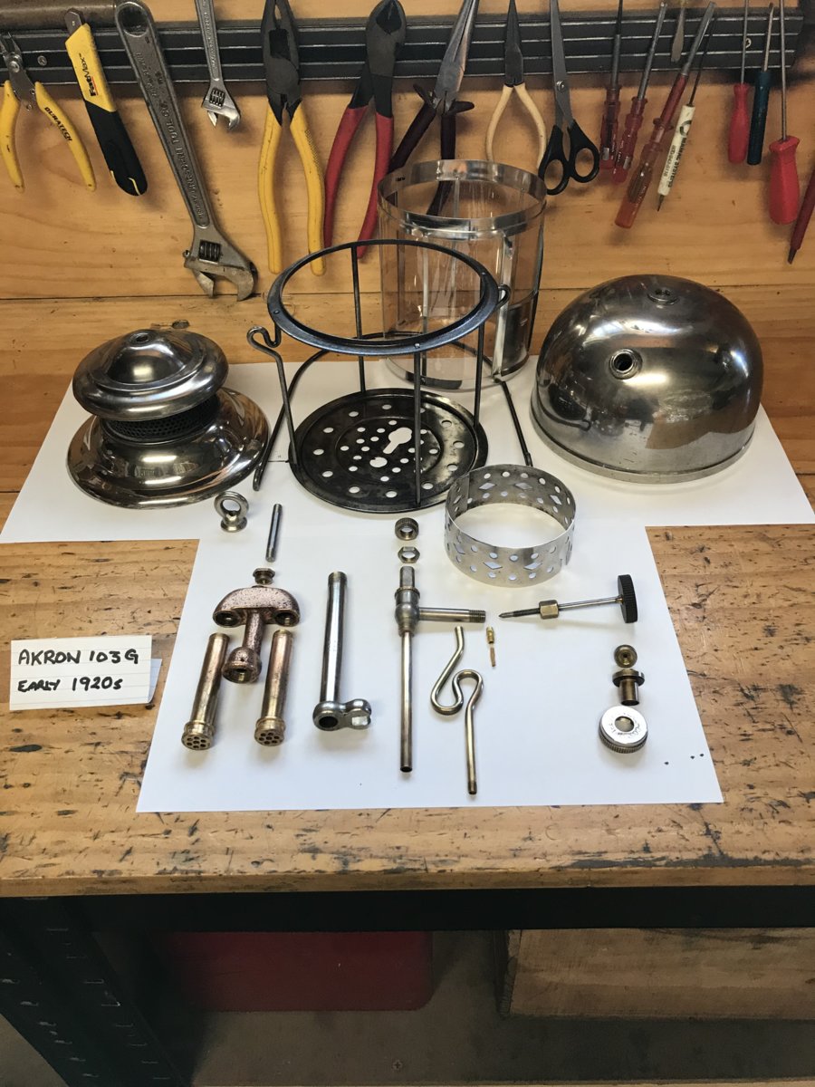

    The lantern was stripped and the various parts were cleaned. The bent air tube was straightened by using a drill bit, sized to snuggly fit the internal diameter of the tube, as a mandrill. The mandrill was pushed into the air tube, and with judicious tapping with a wooden mallet around the outside, the air tube was successfully straightened without denting.
    All the parts were first soaked in a warm to hot diluted citric acid solution for a maximum of 30 minutes, brass hand brushed and then cleaned in the ultrasonic cleaner.

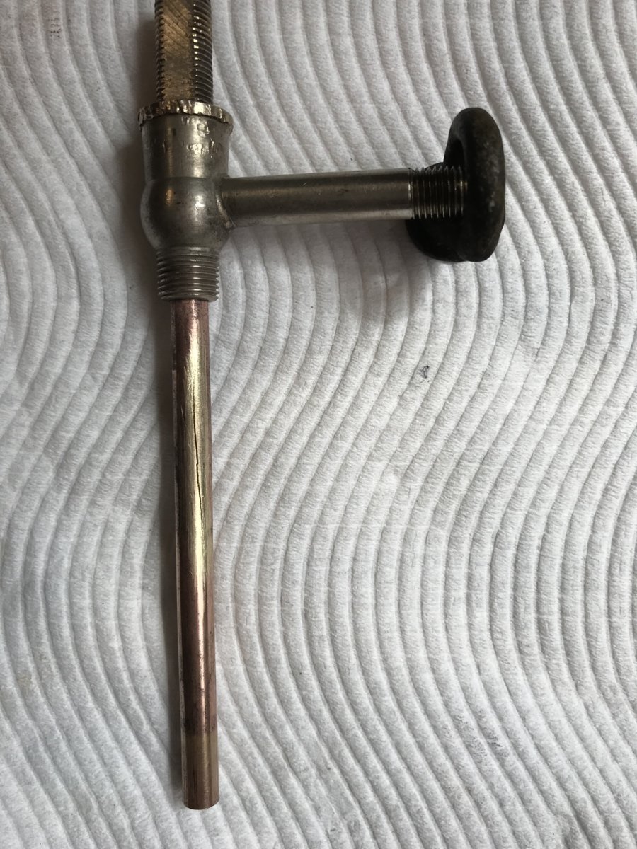

    During the cleaning and inspection I found that the fuel pick up tube was faulty, there was a large split in the side of the actual brass tube, as seen in the next picture, it’s in the top third of the length of the air tube below the valve fitting.
    This split appears to have been there from manufacture, in the early 1920s. I can only speculate that this lantern must have suffered in its performance when the fuel level was low.
    I successfully soldered the split in the tube.

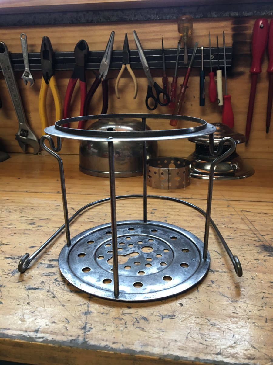

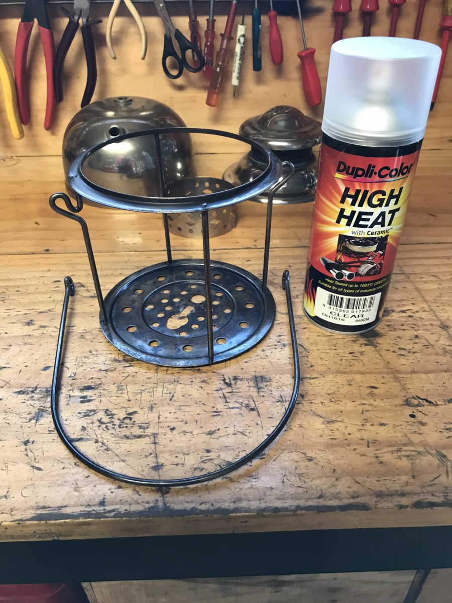

    The next item was the globe or chimney frame. There was significant rust evident.

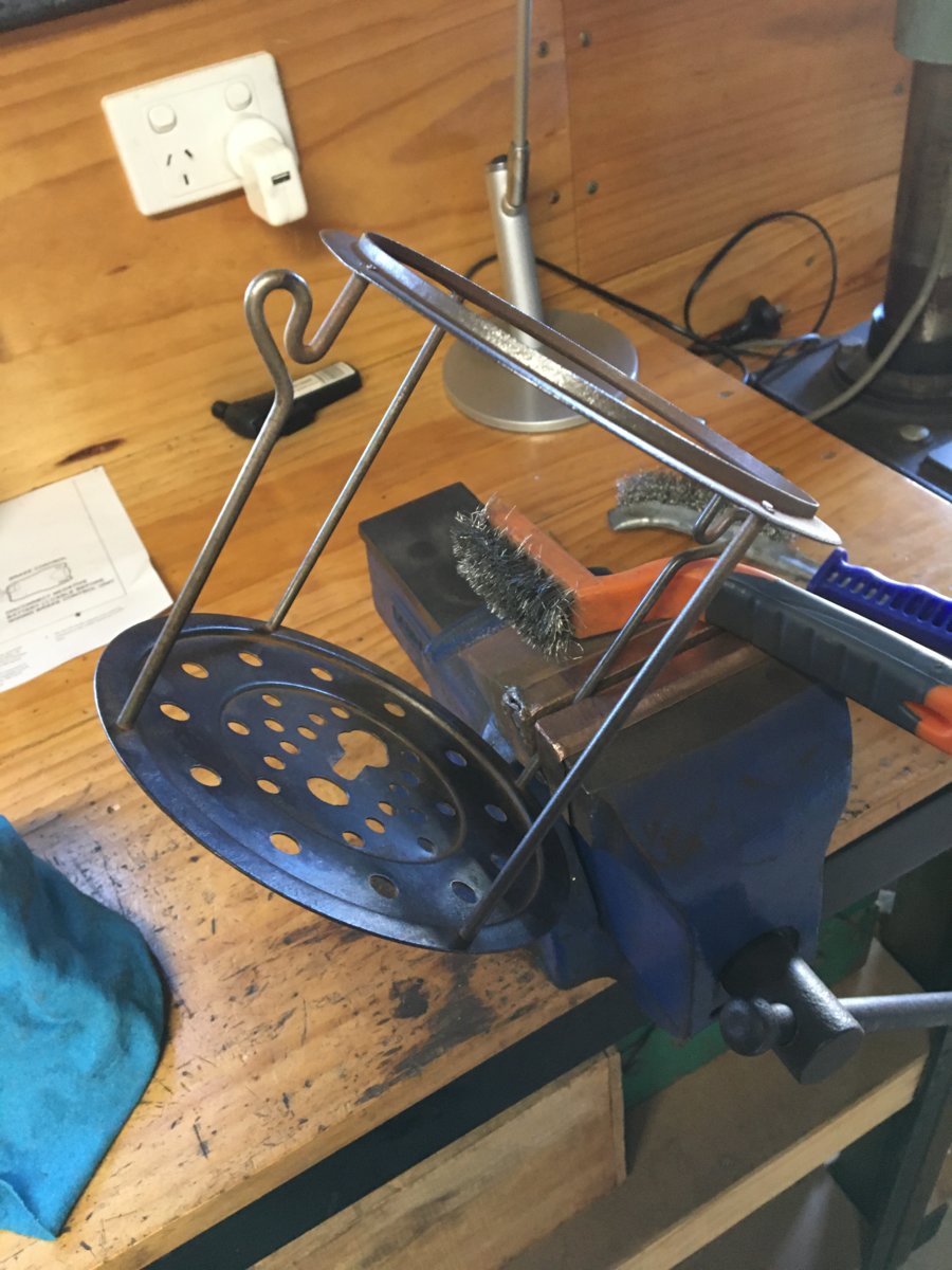

    Its my practice to clean and expose as much of the original plating on the frame as possible. My intention is to preserve what’s there and not replace, if at all possible.
    With vigorous but careful brushing with a stainless steel brush, and then fine sand paper, emery paper then metal polish I prepared the frame. The same was done to the bail.
    I spray painted the frame and bail with a high temperature clear paint subsequently baking them in an oven at 200degC for 1 hour.

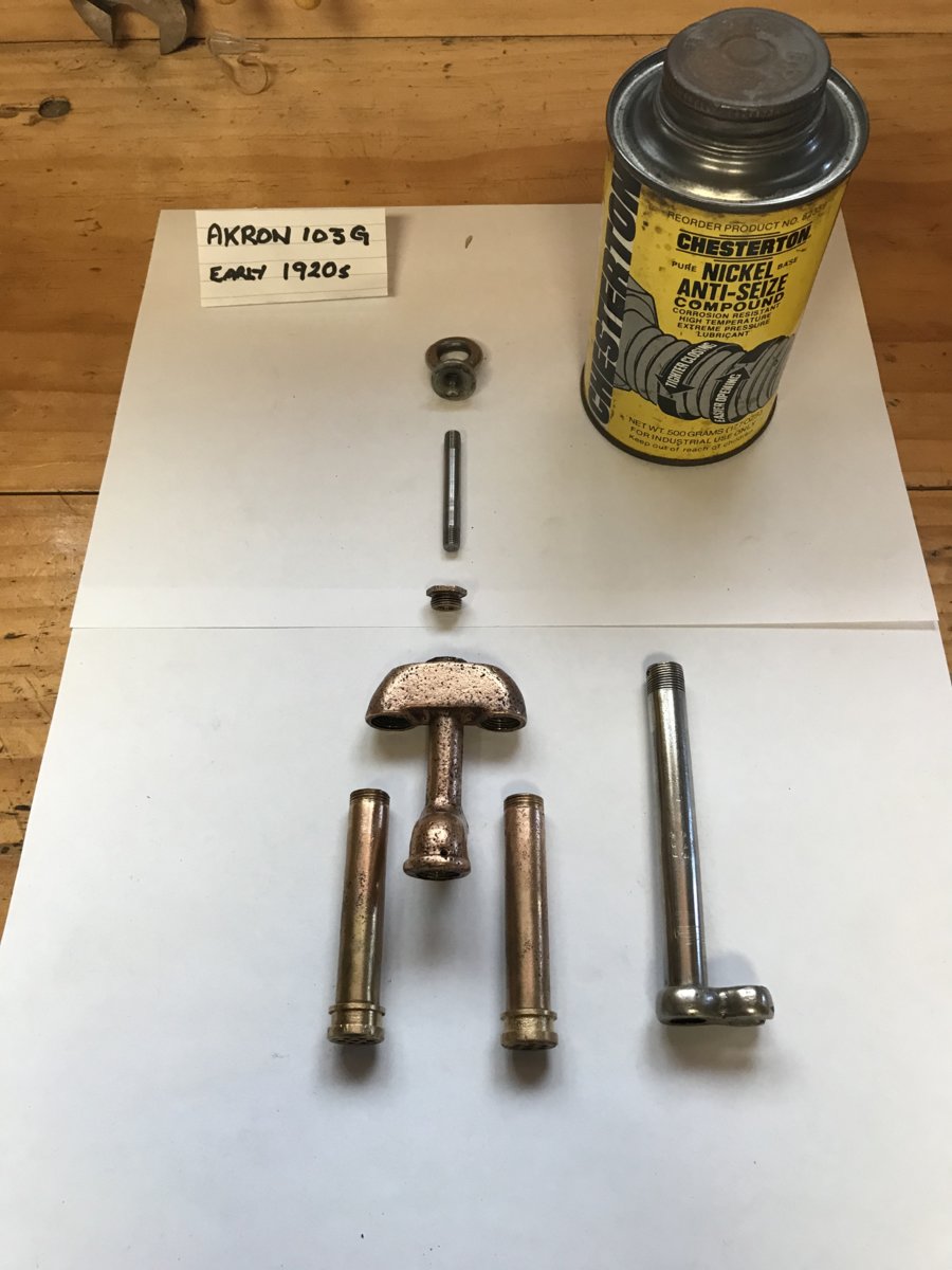

    When assembling the burner tubes I used a nickel anti-seize paste on the associated threads.
    The application of an anti-seize compound to the threads will perhaps allow an easier future fettling by helping to prevent the parts seizing together.

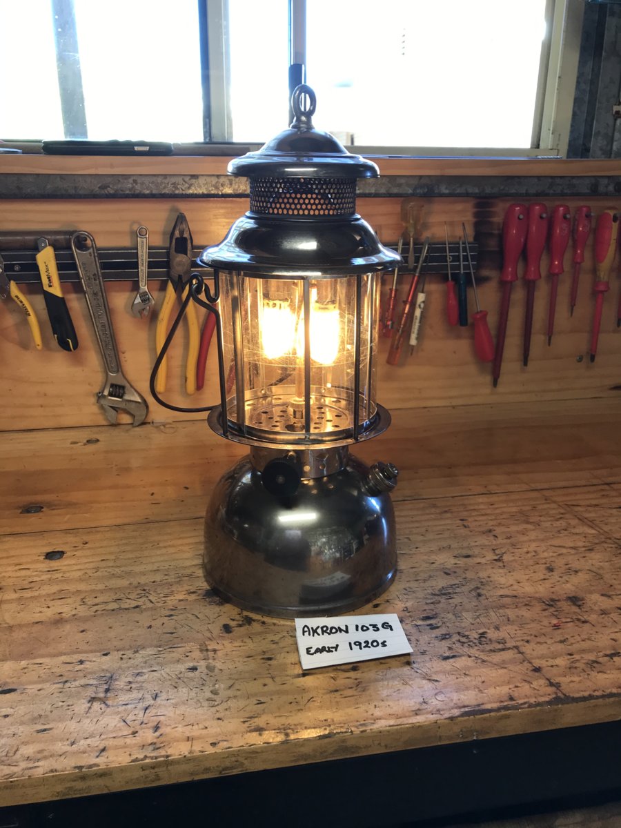

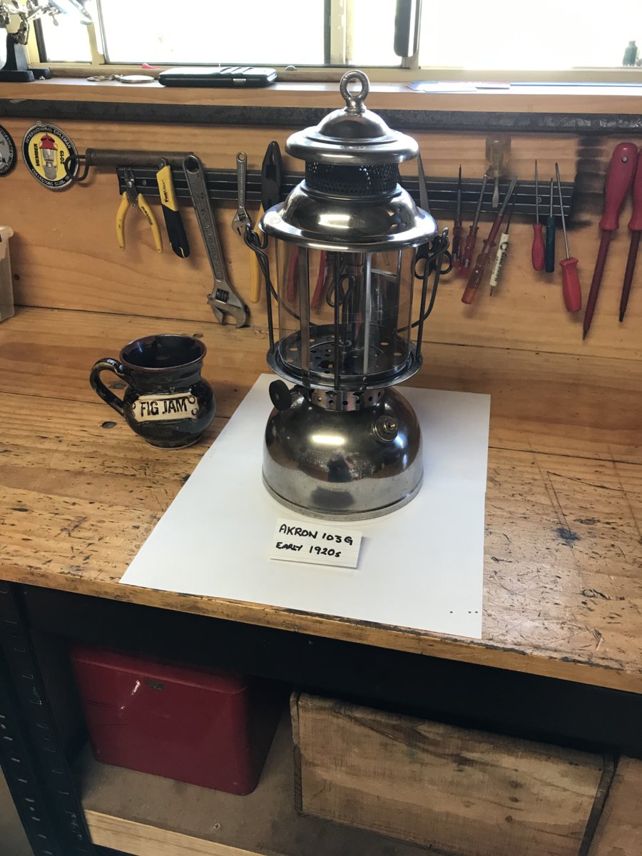

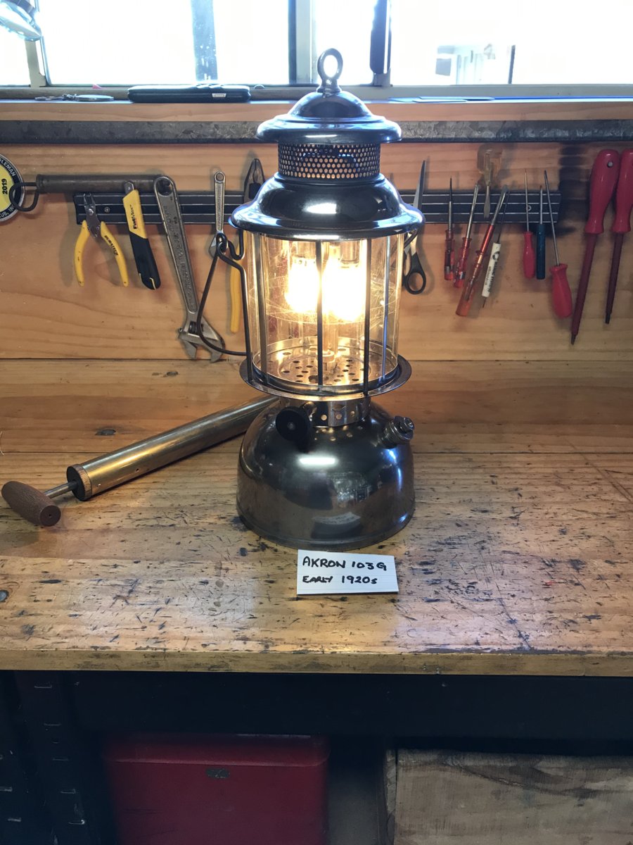

    Finally, with an excellent Fred Kuntz mica chimney, the parts were assembled into the fettled Akron 103G.
    The air tube is now straight and the burners are correctly positioned.
    Now ...... the money shot.
    I enjoyed the fettle of this lantern, it had a few challenges and the resultant reconstruction was very successful and satisfying.
    She is a keeper and sits well with my Coleman Quick-Lites.
    Thank you for looking
