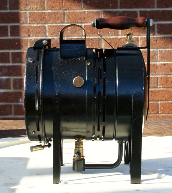

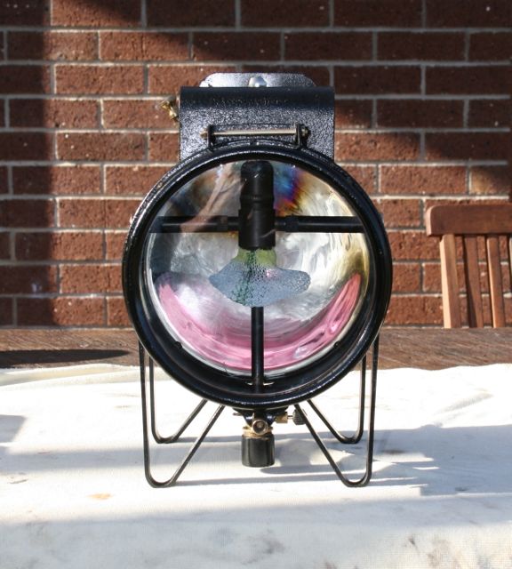

    Here is my AL 21. I've been working on it for quite some time, and wanted to finish before the austral winter solstice. I finished it today - the shortest day for 2014 in the south.

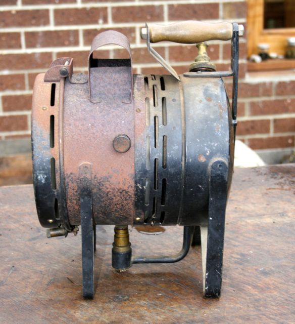

    Here it is as I received it:

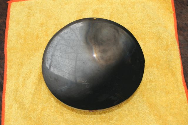

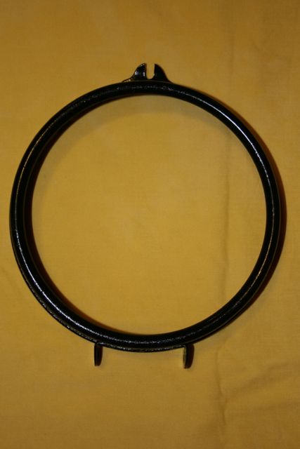

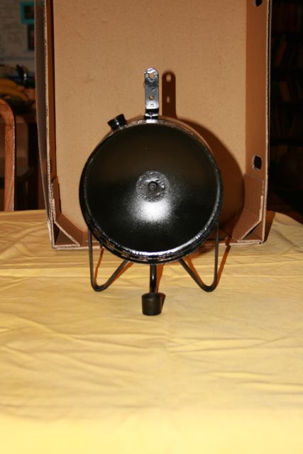

    The parabolic reflector:

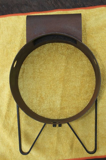

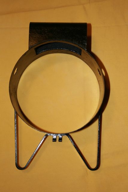

    I use VHT brand high temperature black paint, after treating the rust with rust converter. I over-coated with VHT clear coat. I baked the bits with solder at 94C and the bits without solder at 200C
    As I intend to use this lamp, I didn't go the "sandblast' route. I just wanted it to be functional.

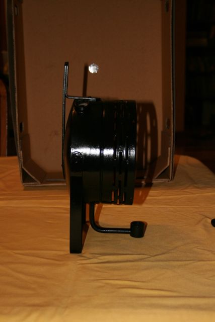

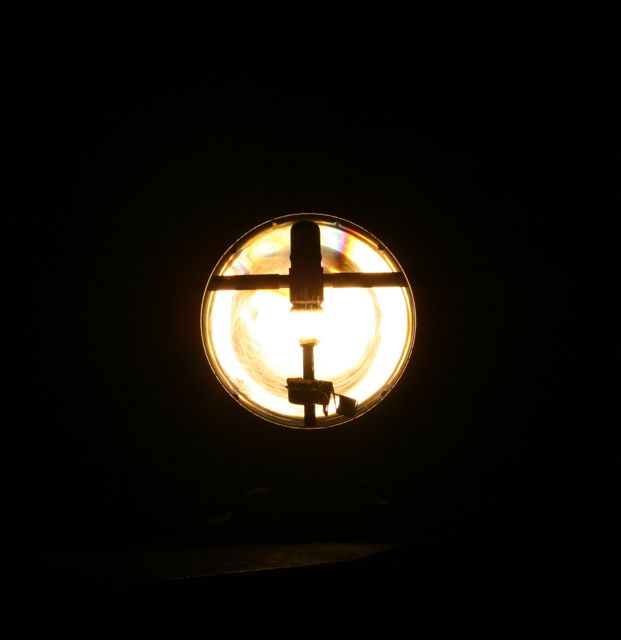

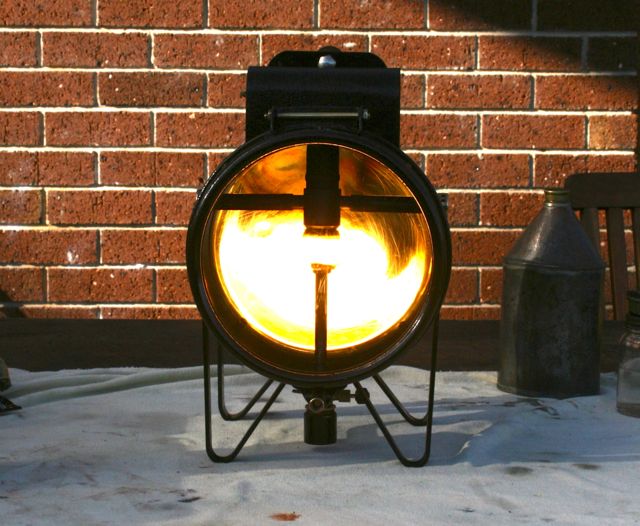

    Here it is alight in the middle of the day:

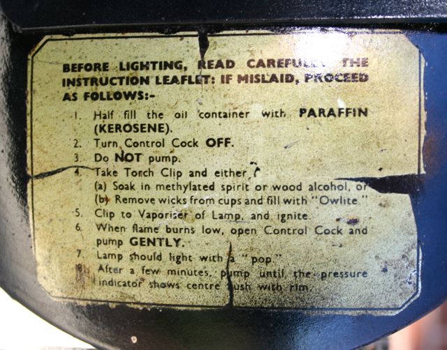

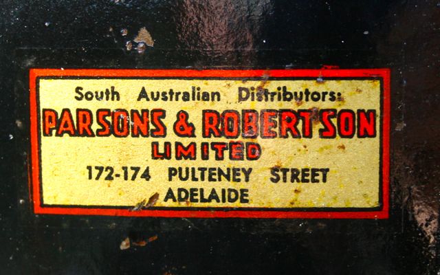

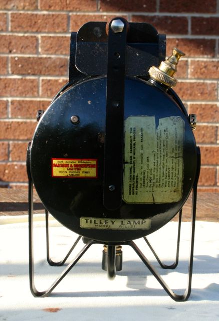

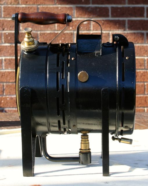

    I kept the back plate as I found it, except for gentle cleaning then protecting with baked clear-coat. The labels are in quite good nick:

    G,,day Tony . i have been outside several times looking for the bright southern light shining in the sky :)
    to no avail :(
    now lets not let a little thing like 200 plus kilometres ruin it for me seeing it :roll: :lol:
    ok i will be serious , looks very nice :thumbup:
    how bright and how far and broad a beam does it throw ???
    hopefully one night i may see it .

    i do like the fact the original labels are still
    there
    cheers
    kerry

    Well fettled Tony! :thumbup:
    11,086
    Some notes on this fettle.
    This was a pretty straightforward fettle, except for the paint job.
    The lamp arrived with fuel in the tank, and hadn't been lit for decades - but it lit up straight away with the old fuel.
    I just cleaned all the burner bits with carburettor cleaner and replaced all of the seals, washers etc with ones from The Fettle Box.
    The AL21 mantle came from The Base Camp.
