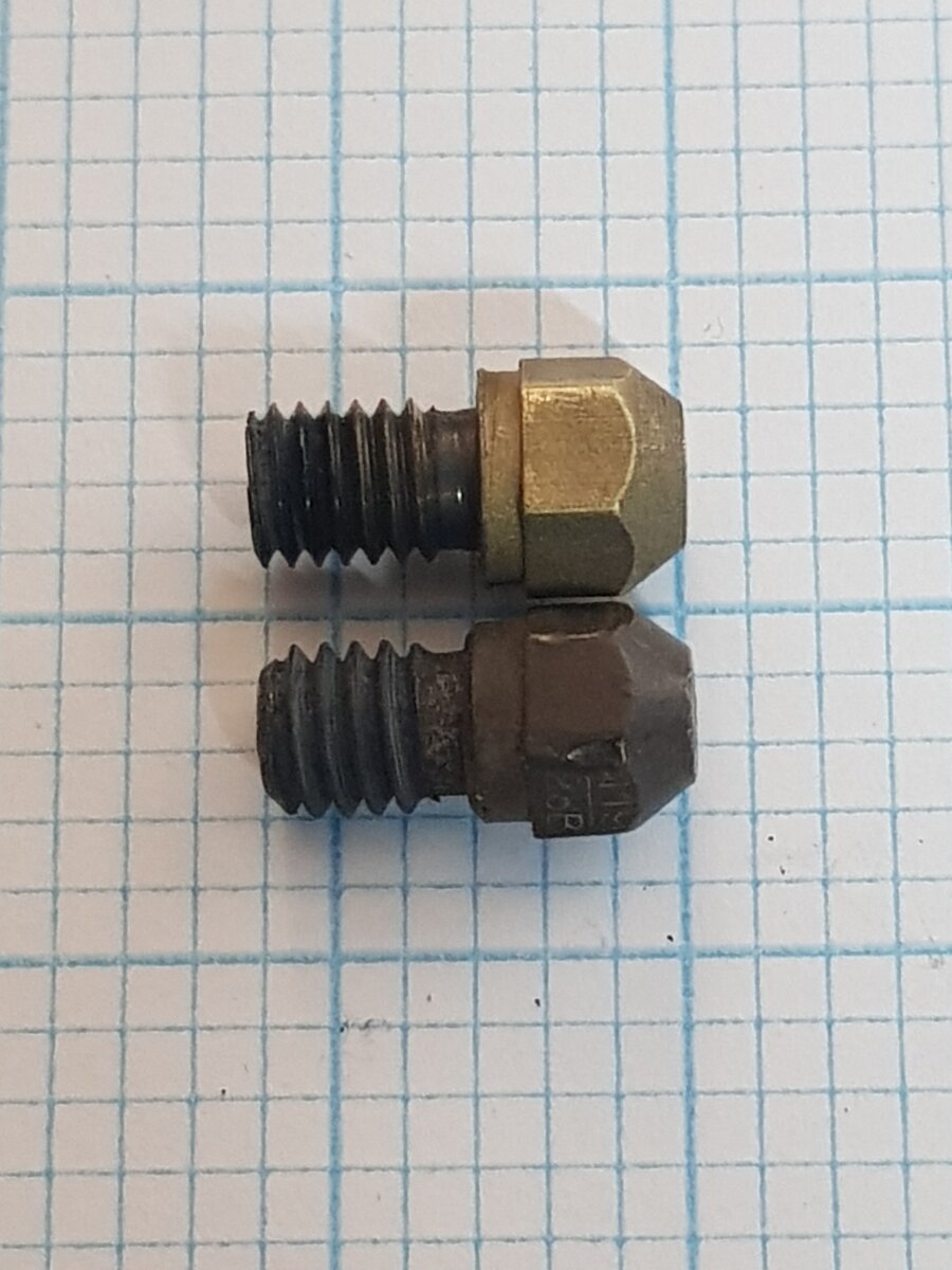

    Below are a number of prickers.
    1. The nipple on the left is a contemporary TW Sands Aladdin 1A part.
    2. The pricker on the left is a Radius 119.
    3. The pricker second from left is the mate for the TW Sands nipple.
    4. The rest of the prickers are Aladdin A1 prickers of various uncertain vintage, with the nipple on the right hand side matches the right hand pricker.

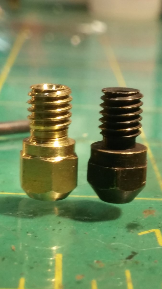

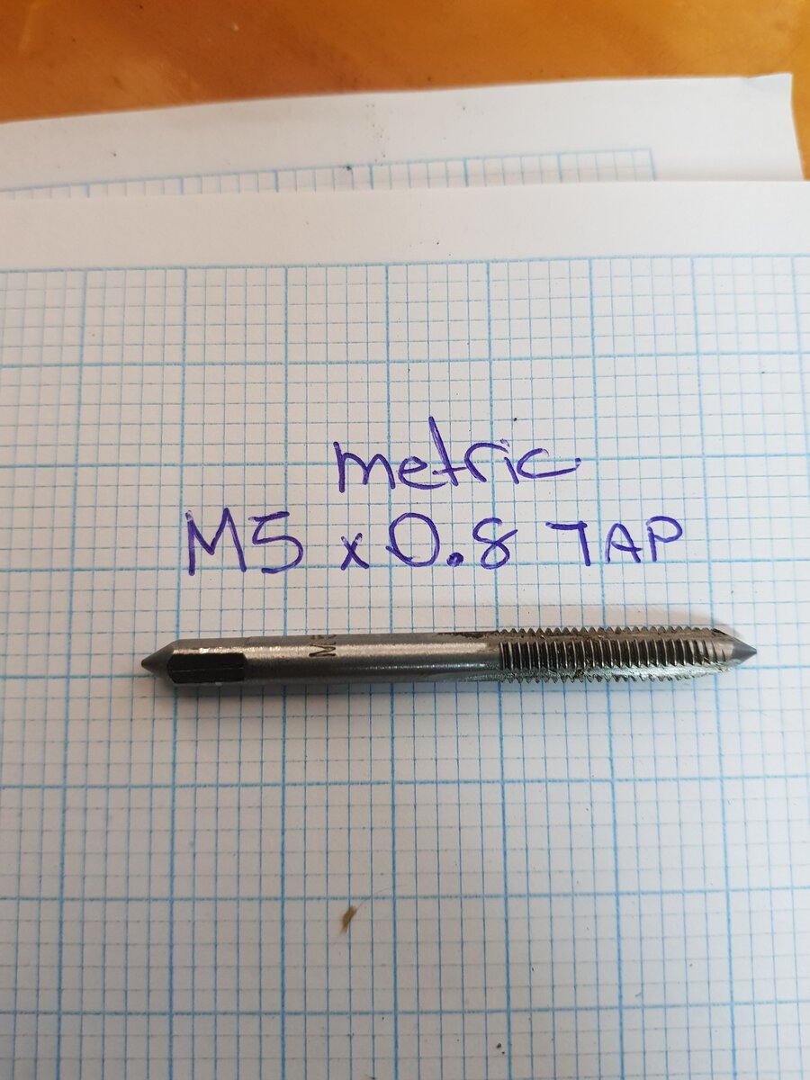

    This is a M5x0.8 metric tap i used to re tap 1A preston loop generator, 20200610_090037.jpg
    The darker jet is radius 119, the lighter is 1A
    The threads are slightly diferent.
