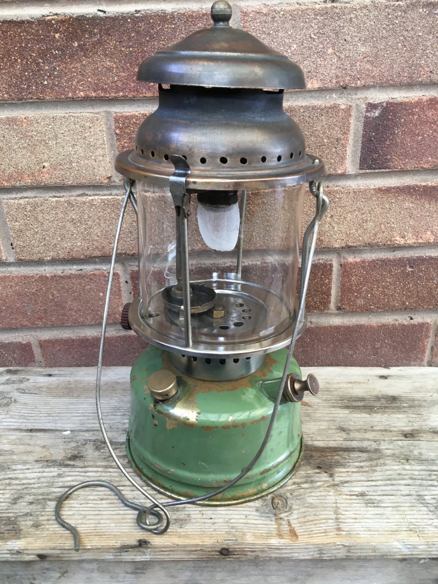

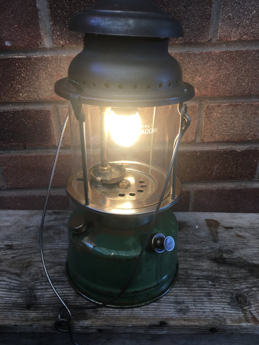

    It's working well!:thumbup:
  3. AussiePete
    3,643
    @Greenboy23
    Well done, she’s running very well.
    These are good reliable lanterns that give years of service.
