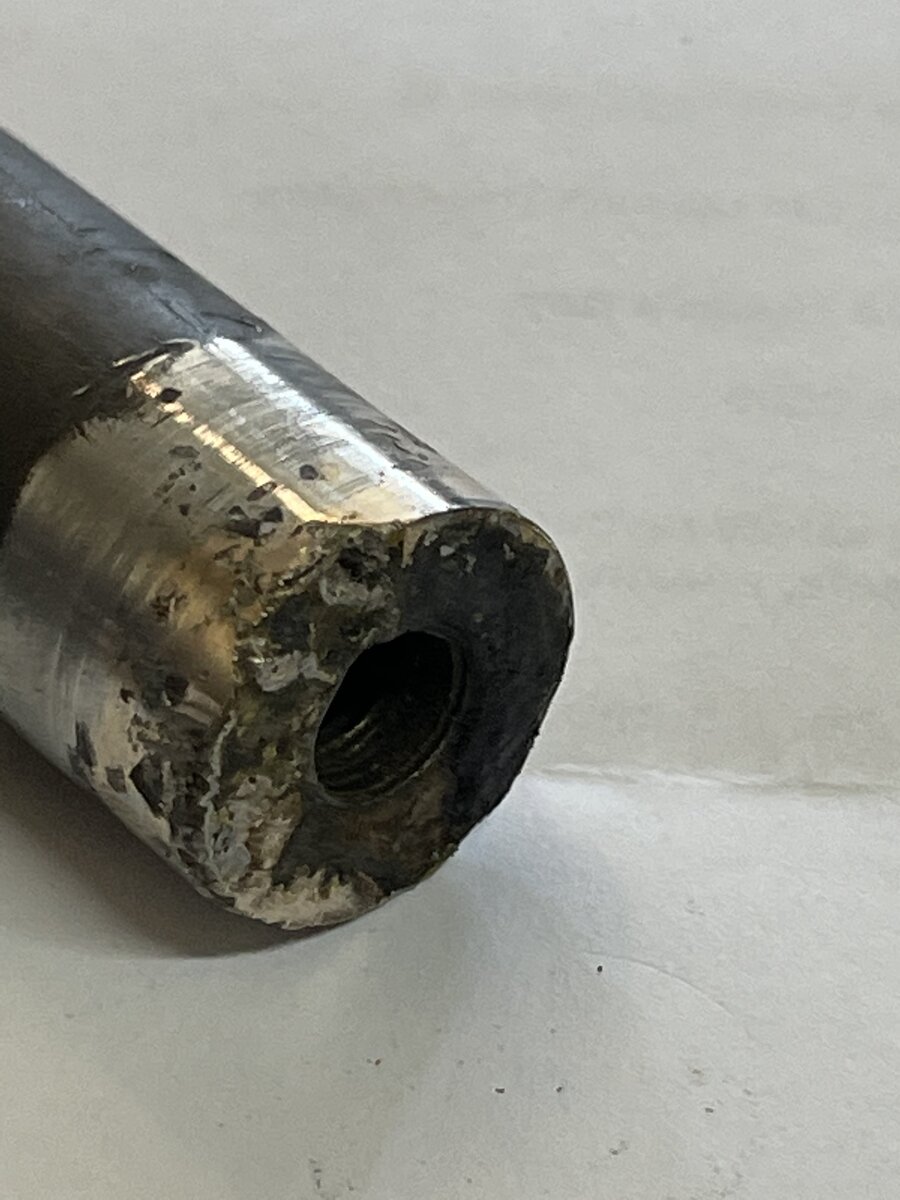

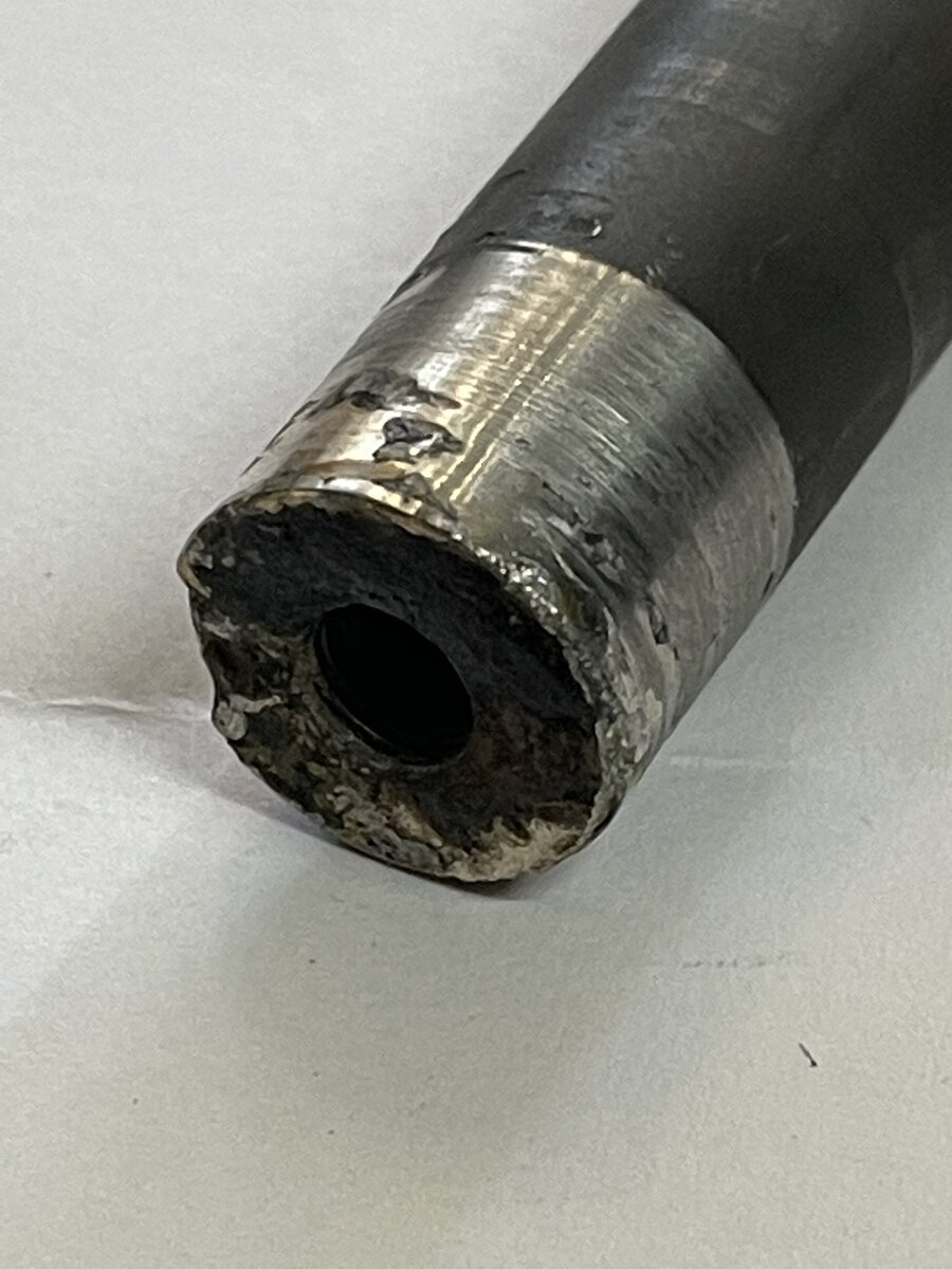

    Hi fellas, this is my days frustrating effort, all I wanted to do was remove the NRV the usual way with my slotted bolt like I’ve done plenty of times but today it would not shift, two broken easy outs #2, I’ve drilled it out bit at a time, #3 easy out still didn’t work, applied the vice and stripped the solder from the NRV end , there is only a mm of NRV left to go and it’s still not moving. Just for the record, here’s a picture of what the NRV looks like from the end of the pump tube, it’s been educational, I haven’t given up

  3. ROBBO55
    2,689
    G'day Darryl, I think it's time to use a tap to remove the old NRV. M8 x 0.75 is close enough to the original thread.

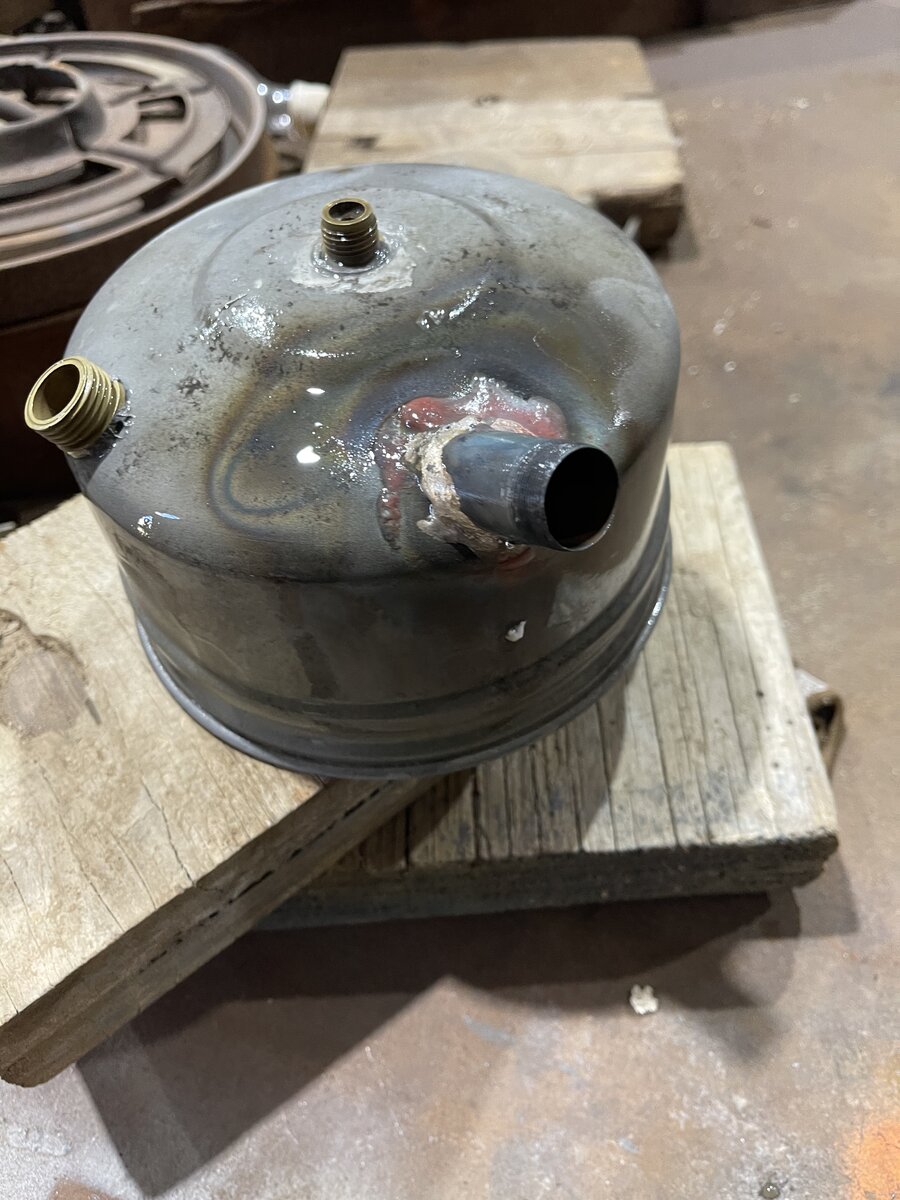

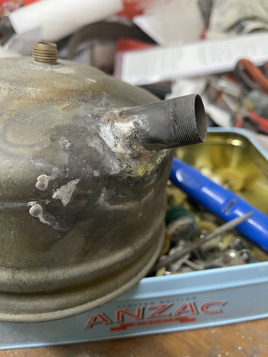

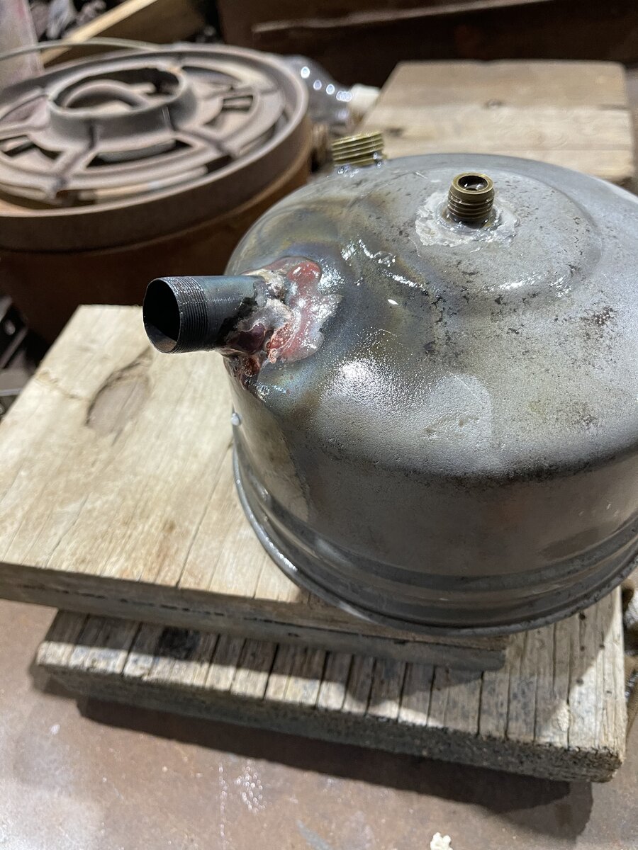

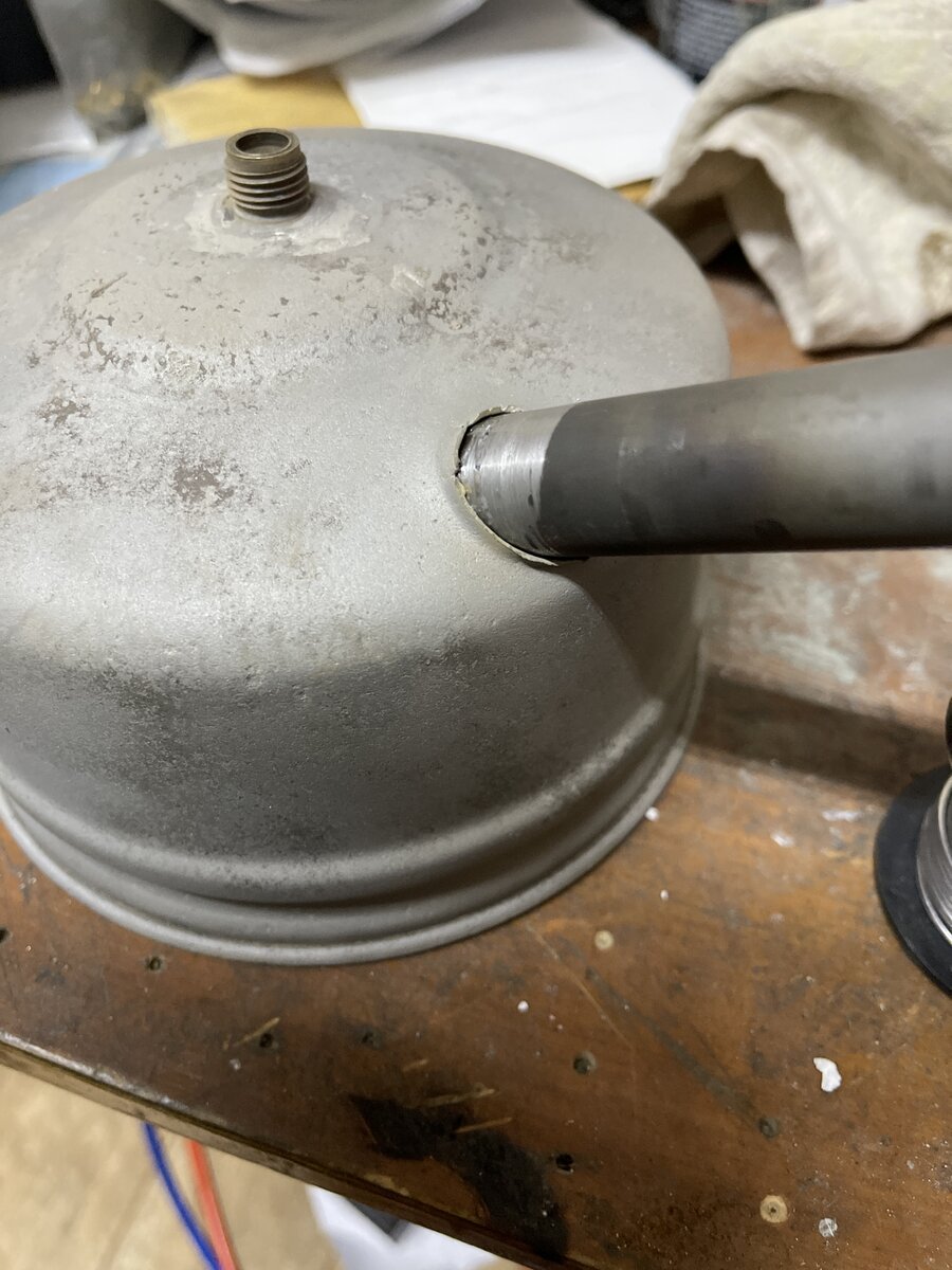

    I have had a fair go at silver soldering, it was a bit messy, but I think I may have done the job, cleaned up the NRV thread, and machined of all the dags so it could fit back in the tank BD5BDBDB-C30A-43DC-BA7A-902EFA618FDE.jpeg 11590BEE-5169-40C7-92E7-91EB90E3A264.jpeg image.jpg

    6424598B-DBF1-4557-B0EA-F3BF25DF58DE.jpeg 7BE9AB17-0C2E-4BE2-ADA7-EFA8B741654C.jpeg My first go at soldering in the tube

  19. Nils Stephenson
    2,891
    What have you used to solder with? It looks like it has had a lot of heat. You only need to use lead solder for the pump tube.
  20. Darryl Durdin
    1,140
    I used silver solder, I could get the lead solder to the job, kept melting, i know it looks a mess but I’ve been cleaning it up to look smoother with my dremell , it will look better when I’m done

  22. Darryl Durdin
    1,140
    image.jpg image.jpg Thank you for mor words of encouragement.
    I’ve been cleaning it up and it’s starting to look good,
    3A36CEC3-7DE9-483C-B62A-97DF4D25088E.jpeg 0DC85E48-FE25-4B7C-9922-BE531CCDDEC2.jpeg

    That'll clean up ok and once it is, she'll be good as new!

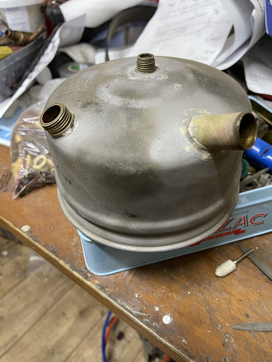

    Hi fellas I’ve made a cap so I can pressure test my tank, I’m a bit excited as to if my repairs really worked, fingers crossed 17E38411-E91A-4230-941A-D41495019985.jpeg
  26. Darryl Durdin
    1,140
    Hi fellas, well it went alright, no leaks on the tank tube part, but the NRV still had issues, either the thread part was still a bit egg shaped and the threads didn’t mesh properly or I had not soldered the end piece in good enough, it leaked air bad.
    So I got a donned tube from a stressed cracked A1 and soldered that in, problems solved, it passes the pressure test,
    I’m quite pleased with my fettle skills I’ve learnt it’s been educational C55A94B7-FA14-4F8A-9A3D-098866A8B428.jpeg

    The second effort is much neater. :thumbup::thumbup::thumbup:
