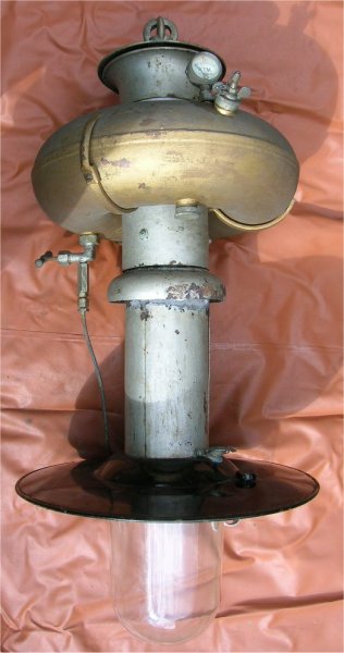

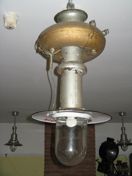

    Thanks to Mick Emm for allowing me to share this wonderful Aladdin Donut.
    They stopped making this Donut in 1917 and despite the globe being incorrect it is still a stunning lamp. I believe the correct globe has been fitted since these photos were taken.
    It is on display along with some of Micks' other lamps at Bolton Abbey Railway Museum.
    The, for safety reasons, required electric hanging lamps blend it well with the pressure lamps.
    I suspect I'll never own a lamp such as this but I'd dearly like to.

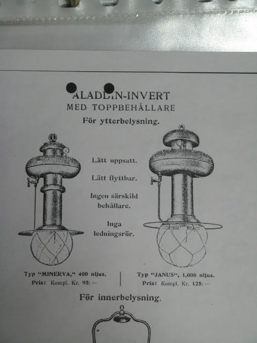

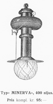

  2. Carlsson
    3,685
    I think it's an Aladdin Minerva.
    Aladdin may have been producing lamps up til 1917, but after 1913 they was fully owned by AB Lux after a lost patent feud.
    The production continued under the name Aladdin.

  8. Matty
    Mar 22, 2015
    2,587
    Queensland, Australia
    Thanks all, a really interesting read that helps one understand whom was tied in with whom - or not.
    It can be awfully confusing trying to figure out what company made what.
  9. Tonebone
    Apr 17, 2012
    123
    Simply stunning, must look amazing with its original globe
  10. Matty
    Mar 22, 2015
    2,587
    More info along the lines of Christers'
  11. Mick Emm
    Mick Emm Founder Member
    Sep 23, 2010
    335
    Hi !
    I find it surprising the lamps are so old !!
    MINERVA and JANUS ??
    Maybe someone from Sweden knows what or why these names were given to the lamps , do they mean something in your past history ??
    mick
  12. Mick Emm
    Sep 23, 2010
    335
    Hi Tonebone .
    Yes it looks better with a pointed teardrop shaped glass but I kind of got use to seeing the wrong glass on the lamp !
    The stuffed Squirrel glass dome upside down was a very neat fit around rim but just too long in the body !!
    mick
  13. Matty
    Mar 22, 2015
    2,587
    I suppose it does look a bit long but I could live with it. I'm not sure you would know it was wrong if you had never previously seen the lamp with the proper globe.

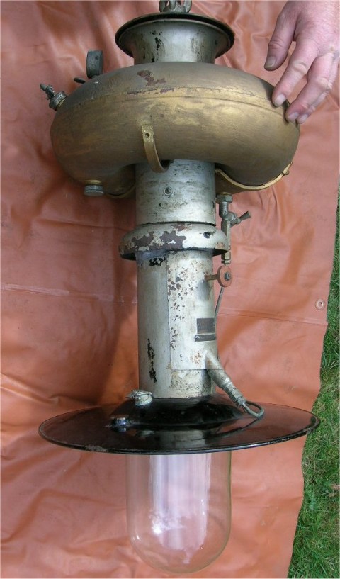

  14. pete sav
    pete sav Founder Member
    Sep 7, 2010
    821
    Hi Matt and mick
    few more pictures here of your lamp mick we took in the garden that time
    1437565446-Dscn1248s.jpg 1437565459-Dscn1250.jpg 1437565468-Dscn1254.jpg 1437565479-Dscn1256.jpg 1437565489-Dscn1258s.jpg
    cheers pete

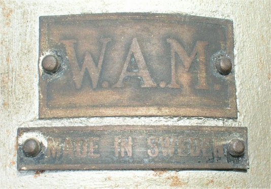

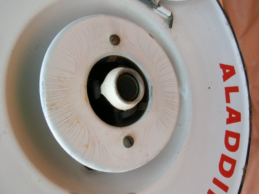

  15. Matty
    Mar 22, 2015
    2,587
    What you said Mick and also some nice close ups of the W.A.M brass plate and ATM on the fuel gauge that Pete took. I'd be interested to know what the initials stand for.
    These types of lamps look like a lot of engineering would have gone into them to bring them to life.
  16. Carlsson
    3,685
    I think they just are taken as suitable names.
    Ancient Greek and Roman figures and gods has often been used to name all kind of stuff all over Europe.
    Tug boats, tools, lamps... you name it.
    One little observation I can make, is that the lamps with their own tank use Roman gods for their names while the hollow wire lamps seems more named after Greek mythology. Except for those who just use a telegram code.
    W.A.M doesn't make sense.
    Can it be the British retailer?
  17. Jean J
    2,145
    Would it not just stand for Wonderful Aladdin Manufacturing?!

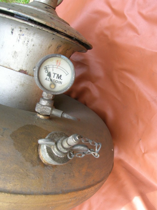

  19. Digout
    Digout Australia Subscriber
    Feb 20, 2013
    480
    ATM. = Atmospheres????
  20. Carlsson
    3,685
    Yes, ATM. is for atmospheres. That was the common unit here those days.
    It says so on all Swedish lamp tank gauges I have from that era.
  21. Matty
    Mar 22, 2015
    2,587
    Well done!
    Thanks to Christer for the follow up explanation.
  22. David Shouksmith
    8,113
    Ah, you were asking about the initials (as opposed to the abbreviation) but yes, ATM is 'Atmospheres'
    1 Atmosphere is the same as 1 Bar (1000 millibars) or about 14.7 pounds per square inch (on a good day - literally). So working pressure for this lamp is 22P.S.I. / psi.
    Lamps and lanterns generally work on 2Atm. or about 29-30psi...
  23. Carlsson
    3,685
    Ah, I missed that the meaning of Atm. was asked about. Not trying to be impertinent, but I actually thought everyone knew that. Especially when written on a pressure gauge.
    Like David, I thought it only was the W.A.M. meaning you asked about.
    That is still a mystery. Not any possible British retailer or importer anyone can think of?
    Regarding the pressure; These old, large lamps with this burner type were generally working at a lower pressure.
    1.2-1.5 Atm. was common.
    But they recommended to increase to almost 2Atm. for the hollow wire lamps if the difference in height became excessive between tank and lamp.
  24. Matty
    Mar 22, 2015
    2,587
    Initially, upon reading the above, I wondered how you could ascertain that.
    I then went and checked the photo and noticed it had a red 1 1/2 mark above the gauge lines.
    So, the red 1 1/2 indicates what pressure the lamp should be run at and the black indicator lines is what pressure you are actually at?
  25. David Shouksmith
    8,113
  26. Matty
    Mar 22, 2015
    2,587
    Thanks.
    Not previously having much to do with pressure vessels of any description, no, I didn't know what ATM meant.
    I have a compressor with two gauges on it and neither has ATM written on it. I have a tyre pressure gauge that looks similar to the ones on the compressor and it doesn't have ATM written on it.

  28. Carlsson
    3,685
    Not really any gods associated with light up here.
    Balder to some extent. Or Skirner, maybe, since the name means something like "the shiny".
    And Tor (Thor) throws fire and flashes, so a vague association to light there too...
    In reality I think it's quite pragmatic. I assume they thought name from ancient Greece and Rome were better since most lamps were supposed to go to other countries.
    Strange name with letters containing dots and rings above them wasn't perhaps the best then, but everyone knows the ancient mediterranean gods and goddesses.
    Minerva is a bit off, but the other two lamps with Roman association are connected to light in one way or another.
    The sibling to your Minerva, Janus, was the god who controlled the light from heaven and the little lamp called Vesta also has a well chosen name. Vesta was the godess of the fire and hearth in every household, which is suitable for a little lamp meant for domestic use.
