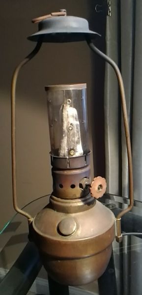

    Anyone know who made this? About what year? What type of mantle does it take?
    I don't know much about alcohol lamps. Only have this one and a Tito Landi. I have made mantles to at least run them but it would be nice to have the correct mantles that belong on them.

    That could be a small german "Geniol 750" alchohol mantle lamp. It was made up to the 1970's. You can find some information about it on the Hytta page (in german language only). I think there are no spares or mantles to obtain any more.

    Yes, it is a alcohol mantle light, also sold as "Geniol 750", most likely made by Meyer & Niss for Heinze.
    Mantles are not available any more, I met a collector who had a few but these went away. So you need to make your own mantles for these lamp.
    They work very well and give a nice and light.
    Where did you find these? So far I did not think the US were the place to look for such lamps.

    Does anyone have a picture of what the mantle should look like?

    The mantle should almost look like what you have on your photo.
    The original mantles are blown into shape and hardened with a special kind of gas burner, but that's very difficult and I don't know anybody who could do this in a professional way nowadays.
