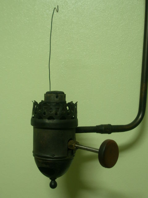

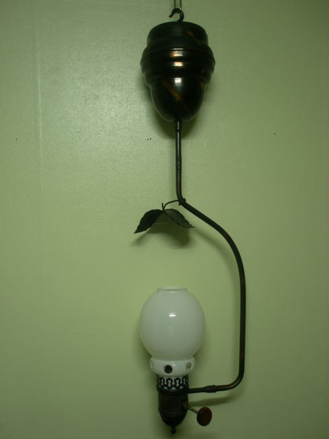

    Hi CPL friends.

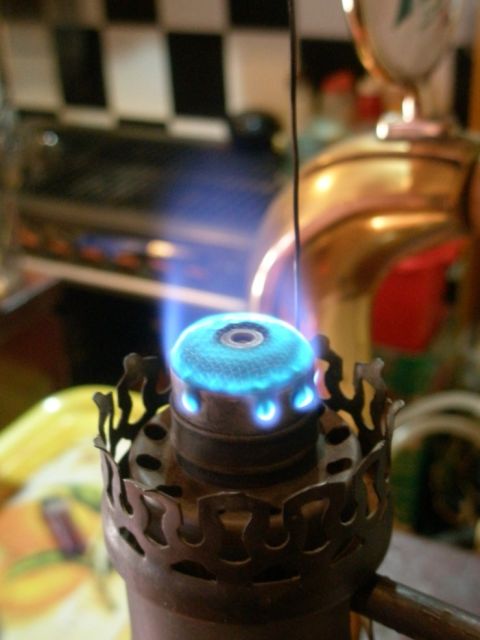

    This is my hanging lamp.
    The superior manufacturing co. usa
    fuel use gasoline. i have not up-light mantle.

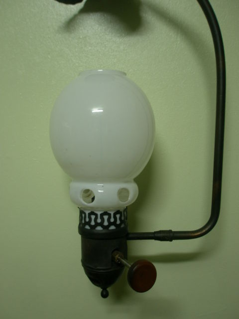

    Unusual style frost globe. it has got six air hole. flame is 100cp .
    thanks.
    Gunsoo

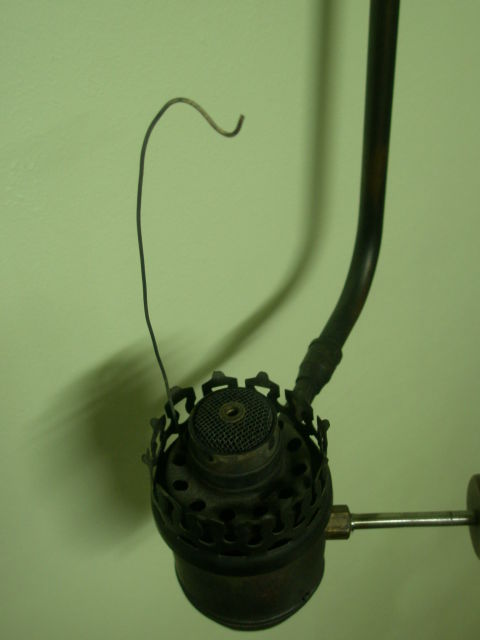

    Very interesting lamp. I wonder if the hole in the middle of the flame spreader is for a Tito Landi style mantle holder?

    It does look like it takes a mantle rod like the ones for the upright gas mantles...

    No, it is not. It is to reduce the flame surface just to the border and it is not a hole but a rivet to hold a bigger piece under the net.

    Thanks for the explanation. It is always good to learn something new. Sounds like a sensible idea as well. The mantle is around the edge, so that's where you need the flame.

    Nice and complete lamp. I have got a couple of these gravity fed lamps but I had to restore botth with some non original parts to bring them to a condition that just seems original; the second one works but it is still waiting for restoration.
    You can look for more information on these lamps on www.lampguild.org

    i use asbestos fork style for made flame.
    and i can't find another style mantle hanging part old cataloque.

    You only need a new upright mantle as the rest of the lamp seems to be ok. Look for it on ebay: there are many there, as this one! mantle for sale Ask the seller to check if the diameter on the base fits on your burner and that´s all. Juan.
    PS. for sure you considered this: it is a gasoline lamp which tank is above the flame so check very carefully for leakages and light it on the outside.
