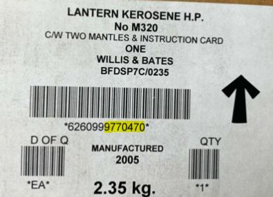

  10. rayw
    Sep 13, 2020
    106
    It was silver originally, but poor quality paint, I left the bottom for reference.
    Would this be September 1977?
  11. Alex Smith
    Jun 18, 2019
    925
    Central, UK
    The set of numbers visible on the base of this one are not a date stamp, but the back half of the NATO Stock Number (NSN) for a UK MOD Vapalux. The full NSN for the lantern is 6260-99-977-0470, the last 7 digits being stamped on the base of the fount.
