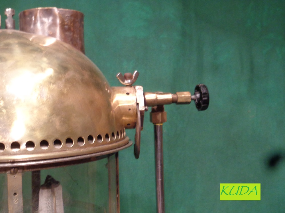

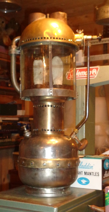

    Hi-- New here-- my Last hope-- I have been trying to identify this burner head for 15 years-- no luck ~~ some suggestions were a Nautical signal lamp, I got the head and had no idea what it was-- finally a few months I figured it was vapor pressure arc lamp/lantern~~~~~ I just had the head so I fabricated a font out of a couple orphan quick lites-- got some mica for the shade--- and use the generator off a Coleman 425 stove. I have had it fired and it burns very nicely ( torch light ) I used Aladdin mantles first try but they allowed a lot of gassing off at the top so I am trying some larger mantles I just got---- any help identifying this would be greatly appreciated ~~~ I have nick named it my Jules Vern 20,00leagues under the sea lantern
    Bruce in Wisconsin at Camp Wounded Dog

    Interesting! Could you post a few close-up pictures of the burners and working parts with the covers off?

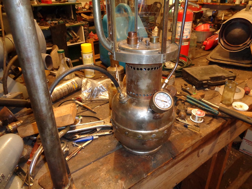

    thank you-- I am currently doing some modifications-- I removed the old pump pressurizer and installed an "Amish" nipple so I can pressurize with a bicycle pump-- and I added a vintage pressure gauge. the old pump had a slow back pressure leak I could not resolve-- tried all kinds of gaskets to no avail-- I gave up-- I frequently use the Amish nipple-- makes life so much easier~~

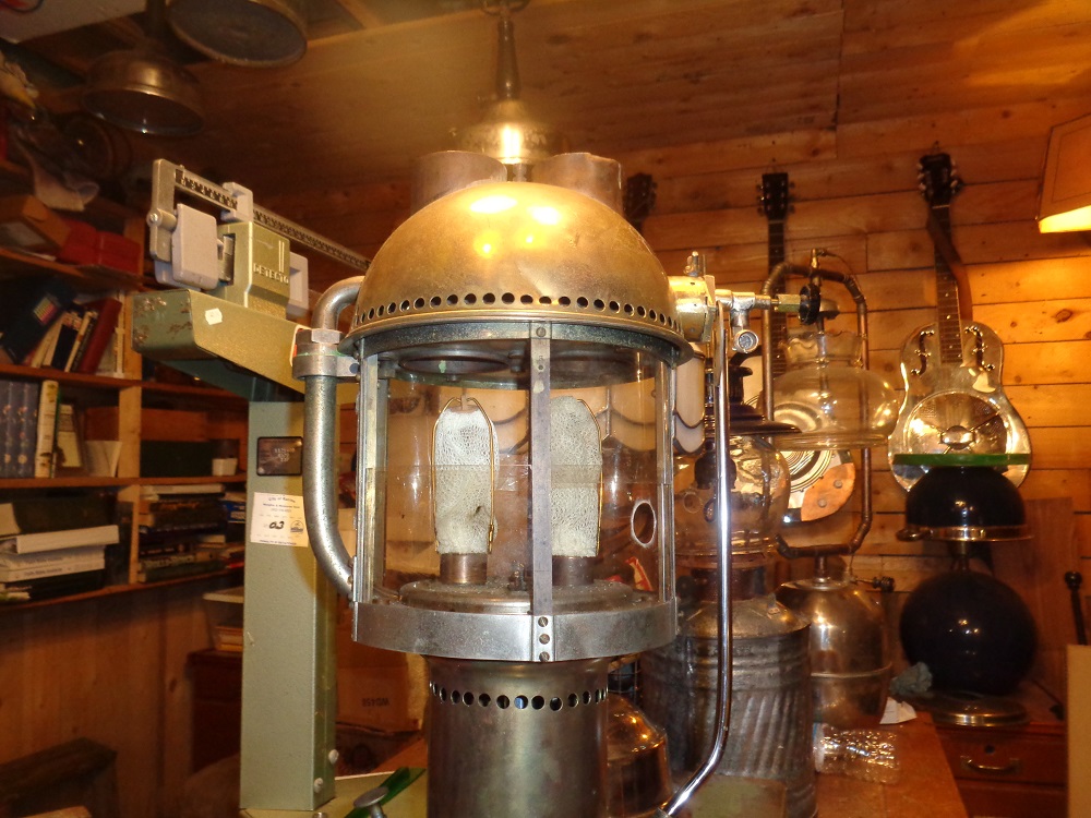

    I'm still tryinngto find out what my mystery lantern is--- I came across a picture of a Kitson Cluster Burner~~~~ mine looks very much like it--- can any one confirm or refute for me>> thanks in advance

    okay- one last try to identify this burner head I've been trying to get a positive ID on it for almost 15 years-- got it burning last year-- one fellow in England said it looks like a Kitson IOV cluster burner-- Kitson holds the original patent for vapor lamps-- around 1890 - this pre dates Coleman, If any one can ID this please let me know

    I can’t identify it, couldn’t even guess ..... but that’s some serious stuff. Looks like it come off of Jules Verne’s Nautilus.

    I strongly believe it to be a lamp, using pressurized liquid fuel to produce light :whistle:
    A very nice example made by ?????????? with a look of early proof of concept. I like the shape and look of your lamp, although seems strange to have the vapouriser go through the hood where all the heat is, then have the mixing tube go outside and down to cool on the way :-k
    More details may come to light :D Is it time to light and let it shine?
